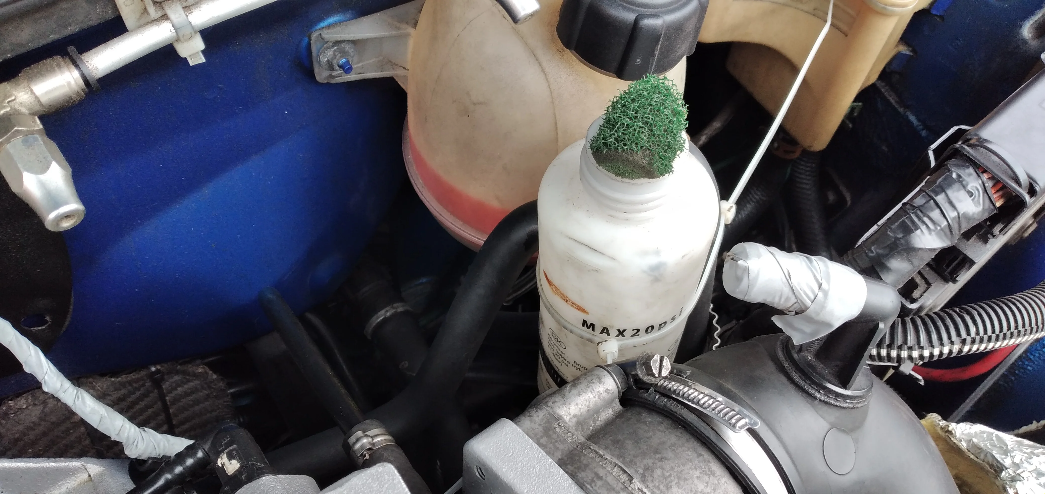

I made a makeshift catch tank, photo below, don't laugh! And I also taped the dipstick to the tube, as a number of other racers said they clamp the dipstick in for racing.
Anyway I did the two races and everything seemed fine. Dipstick stayed in, nothing else blew off, and there was hardly any oil evident in the 'catchbottle'
