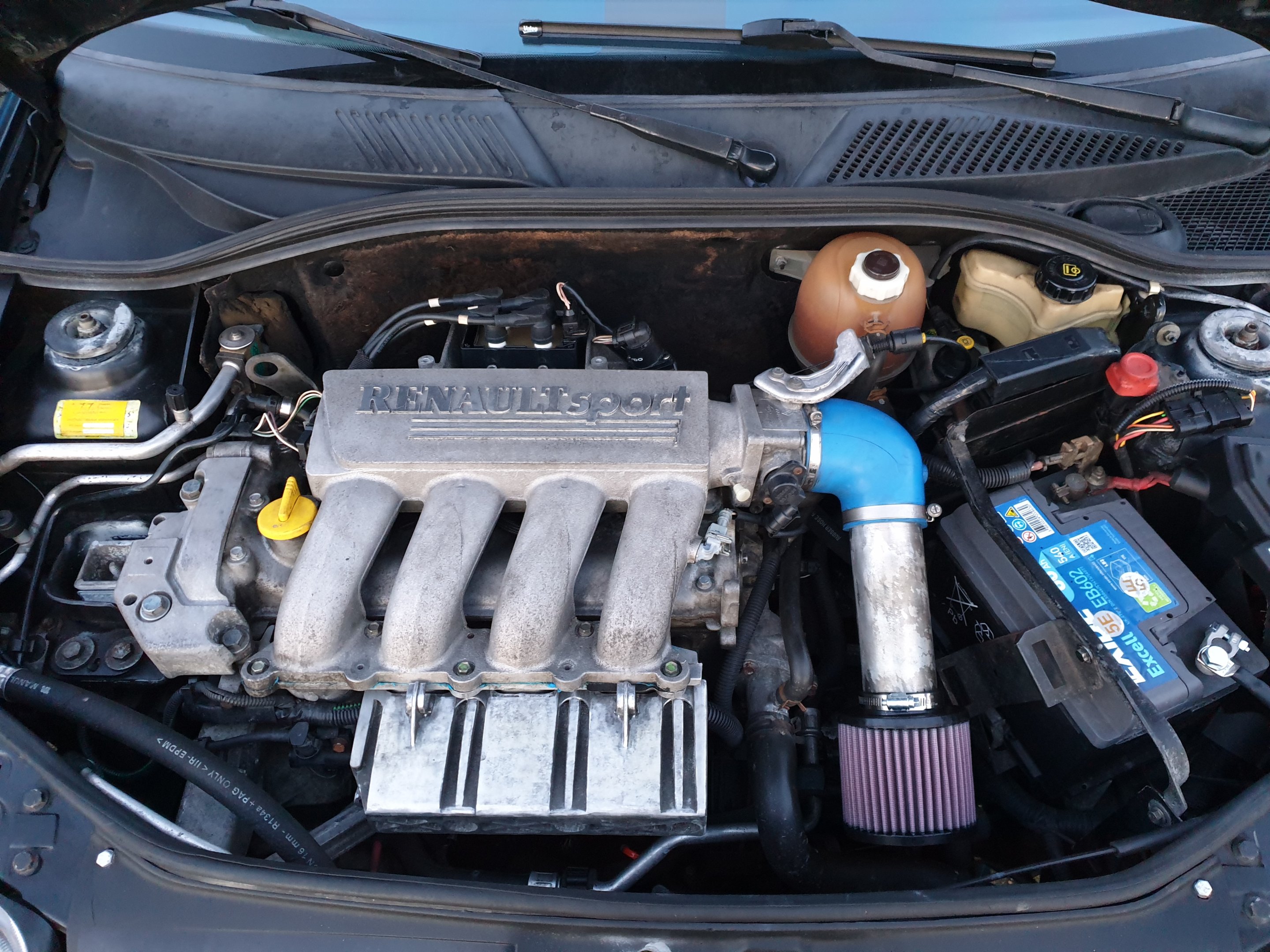

Hi all! recently bought a clio 2 ph1 2.0 16v with some 120K miles on it. car seemed to be running fine at first but has been a pain in the butt ever since.
I have been reading through the forums quite a bit and I'm not a complete novice when it comes to cars, but I must admit that I could really use some help diagnosing the intermittent power loss I've been experiencing! I'm a bitt at a loss!
What are the symptoms:
car starts every time without trouble.
after a few seconds idle gets a bit rough but if I give it some gas it will idle fine for a couple of minutes on end.
when driving I have plenty of acceleration power pulling through the gears without trouble.
when I drive around in higher gears around 1500 rpms the car seems to stutter ever so slightly
when I floor it the car accelarates fine until it hits a wall somewhere between 3500-4500 rpm. It's like the power is suddenly gone. The car will maintain it's speed but will not accelerate any further. in some cases this even prevents me overtaking other cars as I suddenly loose the power to accelerate.
sometimes after a while the power comes back and the car starts accelerating again, sometimes it doesnt. the rpm's at which the power loss shows up are not solid but generally only at higher rpm's.

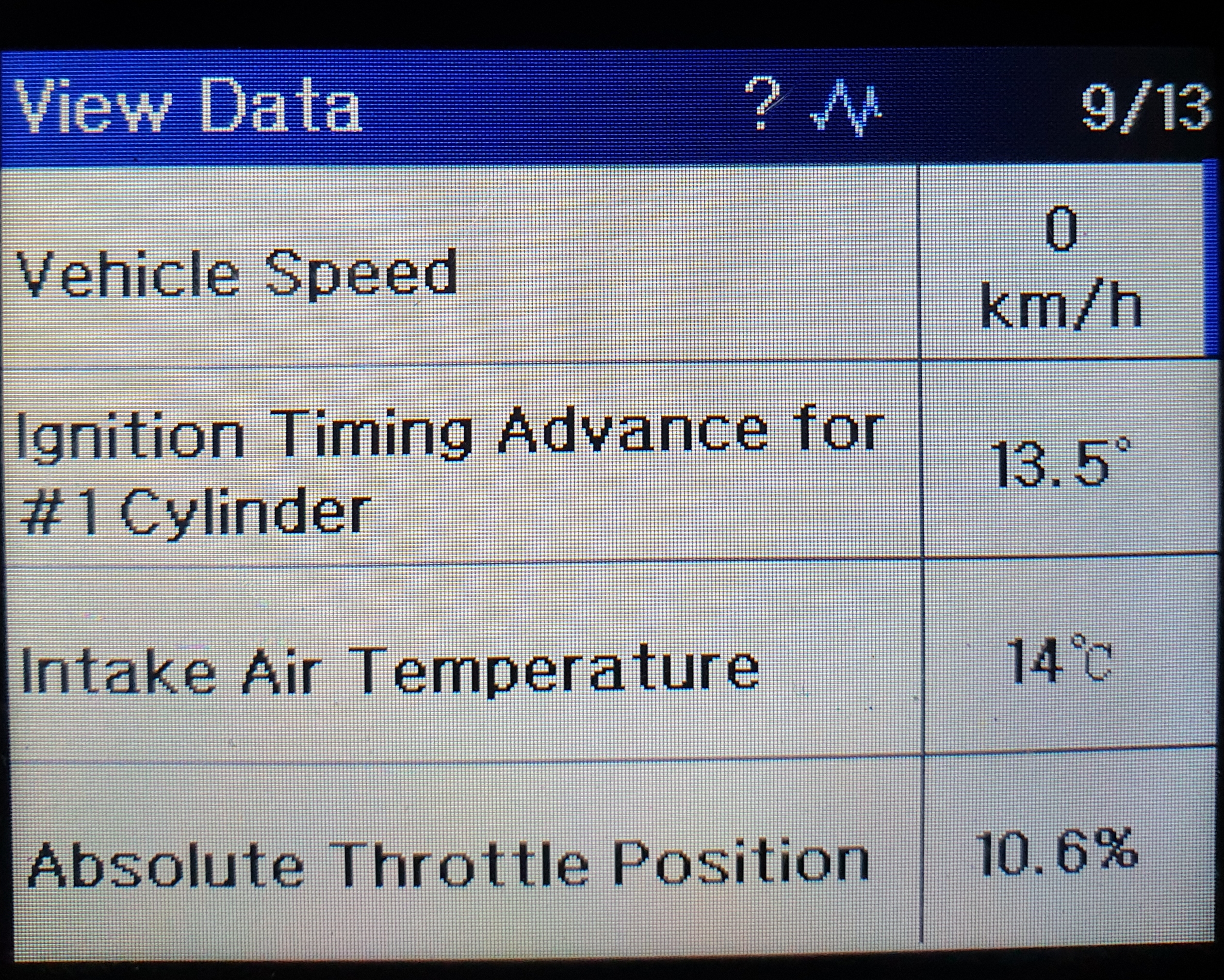

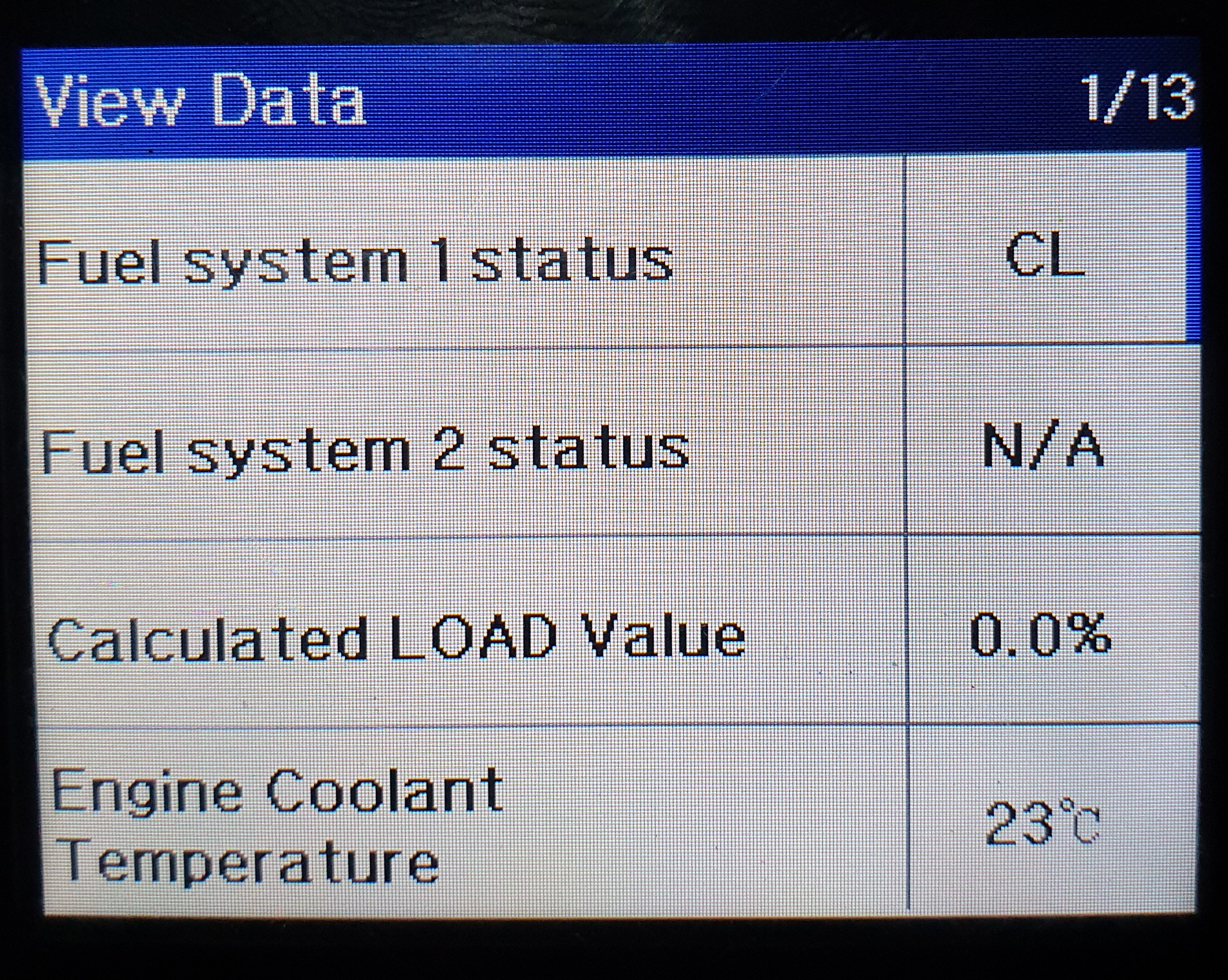

hooked up my icarsoft computer:
- coolant temp = steady
- map sensor is within range
- throtlle position ranges between 10.2 - 88.9 and increases fluently
- engine load seems to vary between 0 and 100%

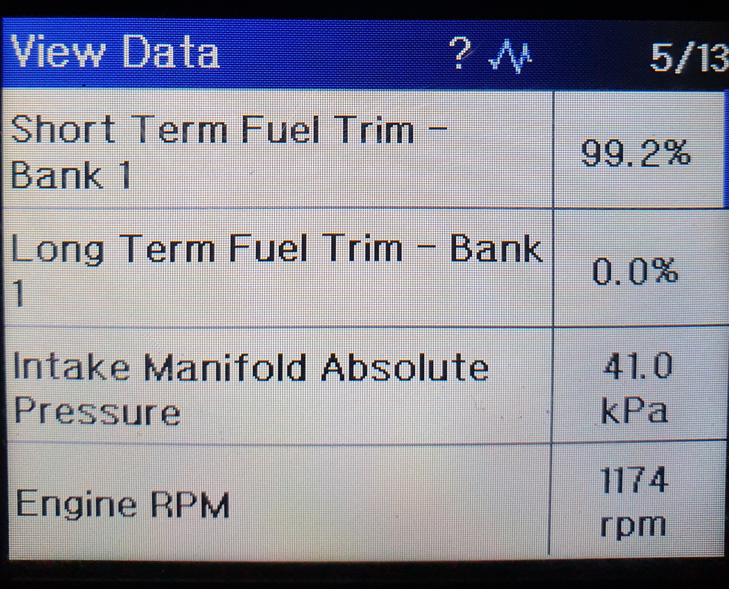

- fuel trim seems a bit strange but I am pretty confident that my computer is displaying the wrong sensor values here.. ltft = 0.0% stft = 99,2% all the time until I release the gas..
disconnecting bot the front and rear lambda sensor does not change these values. neither does it give me a check engine light or anything.
- ignition advance is all over the place but doesn't project strange values when the issue pops up.

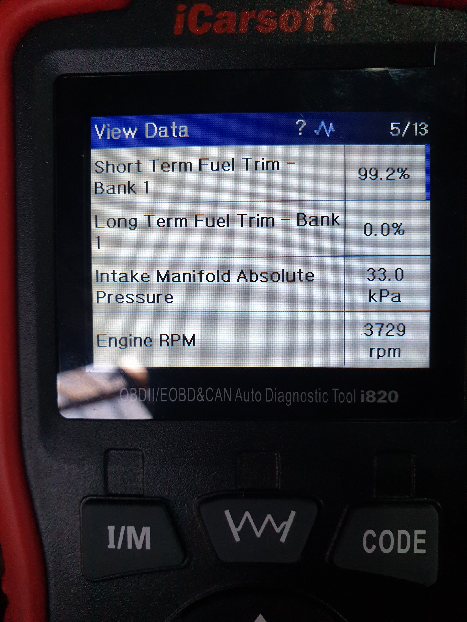

My MAP sensor is showing around 440mbar at idle and decreasing with acceleration as suspected.
Reason I don't have the pre-cat as a main suspect is because the lower loss happens at higher rpms, basically in a WOT situation. In a WOT situation the ECU goes into open loop therefore disregarding the O2 sensor alltogether...
Also when disconnecting the O2 sensor in the shop there is no change in STFT (which is why I suspect my diagnostic device is not showing me the right sensor reading)
I tested my injectors by first listening to them with a stethoscope. They open at regular intervals, not skipping.
Then removed them from the fuel rail and set up a little test rig. I am able to power them while blowing carb cleaner through them. This has shown me they open without hesitation and the spray pattern and volume is identical and what would be expected.

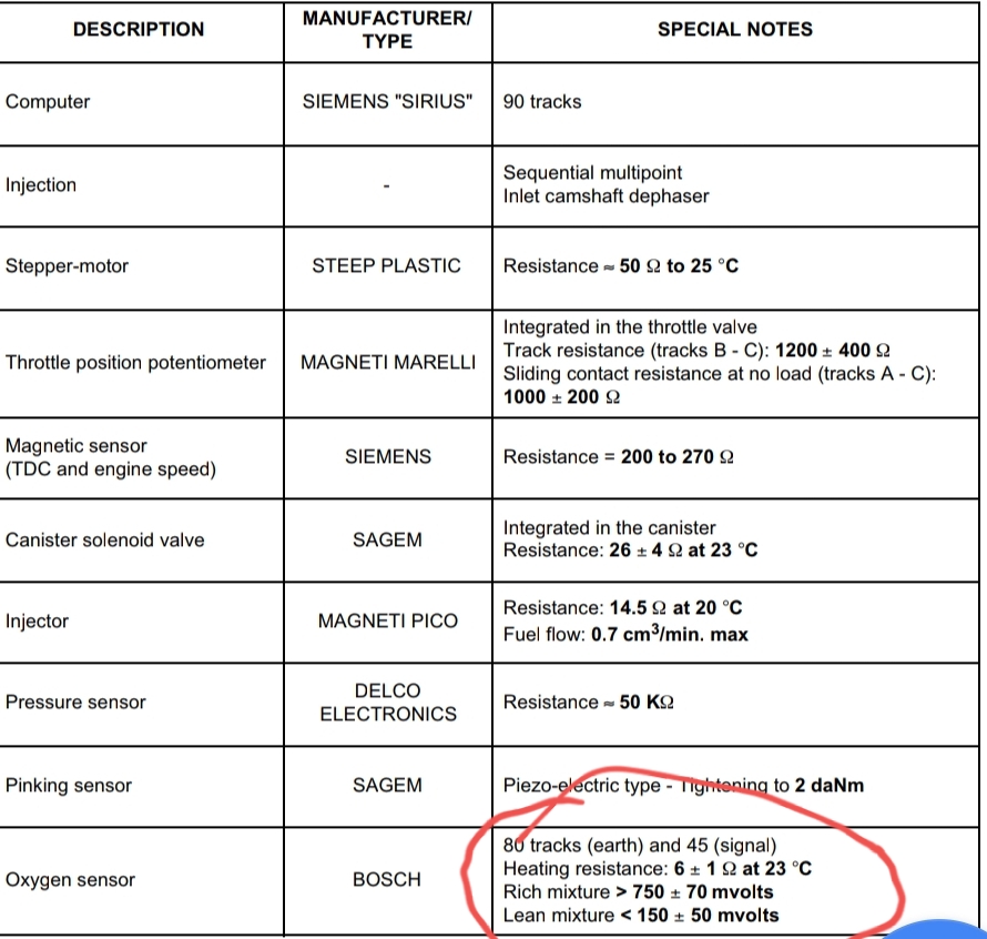

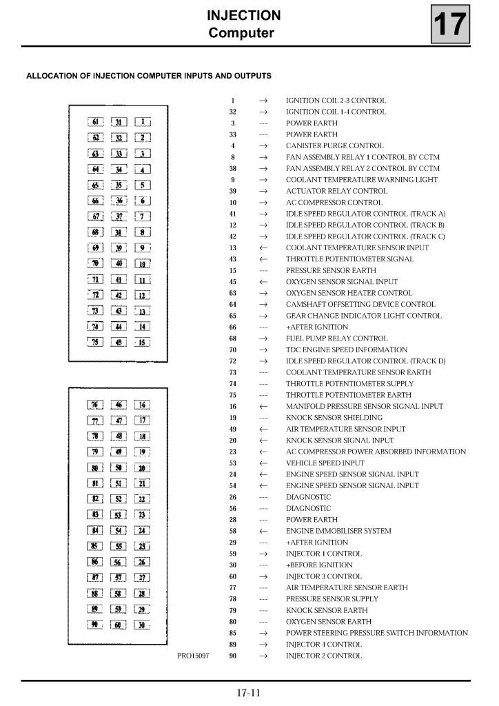

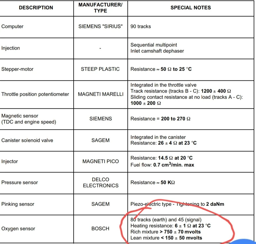

One of the things I also found odd is that I am able to find the connections for the pre-cat o2 sensor on the ecu in the connector list: O2 sensor earth on pin 80 and O2 sensor signal on 45. (See attached image) but I don't see the connections for the post cat O2 sensor? Maybe someone can shed a light on that?

If however the O2 sensor is faulty and is reporting a "lean condition" the ECU would be injecting more fuel in order to get to a perfect 14.7:1 ratio. In Idle the ECU will then keep on injecting the extra fuel based on the O2 sensor input but will also close up the IAC valve more in order to get rpms down, thus increasing vacuum. Make sense?

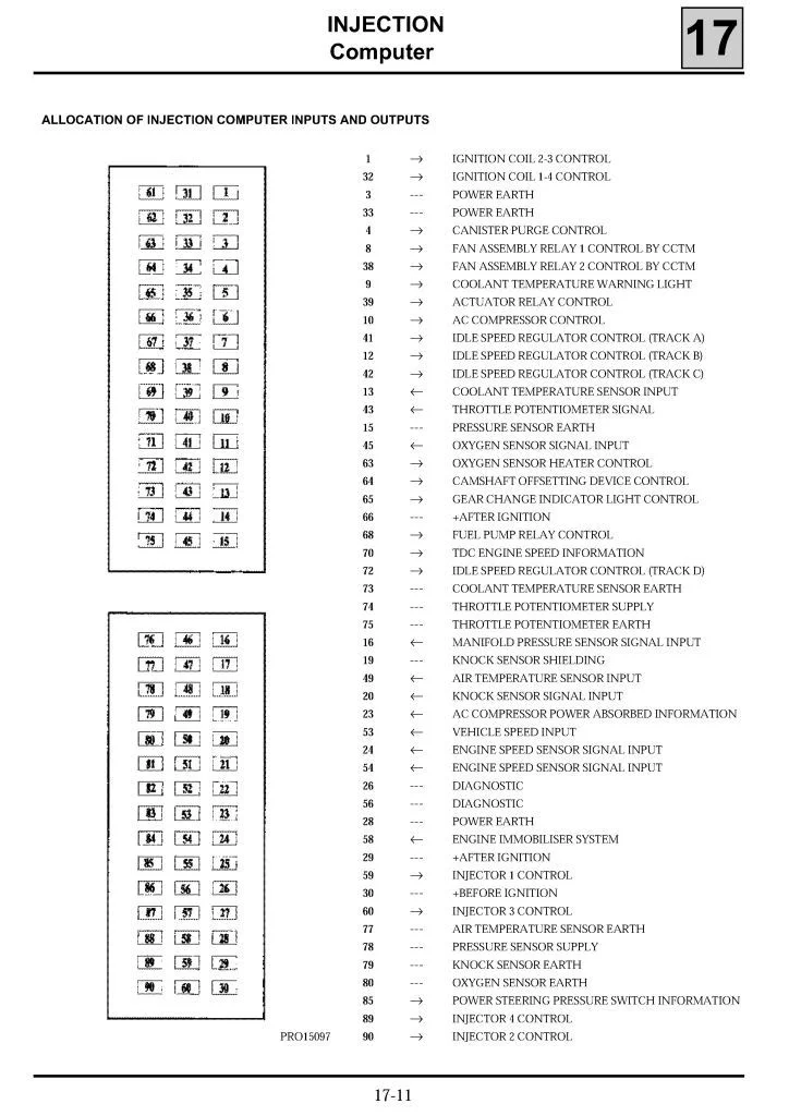

It`s pin 44 on a Ph2,
I don`t know if Ph1 is the same, but 45 is the same pre cat signal.
80 may only be the pre cat earth, and 68 the post cat earth.
That's pretty odd for them to re-arrange pins between ph1 and ph2 seeing that they're both running on the same siemens sirius 32N ECU with almost identical engines?
This would mean however that if there has been an ECU swap in the past (which there has been due to the all familiair immobilizer trouble) but the person just swapped the ph1 for a ph2 ECU, that the engine would run but would be looking for the O2 sensor input on the wrong pin causing the car to run weird...
A bit far fetched maybe and I have no means of actually reading the ECU to see what software it is running on.. but an interesting theory nonetheless.. maybe I'll try and see if I can "borrow" a ph1 ECU known to be good to eliminate this possibility

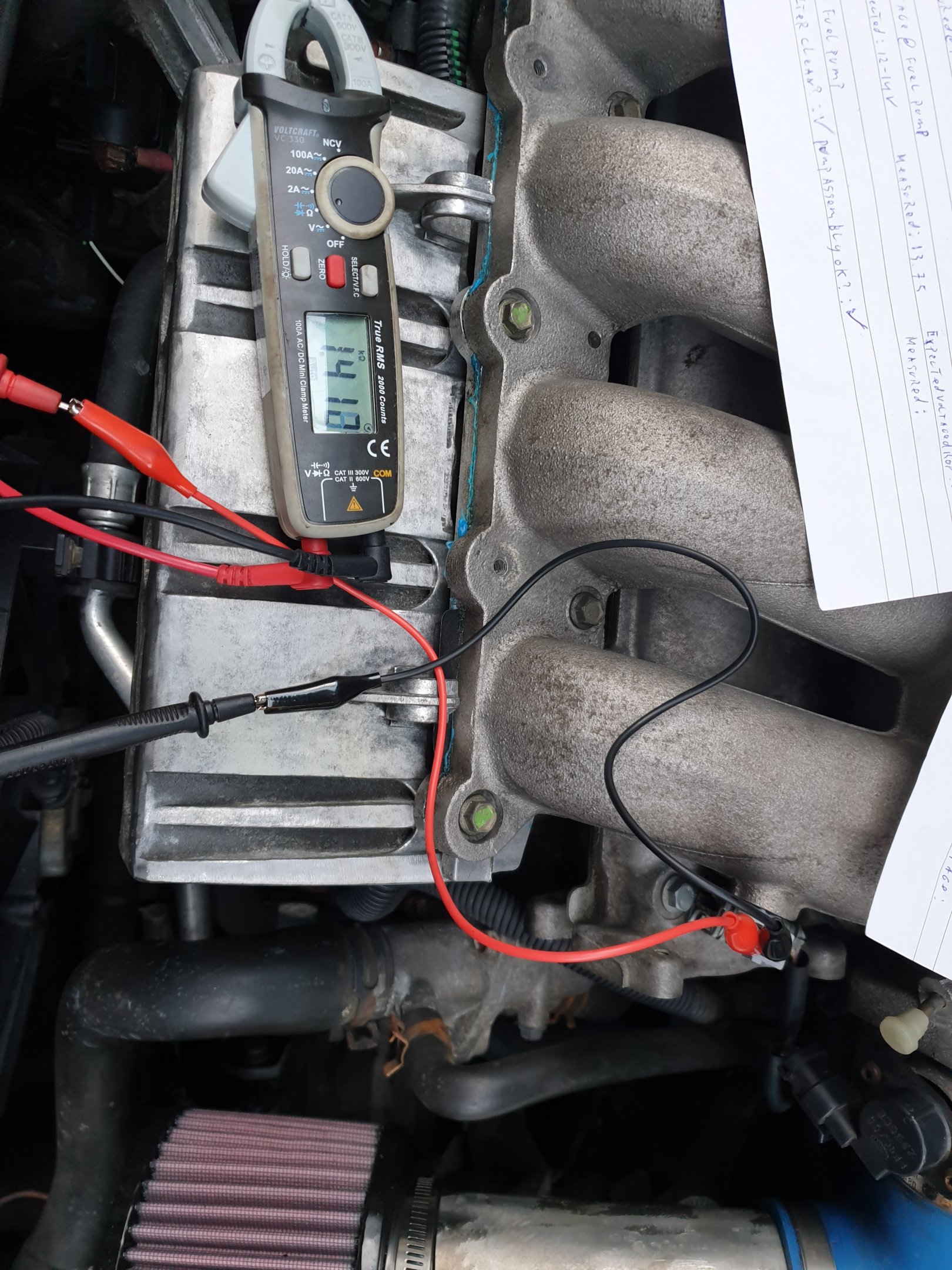

Was hoping to get a proper reading backprobing the ECU this afternoon but this was inconclusive.
Next step will be to measure the wiring between the ECU and the connector at the O2 sensor end just to confirm I'm measuring at the right pins and to confirm there are no shorts etc.
Then measure again, perhaps while backprobing the connector at the O2 sensor end as it's a bit less tricky than at the ECU itself.. I attached a page from the F4R730 technical notes showing what voltage range I'd be expecting from the O2 sensor just in case it helps somebody else out there

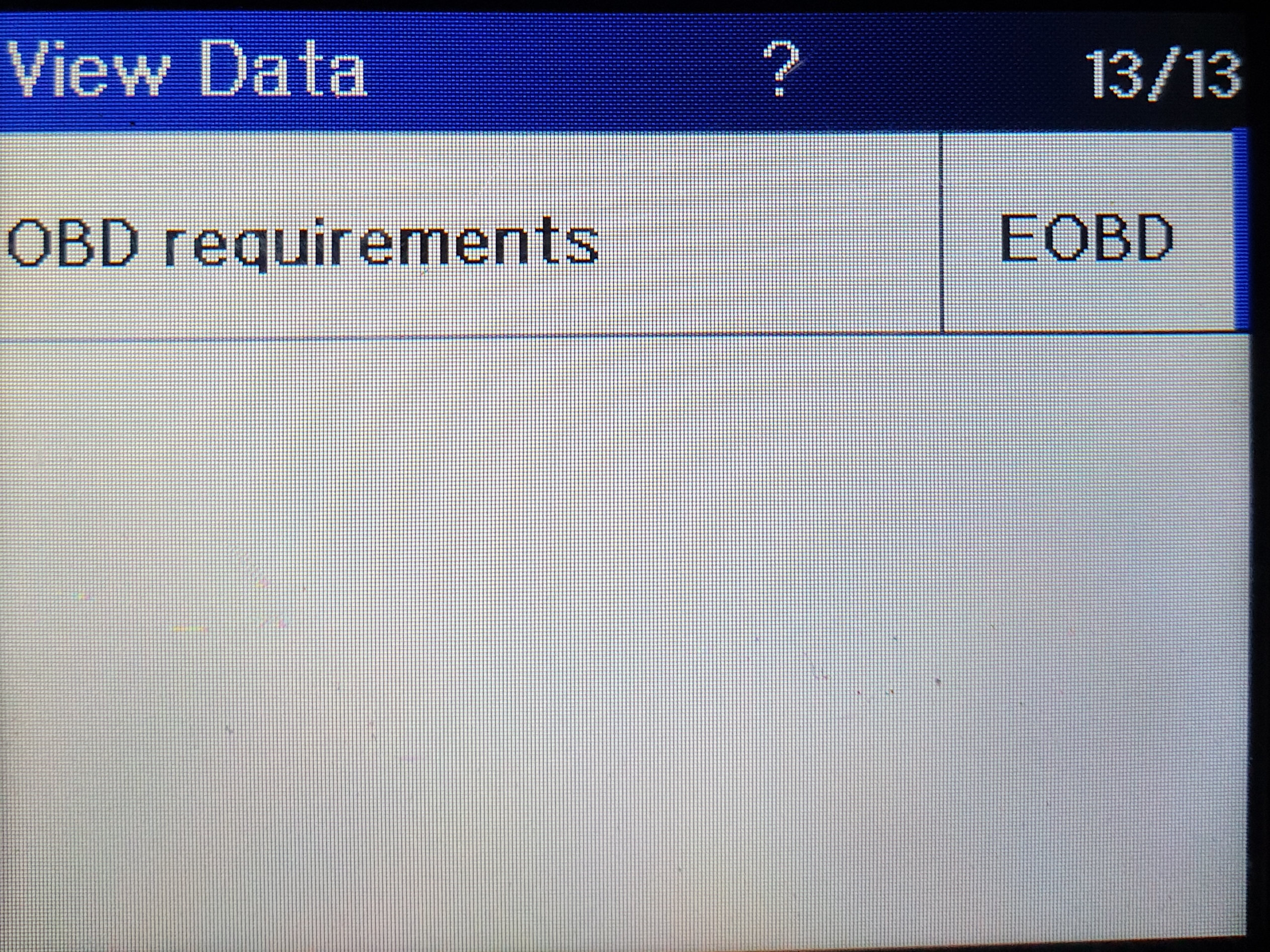

No it doesn't show up under live data at all.

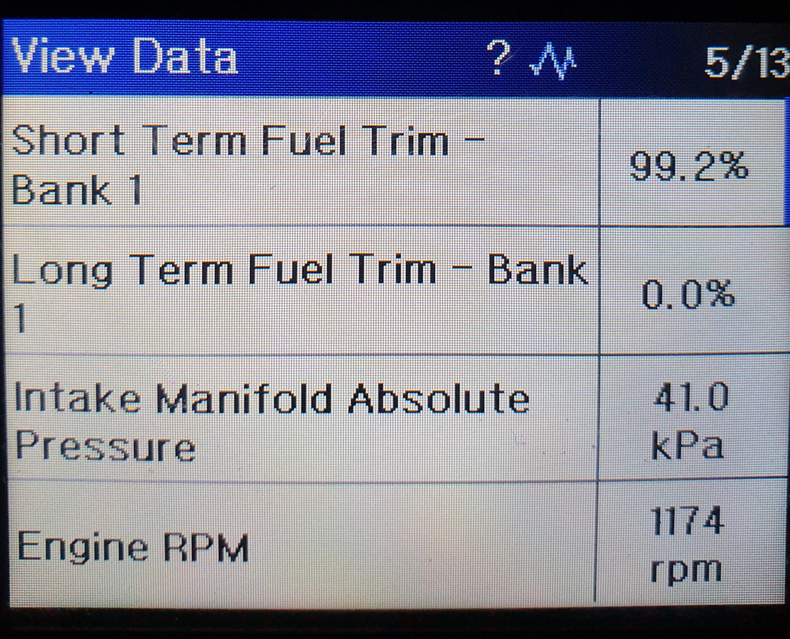

I did install the latest updates on my diagnostic device. Mind you, the clio 2 ph1 has a non CAN system so it is a bit more limited than a more modern car.
These are the things I can read:
As said before, the short term fuel trim only displays either 99.2 during driving or 0 at idle, so im pretty confident it's looking at the wrong source of information

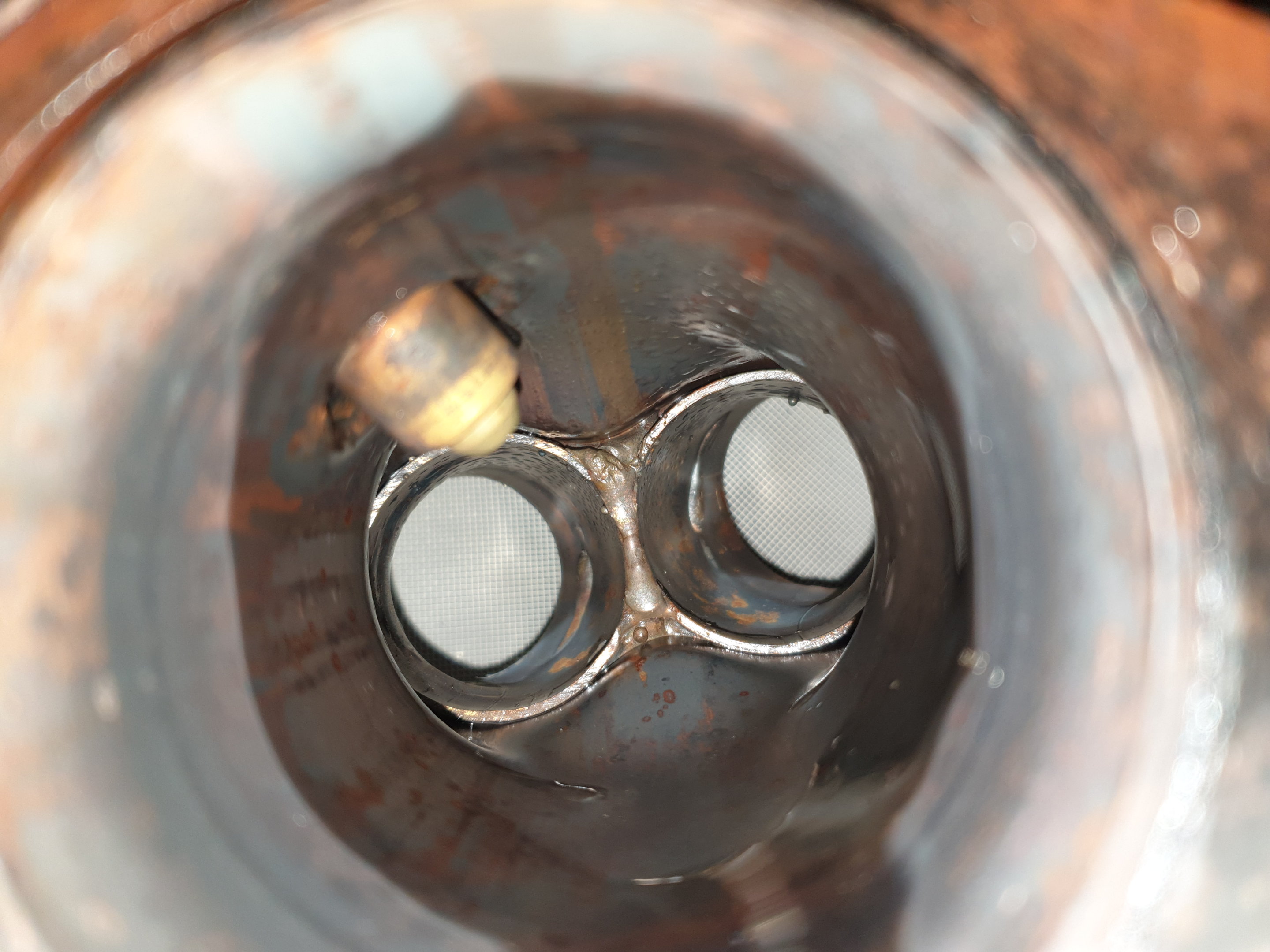

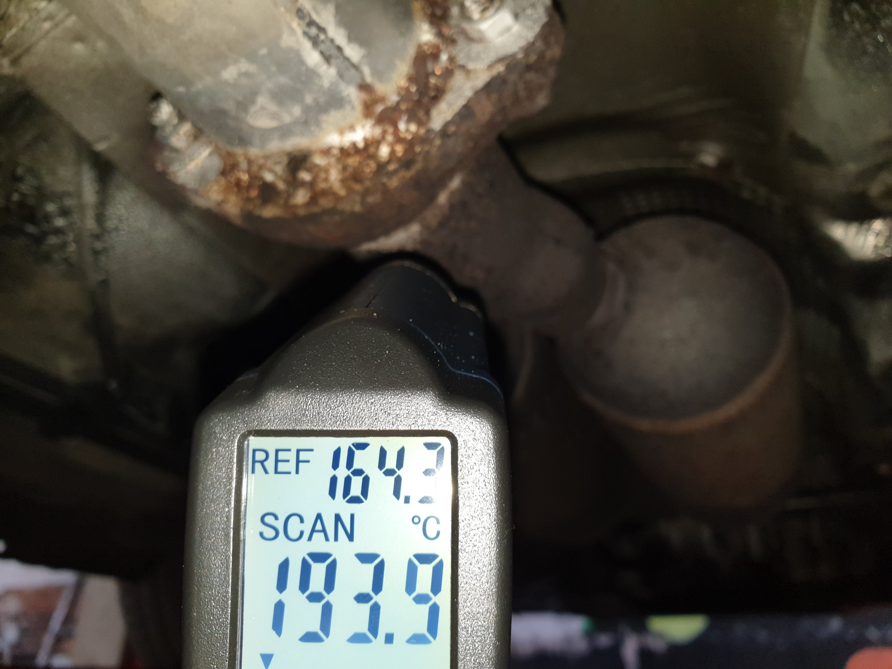

Have you considered that one of the double cats is on the verge of collapse?
It would be consistent with the thread title.
No 6 has been filtered.
172 ps not bhp.
You mean clogged? Or actually pieces of the inside of the cat crumbling and blocking part of the flow?
I can imagine that would create some significant back pressure with the neccesary power loss...
If measuring the O2 sensor and having a peak at the fuelpump/pressure doesn't bring the problem to light I'll pull it from the car and have a look, for now I'll just put it in the back of the list of possibilities ;)
/QUOTE]
That sort of thing.
Like crud being picked up from an old school carb float bowl, blocking the main jet, on full throttle & being dropped once the throttle is closed.
Every thing then returns to normal.
18 year old car, nothing lasts for ever, and it`s done well.
Think about a 182 exhaust manifold / decat/ sports cat/ cat back system.
Al the bits & pieces are available to make it work.
Much newer cars are crippled by collapsed cats, more common than you might think.

Ok, so it has been a long and somewhat dissapointing day. I tested my ass off in my freezing workshop but have not found anything significant.
Tests I performed today
- Voltage check on heater wires of the O2 sensor: 14.01V
- Signal voltage check on O2 sensor: expected between 0.1 and 1V measured: 0.04V
- Temp reading in front and after catalytic converter after drive:
In front of cat: 164.3C After cat: 193.9C
- Whack the cat with a hammer and see if it rattles: it does not, neither does the mufler.
- Voltage check at fuel pump: 13.75V
- Voltage drop at fuel pump: <0.5V
- Fuel pressure test static at pump 5.5 bar. (Only place to measure is after fuel filter, unfortunately bypassing the pressure regulator.) Pressure remained stabile.
- Fuel pressure test static at fuel rail: I have not found a way to measure actual fuel pressure at the rail.
- Pull fuel pump and check for clogging: filter, tank and pump assembly are clean
- Voltage check and signal check at injector control: 12.46V at each injector
- Re-test and clean individual injectors: have not found the time today
- Test fuel volume output of all injectors at the same time. (Will try to build a small test rig for this) have not found the time today
- Re-test idle control valve Unsure how to test.
- Test MAP sensor with vacuum pump: MAP sensor works perfectly compared to second MAP sensor. Did notice vacuum values in air intake are not decreasing a whole lot when accelerating. 400mbar@idle versus 330mbar@ 3729 rpm
- Test coolant temp sensor: 600 ohms@ 60C (within spec)
- Test air temperature sensor: 1400ohms @ 50C (within spec)
- Test TDC sensor: 243ohms (within spec)
-Test camshaft dephaser solenoid: 9ohms (tiny bit high but might be because of test kead resistance)
Based on the results I found the cat to be working as expected looking at the temp difference. I did disconnect the exhaust in the middle to have a look inside and to see if it made a difference @ idle. It didnt. The double cat looks brand new on the inside..
The reading from the lambda seemed to be off while on the car so I pulled it. Came off surprisingly easy once the exhaust was warm.
Tested it in the vice with a blowtorch, results were better but still not what I would expect so I swapped it for a new one for peace of mind.
Having driven the car after replacing the O2 sensor it looks like the 1500rpm stutter is less, but not enough miles on it yet to be sure. The sudden halt in power when going over 3500 rpm is unfortunately still there.
Since the engine has an aftermarket K&N sportsfilter I wanted to confirm once and for all that oxygen starvation is not part of the problem. I did a 3rd gear WOT run on a clean piece of road without the filter and pipe in place. The power loss was still there.
There are still a few things I want to test but am not sure how to yet.
I want to see what my fuel pressure does at the fuel rail, preffereably under load. And I would like to see fuel output from the injectors compared to each other. Will be continued
