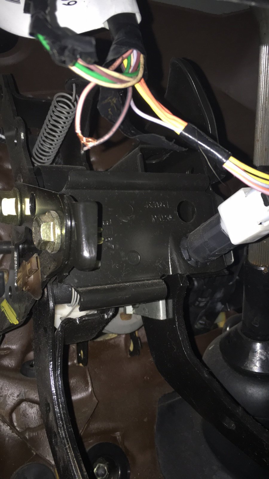

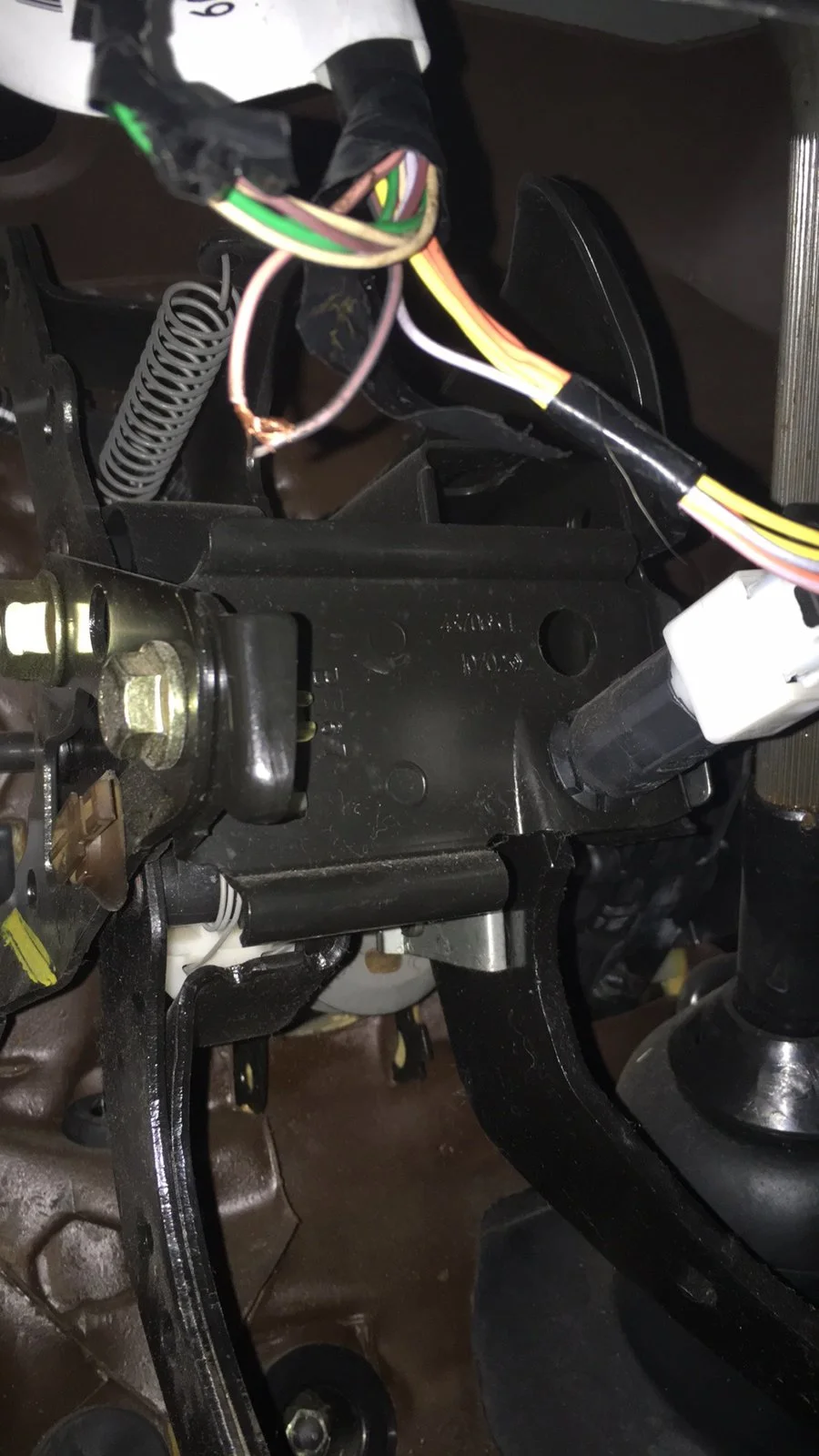

Btw this is the clutch loom bridge, is this correct?

I think the problem lies in the clutch-wire, trying to acquire the right loom now!

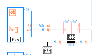

Sorry I didn't see the post. Have you tried it without bridging the connection. It shouldn't affect getting the light to show on the dash, only setting it the speed and it being held.
Looking at the diagram you don't need to bridge the connection. The connection is only made when the clutch is down.
