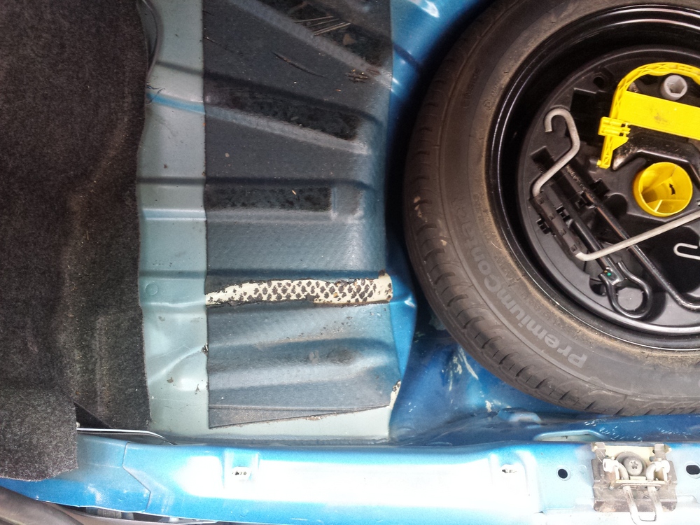

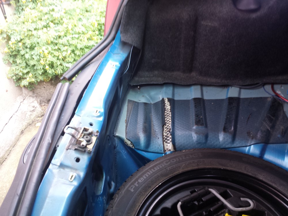

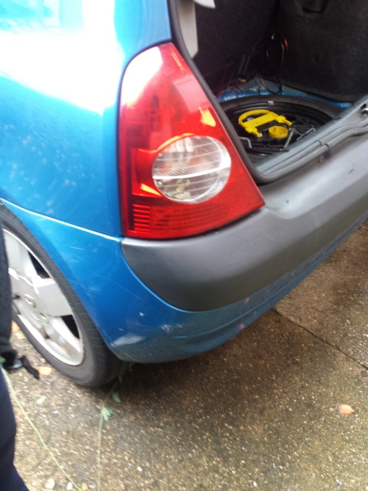

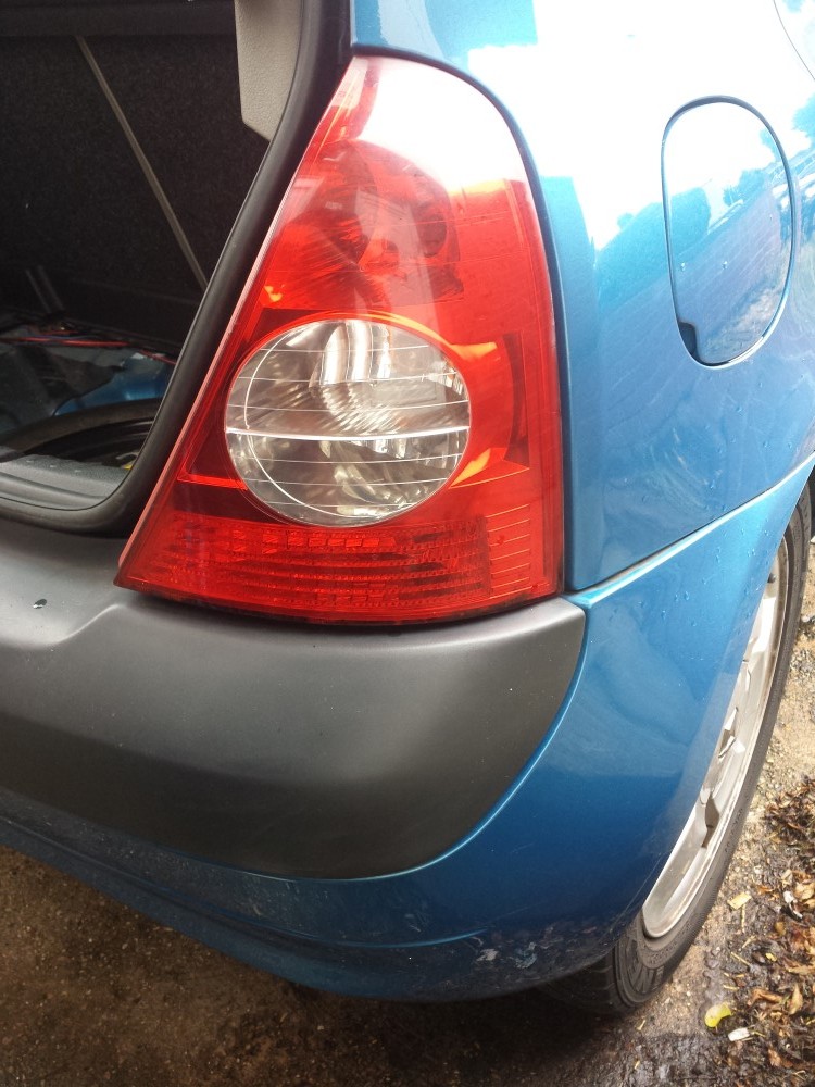

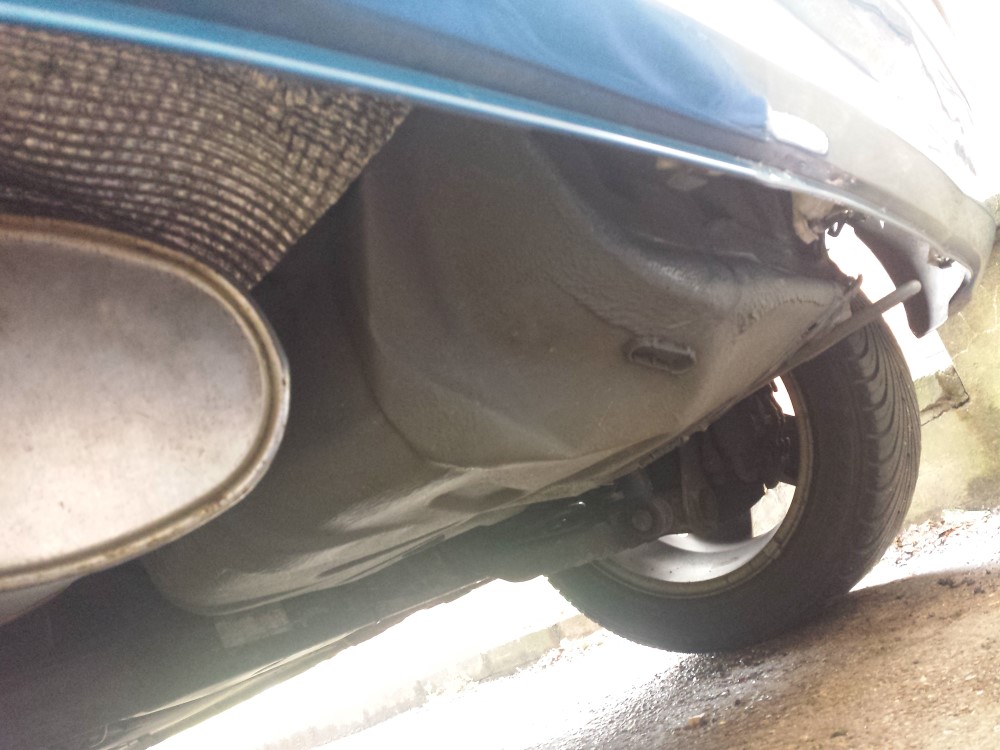

Hey guys, so bit of a problem, on friday just gone my car got slammed into the back of. insurance (admiral) will pay out 1000 odd for the car, of which i will get to keep it (they offered me 1100 but that would be car taken!). I am guessing from the damage i can see that it will be a CAT C... had a good look under the car with a mechanic and the axle even appears to be in good shape and its actually legal to drive right now afaik all light clusters ok, axle ok, exhaust ok lol.
Bit confused about the whole category process tho... and in a nutshell is it worth me even putting this car back on the road, or do you think i should just brake it for spares? i mean, everything is ok, minus the bumper and rear metal parts!

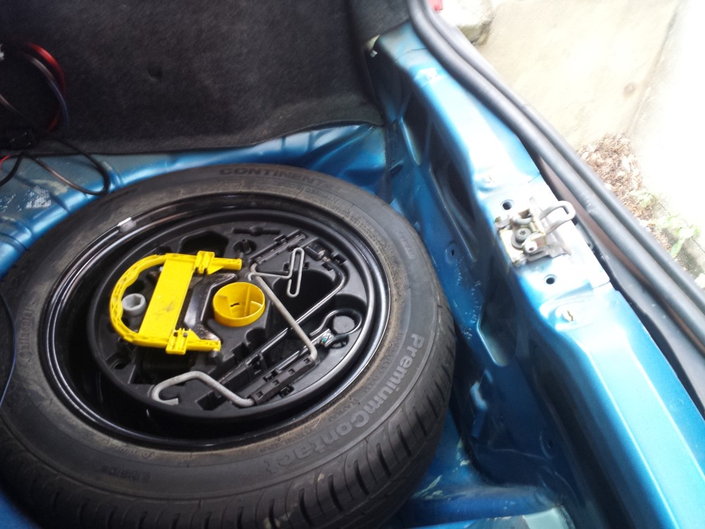

A lot of damage has been saved by the spare wheel by the look of it.
If you are happy enough, just get a rubber mallet and knock it back somewhere near the shape.

OP: lucky they are happy to do it just by sending pictures - much more common sense approach for a low value car with minor damage. I'd guess it'll be a cat C. So long as you can repair it for <£500 I'd probably keep it. Is the tailgate damaged? The bumper looks OK from the pics other than being out of alignment. Not sure if there's a crash bar behind the rear bumper - if there is then it might need replacing.

the tailgate is not damaged, but it requires a very heavy hand to shut it, i think the lock bolt just needs a little adjustment.
There is no crash bar, only plastic bar things, so i dunno....
