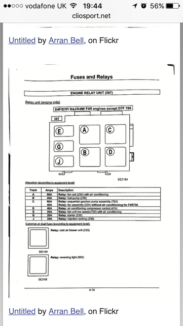

http://www.cliosport.net/threads/engine-fuse-box-list.786994/
E J AND G are all the same 20amp there the ones that give problems you can get them new off eBay, J being the fuel you can swoop them around.

I played with the 15amp fuse that's to do with injection/ ignition under the bonnet (fuse 5 in the pics above) and removed from fuse holder and crimped the cables onto the fuse direct and it ran fine for about 40mins on and off track but done it again 15mins from the end of night.

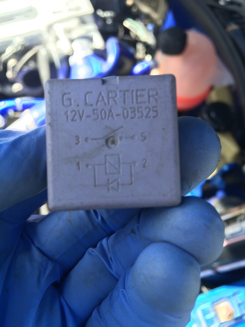

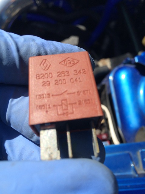

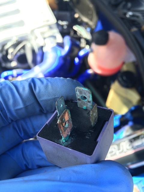

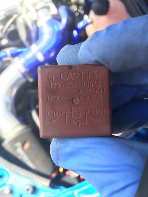

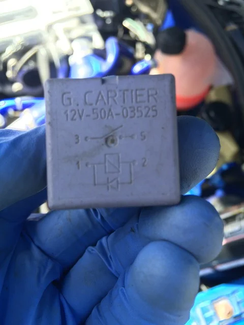

Had a play about today with some of the relays and fuses.
This first one (purple) was in position A. That was the worst looking one. The rest came out and looked clean.
Swapped G and J and also swapped B and D. See if that does anything for now. Will order up new one and replace just to rule them out.

if the pins on the relay are that bad the holder will be worse, strip it out and clean it up. bit of decent wheel acid and then dunk in some water with bicarb in to neutalise it.

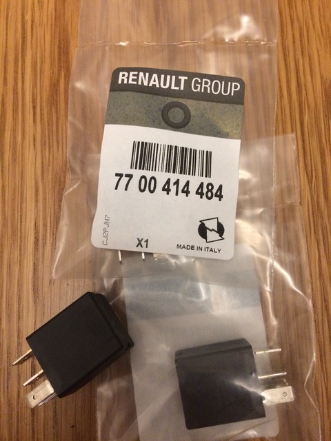

New relay arrived.
Yet to try the car out. Think I need to do a few changes and go to the track and test. As I can't simulate the fault on the road
These were the relays I replaced in the wife's phase 1. I cleaned up the terminals too! Been fine ever since! Cost me £63 a year ago!
