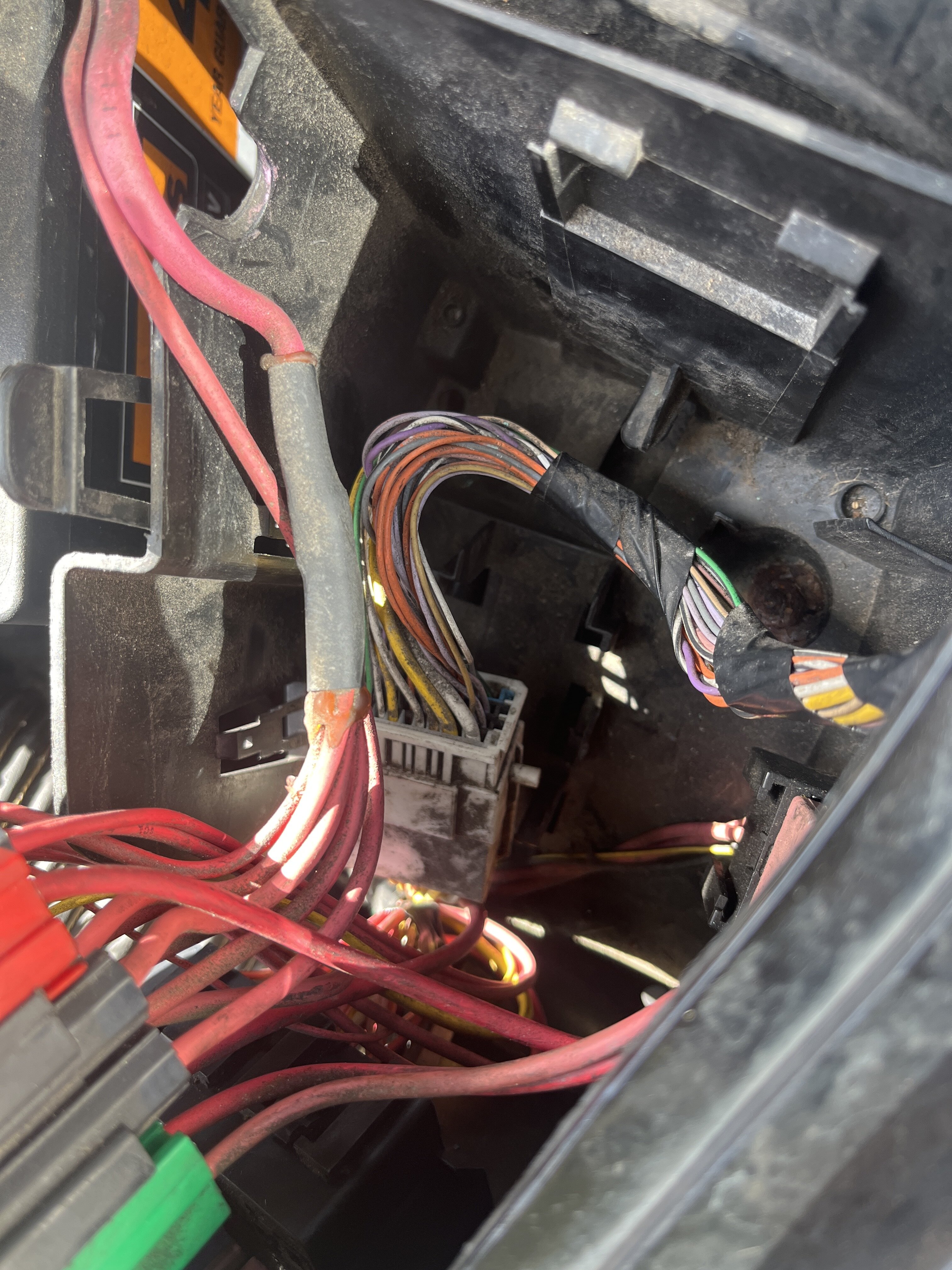

Finally down by the white plug. However struggling to get it apart; is there something you have to unclip? Cheers
Touch wood cars stopped revving its tits off randomly since last post cleaning the white plug. If anyone’s having similar issue defo worth a try.
Wasn’t loads of corrosion on there so it may not be obvious
