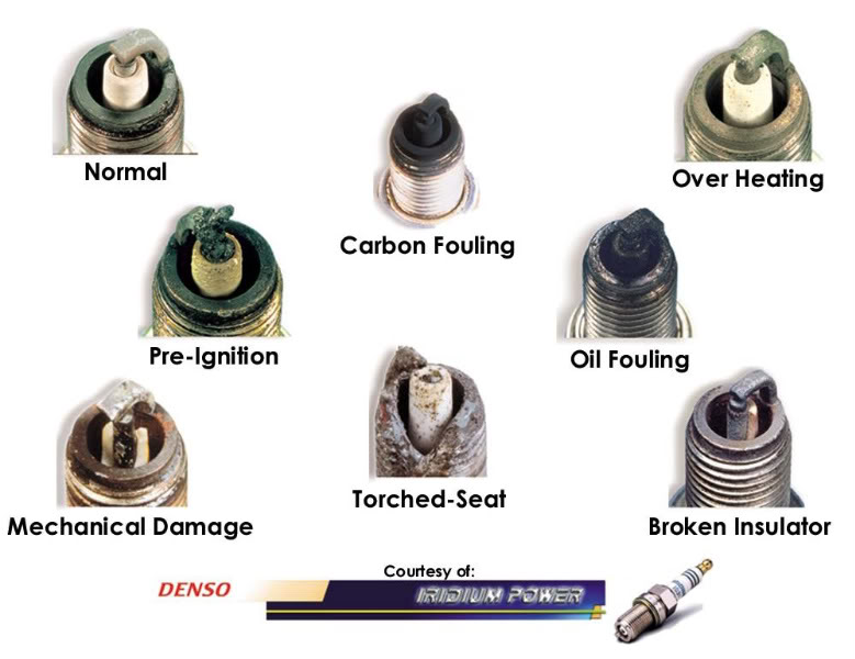

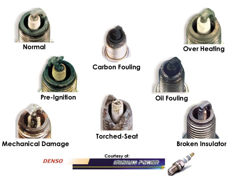

At least you have a good start with maintenance done recently. I didn't mean the spark plugs being faulty but more the colouration of the tips.
http://i176.photobucket.com/albums/w170/SDHonda153/DensoSparkPlugChart.jpg
I personally would check other things before the fuel pump. There would be other signs of a fuel pump failing at high revs such as white tips on the plugs (running lean)
