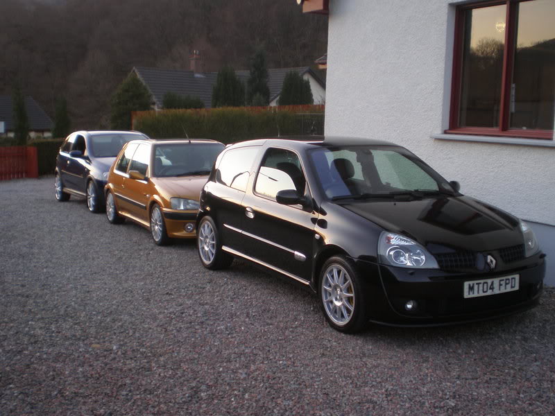

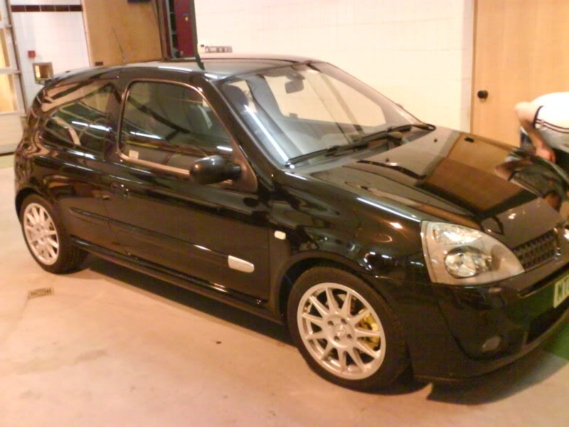

Car got the sonus pc treatment.
  182 CLIO SPORT
After getting my pc last week i thought i'd give it a bash.
Started with a GOOD WASH(chem guys wash and wax)
sonus grey clay bar with chem guys QD
chem guy lazer buff with white pad
AG srp with blue pad
AG ugp, sonus der wonder applicator, left for 30mins
Chem guys 50/50wax. sonus applicator
Came out good but as yet i say i have a lot to learn as i still aint happy about some swirls etc.
