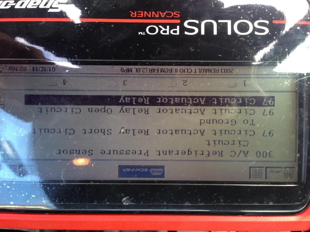

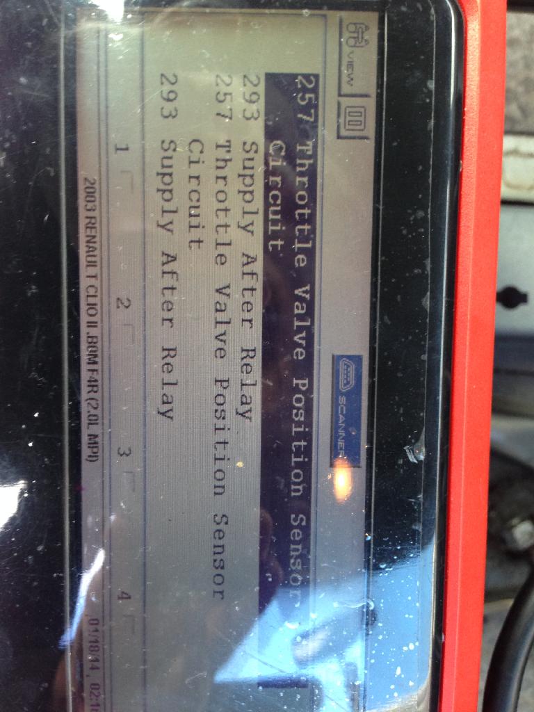

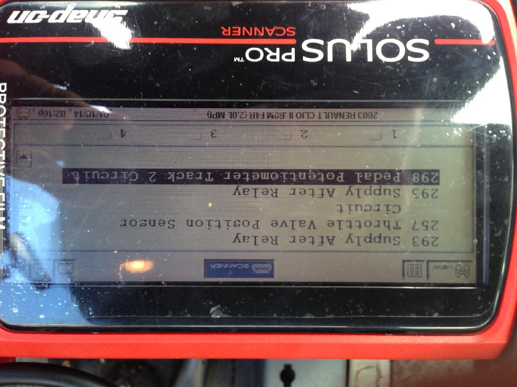

I would push the throttle body open, then just get something to hold it open a little? Place screw driver in there? Holds the flap open. If it starts it might idle high.
Or do you have a 172? They have cable operated throttle body and this won't matter
Mine jammed shut so car could not get air and start. I had gave up with the car. But my brother would not let it beat him, he accidentally caused an air leak and it started lol
Even checking your second key? The battery disconnect for 10?
But like dan said lots to go through unfortunately .
You could do a search and check what's worked for others with similar problems? Trying not to spend too much money buying parts you did not need to buy? maybe you could borrow a friend with Clio and try his good bits ?
