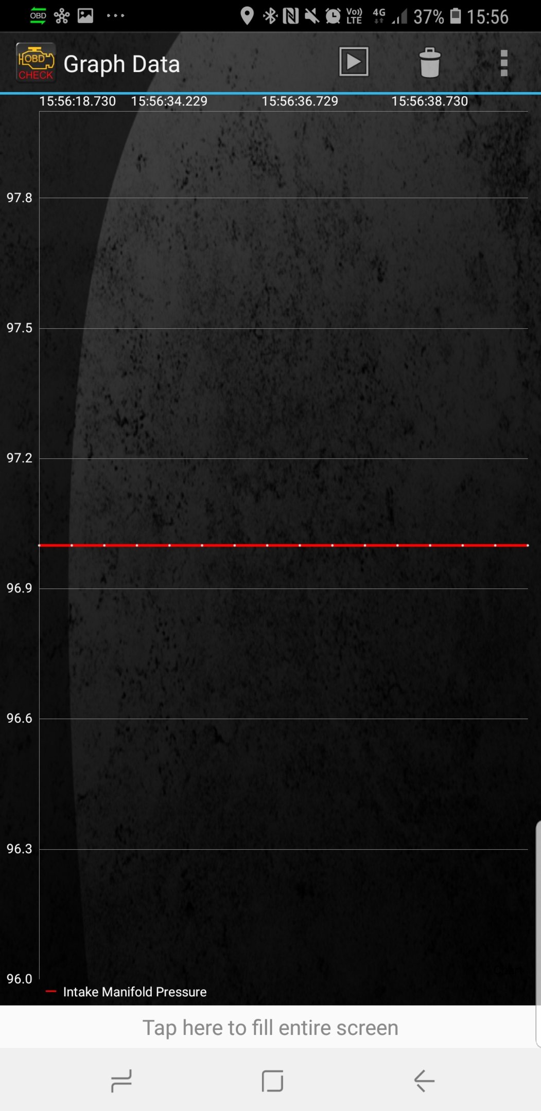

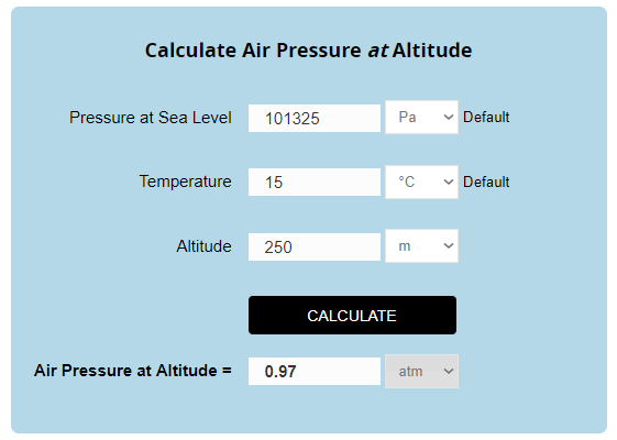

I would say your map reading with engine off is c**k on...
Altitude taken from your 'GPS height' pictured in a previous post.

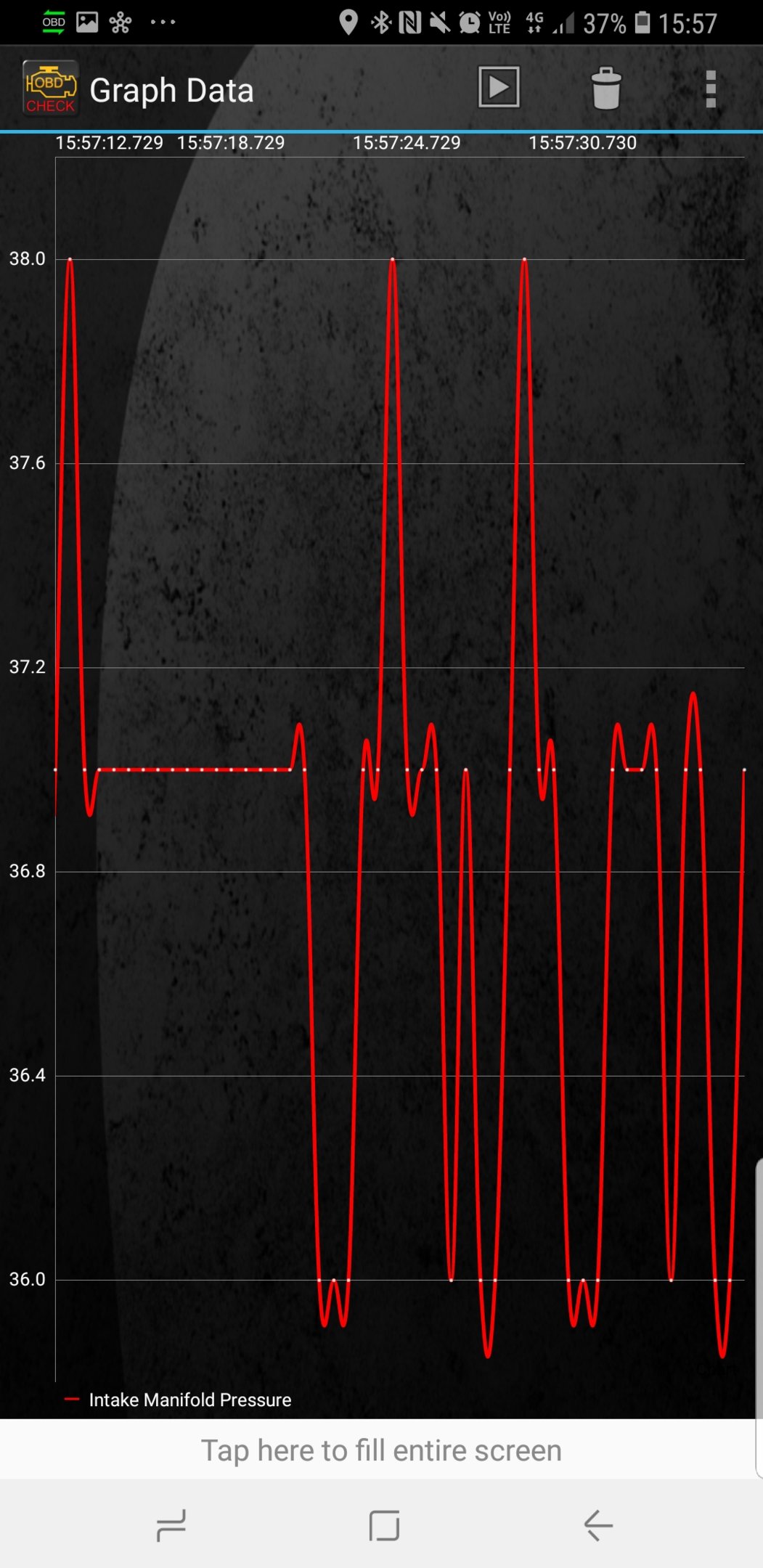

Yeah okay odd! Noticed today just being sat in traffic and putting the clutch down caused revs to bounce slightly. Handbrake on.
Louis
I Love Ed Sheeran
Sprayed some brake cleaner around and made no change. Was thinking I'd fucked up the throttle body spraying it somehow but it's been like this a while tbh.
Flob
Brake cleaner doesn't always work, especially if the leak changes with engine movement (say gear change), butane/propane works a little better than brake cleaner too.
Flob
Wonder if pushing the clutch in flexes the bulkhead slightly near the brake servo? I would expect pumping the brakes to move idle around quite a bit normally - could give the brake servo vac line a good shake around and see?
Does the TPS give good consistent readings? Cars will use either the tps or the map (or a combination) to determine acceleration enrichment and would certainly (if wrong) cause a jerk when changing gear.

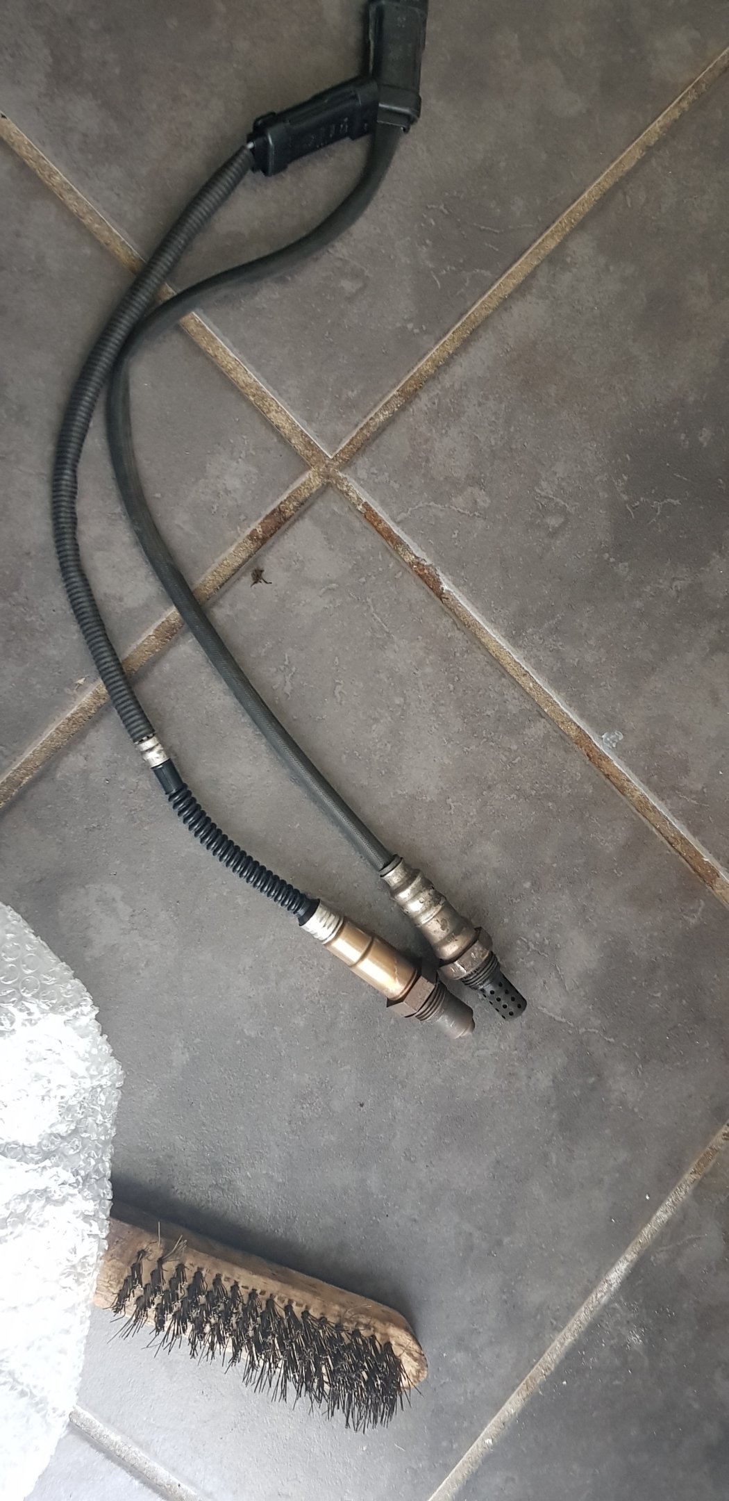

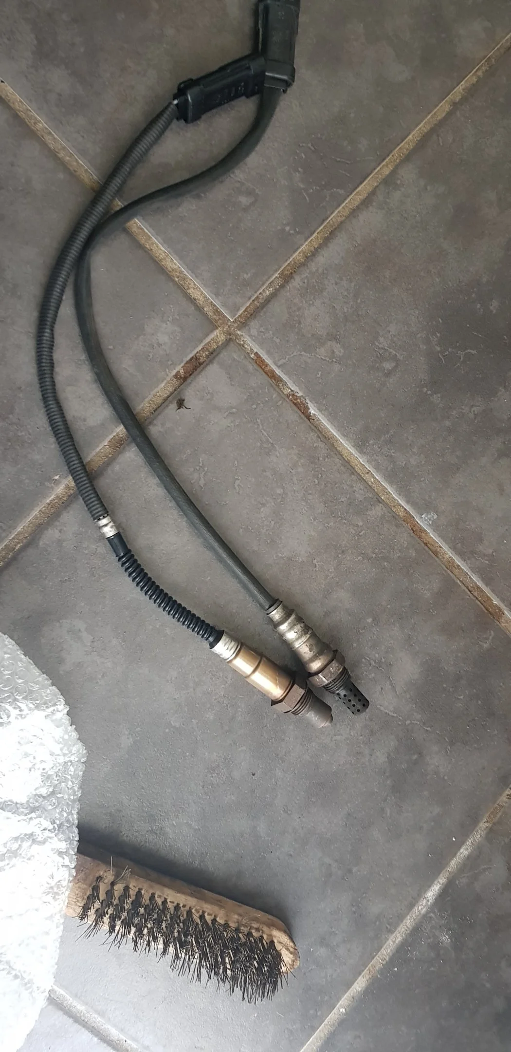

Swapping out lambda, top one is the one off the car precat (furthest away from wire brush)
Isn't this wrong? Looks like a generic cheapo lambda.
Bottom is the 'new' one (done like 400 miles off someone on the forum)

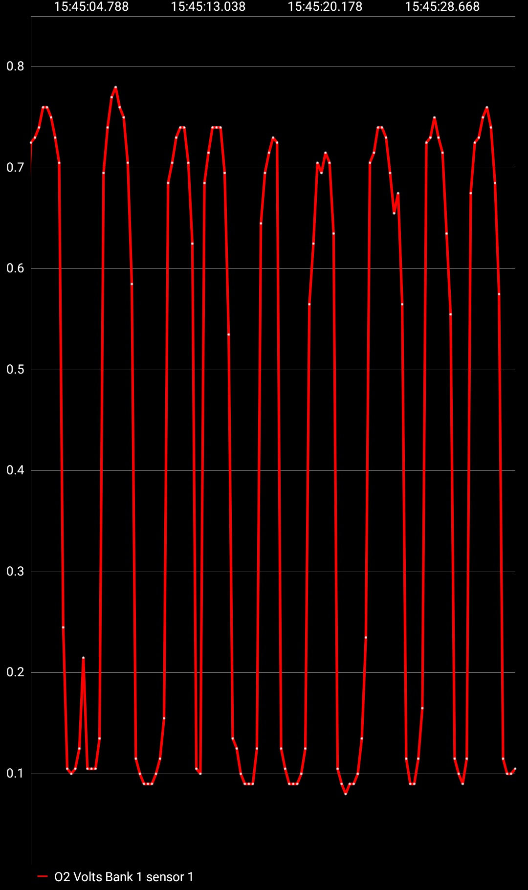

Replaced the lambda with genuine Bosch and it seems to be graphing better?

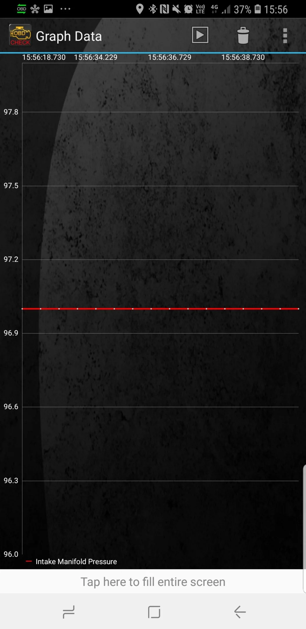

Also mapped out the intake
Seems better with the new lambda, going to give it a proper drive tomorrow.
