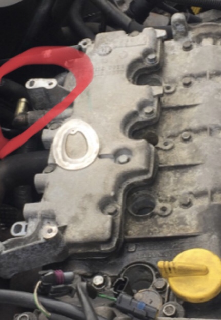

182halfpenny
The breather plate on 172 has a bit sticking up into the manifold however the 182 manifold doesn’t have that slot ? And the breather plates aren’t the same? So the 182 manifold doesn’t sit correctly on the 172 block?.
  dan's cast offs.
as long as you've got the 172 upper on it then check it's seated properly, they can feel as though they are but will be sat high at the back, check egg seal and then everything else on the manifold.

Okay I’ll have a look.
where does this connect up to?. I’m thinking I missed that and that could be the problem?.
d19wood
  Clio 172 T , Megane
I forgot to put the block connector back on the throttle body under the induction bend and mine did something similar. Started it and jumped immediately to a steady 4000rpm if it's the fbw throttle body you might want to check it's plugged in properly.
182halfpenny
So I’m now down to 2000 rpm on idle after re sitting and tightening the bolts. Would you suggest there is still an air leak on the intake side or am I missing something??.
