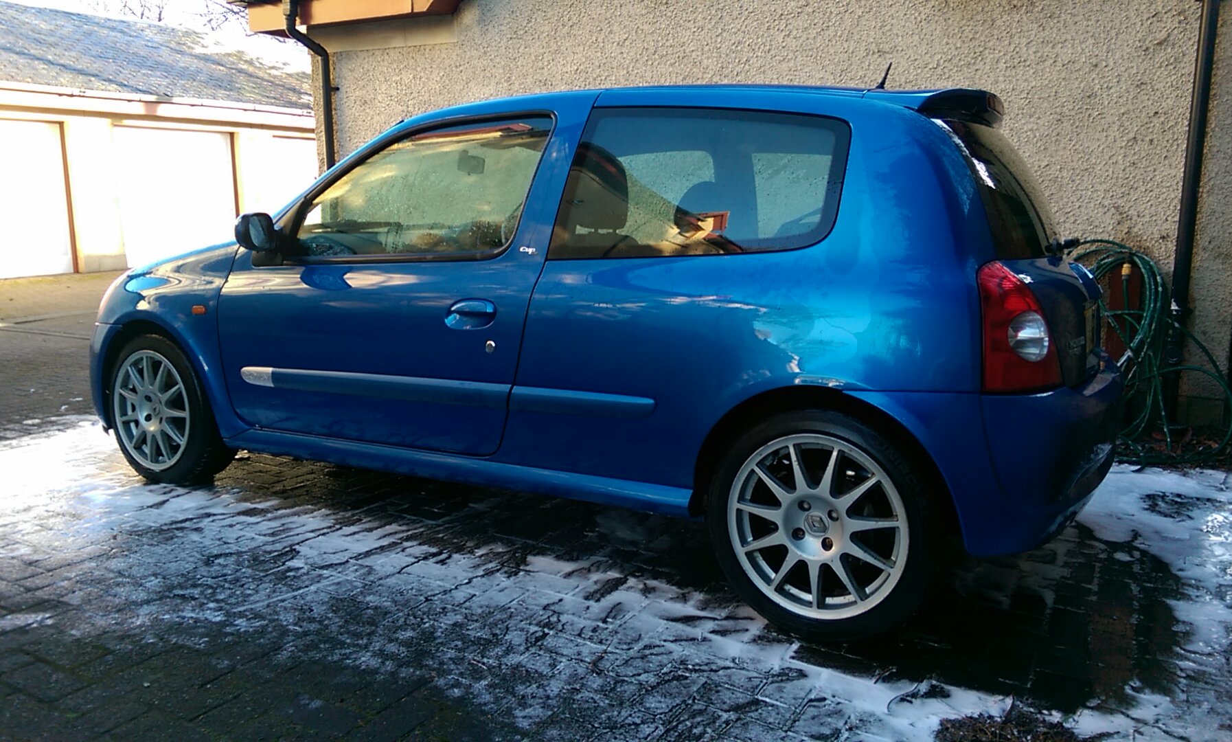

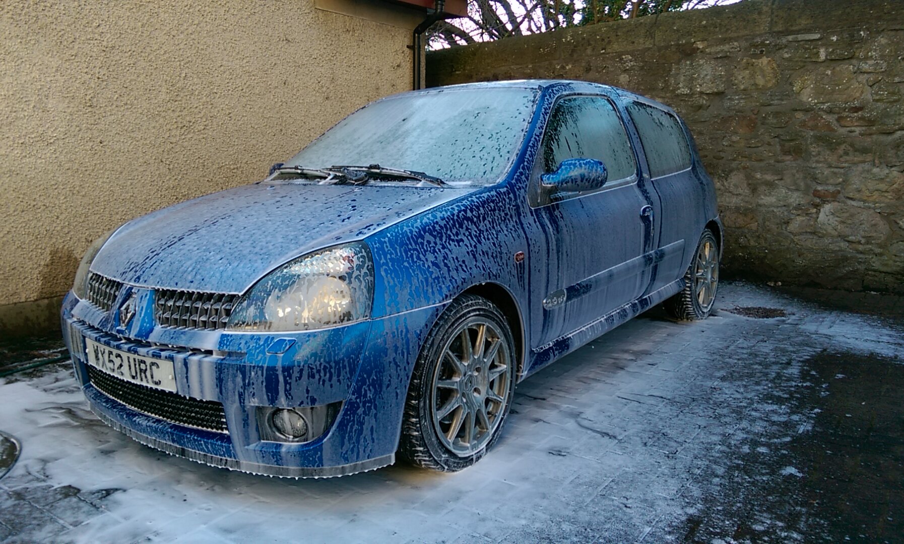

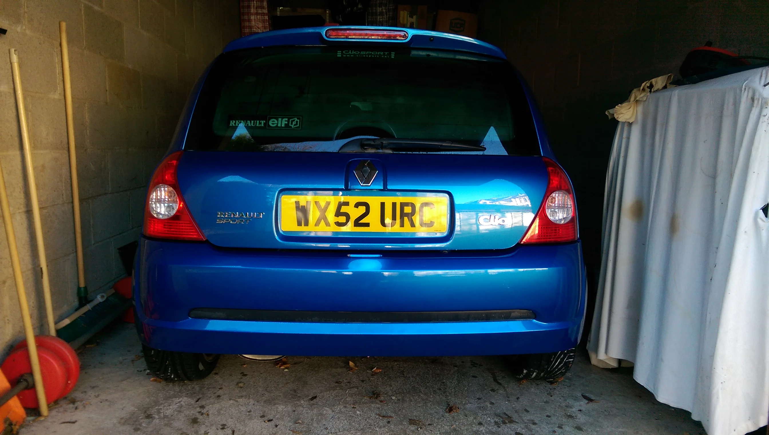

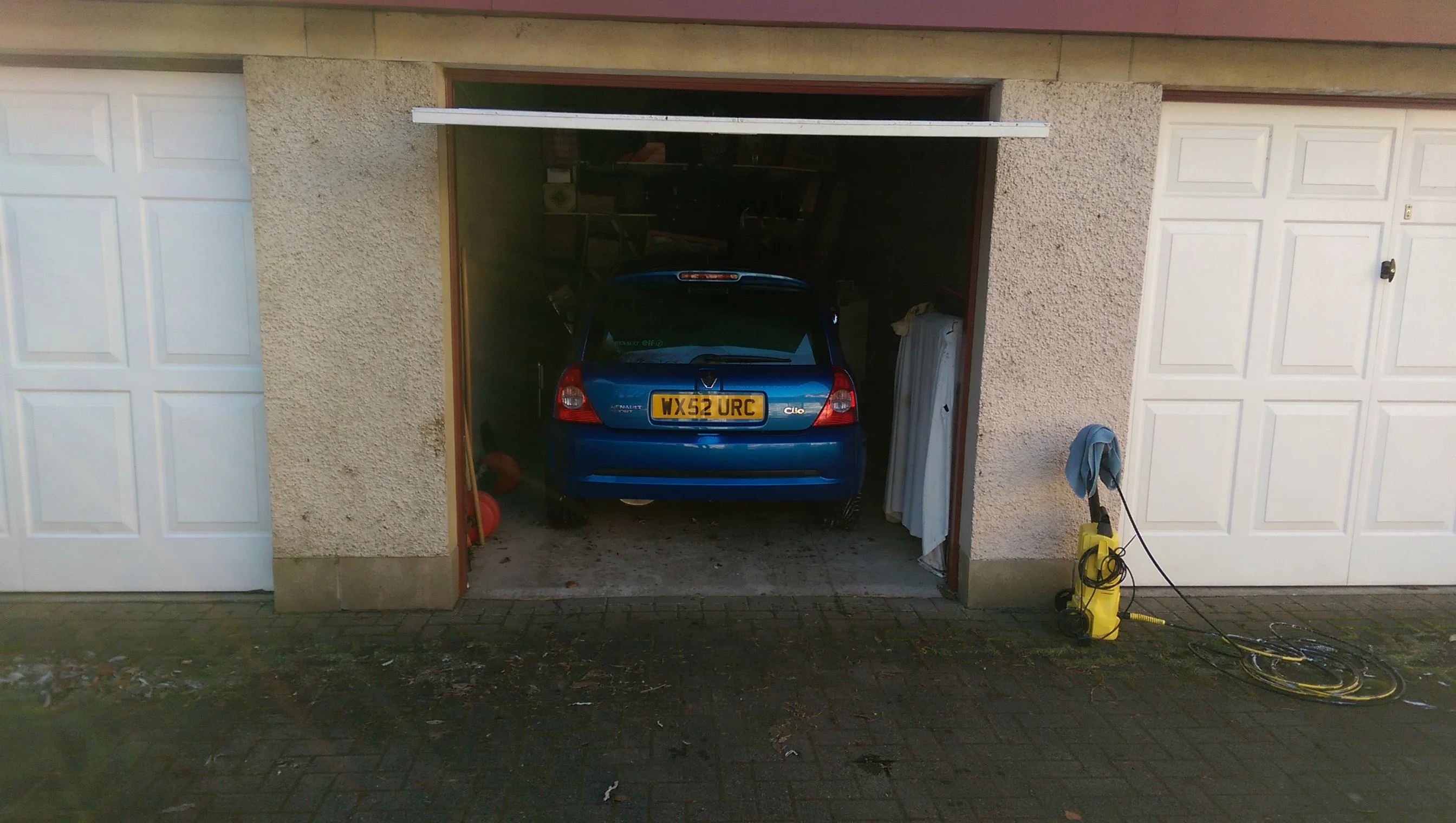

So turns out it was the battery... .... jump started bonnet catch also sorted. Took it for a long drive then gave it a good clean before tucking it away in my parents garage . Drove perfectly after not moving for 3 weeks
