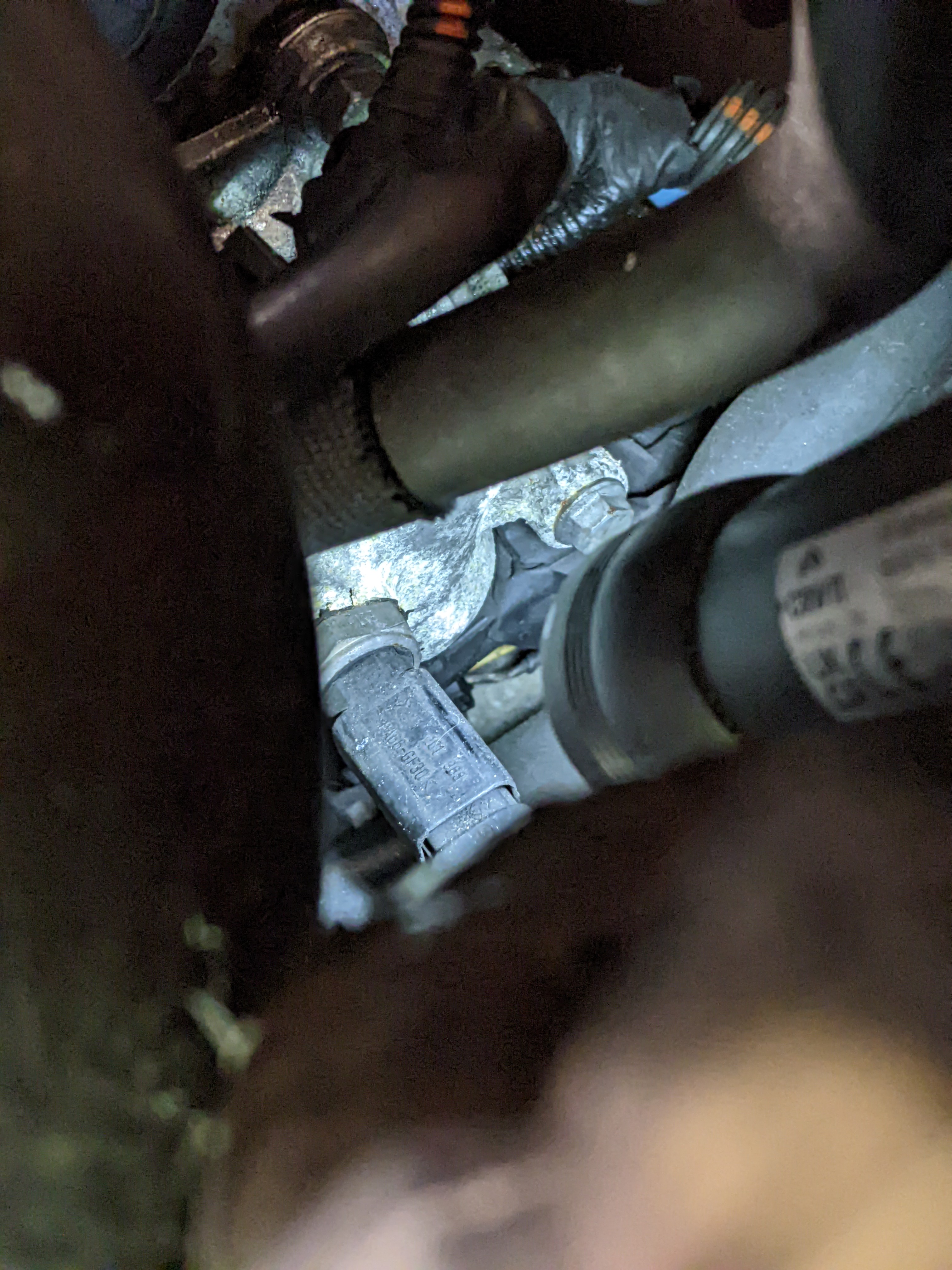

Matt Cup
  Iceberg 172 Cup
Crank position sensor is here.
Post #16

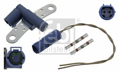

KTEC sell two of these, one looks like a copy part for around £46 and a genuine Renault item for £131. Which would you recommend?
EDIT: Is this it?

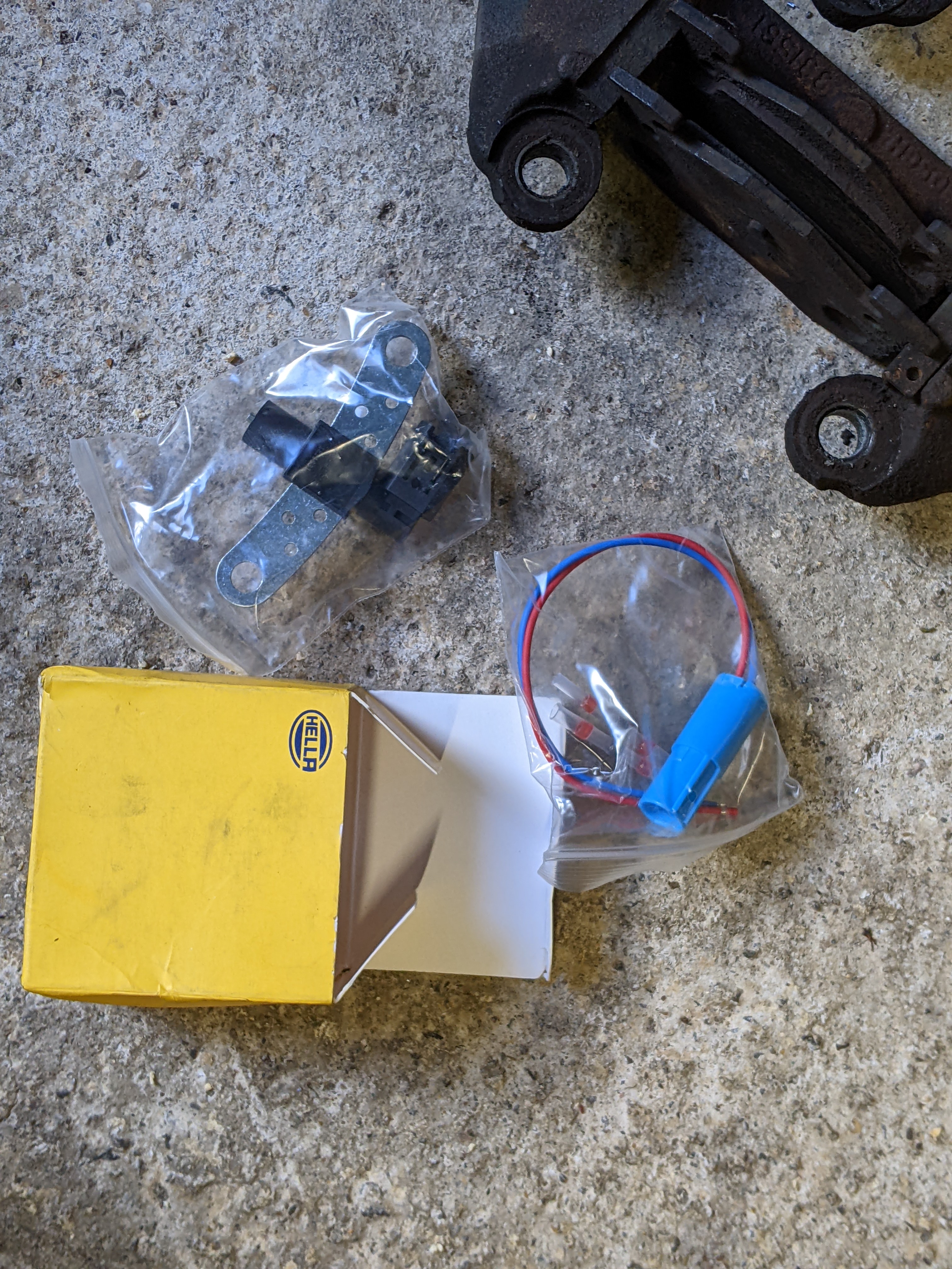

TheBandit
  Monaco172, Green1.2
Hella and Febi do them for about £20 with loom, you can get a genuine one for £60 Renault Parts direct + £24 for the loom bringing it up to £90 or so with delivery
I have a Hella one as my backup, but not yet had to fit it so can't recommend it as such
EDIT: Some private sellers have genuine for about £20 on ebay

You might need the bit of loom with a plug to splice into the original wiring if it hasn’t been changed before.
Ok. KTEC sell them with the wire and what appears to be one of those sleeves that need to be heated up to seal around any wire connections. That means that the old sensor is unbolted and its wires snipped, then the new sensor wires are joined to the loom and covered by the sleeve, right?
TheBandit
  Monaco172, Green1.2
Yep, just making sure you get the wires the right way around 🙈
ex-Chinese Dave
  172 Cup
Only one way to find out ✂️✂️✂️✂️✂️
Don't say that!!!
The tech info says "Connect them to the repair kit, if the original wiring harness has wires of the same colour, mark these wires before disconnecting to save yourself time and any incorrect joining of wires."

TheBandit
  Monaco172, Green1.2
Looking at the invoices I know the sensor has been changed on mine but I don't know about the loom. Looks like shrink tube on the black wire..., will find out when I next pull the airbox
My loom is cream/black and the Hella replacement is red/blue 🥴 did you go genuine?
