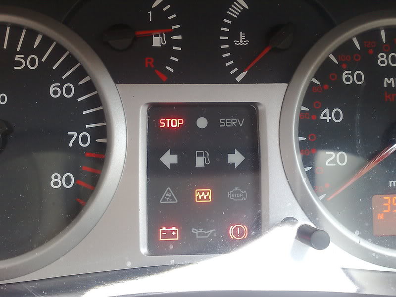

b*****d thing left me stranded in Barmouth (N.Wales) yesterday. Came to start it and got the the 'electrical fault' light on. Car turns over but will not fire.

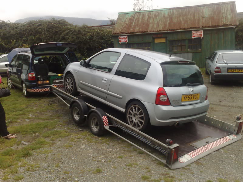

Eventually RAC man called and he couldn't find anything either so I got recovered home (only just in time for the Rugby!!) and it's now sat on my drive.

Pic of light on dash;
Pic of car looking very sorry for itself. Yesterday was a bad day for the French all round. lol.

have you used the fault finding dash?
Yup. Came up with t----...... but it did that when it was running ok. lol. I *think* that signified an injector fault but couldn't remember. Can't seem to find the thread with all the codes in either.
