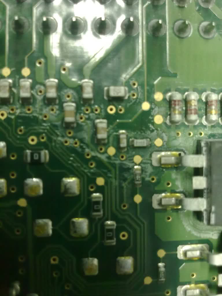

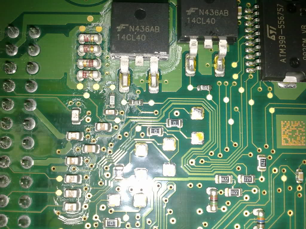

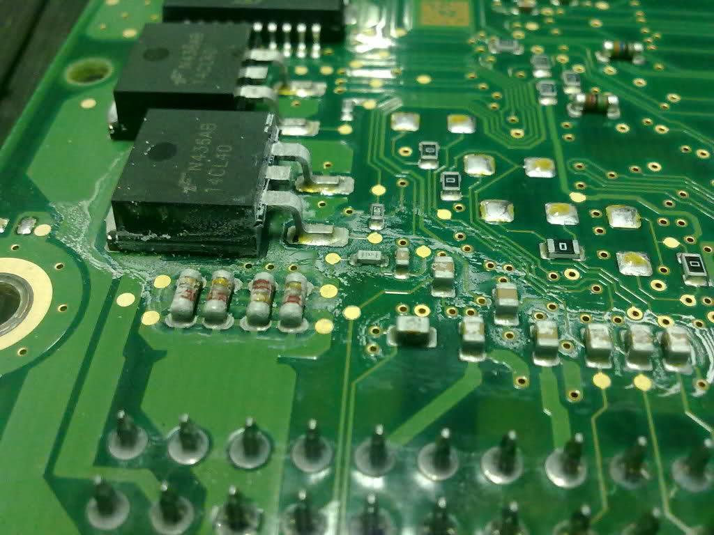

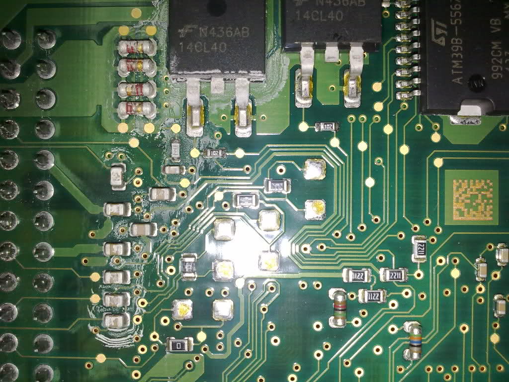

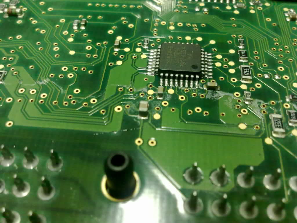

After having purchased new UCH have just found out the ECU needs a looking at aswell, has obvoiusly got wet and is corroded...
Does anybody know anybody that deals with these kind of repairs, is it possible to get it repaired,etc... ?? Heres a few pics of the state of it...

How on earth did you manage to get both wet? Get yourself a spare set mate. Will be easier and cheaper in the long run

I would have thought that repairing the ecu would also lose the map. Even if it was possible it looks like you'd need to change chips on the board.

That would be a big downer if repairing the ECU loses the map... Any ideas of companies that do this kind of repairs ??

Not sure I'm afraid, probably somewhere that can repair computers.
I'm assuming that the data is stored on the various chips, so if they are damaged you'll have lost that information.

I think Henk does it, or knows someone that does. It would probably cost you more to get it fixed really. I know what you're saying though. Sell the uch and use that money to get the car remapped? Did you use the new uch or could you just return to Renault?

Has be taken to somebody for a good clean this weekend...we dont expect its gonna do much but its worth a try... :dapprove:
