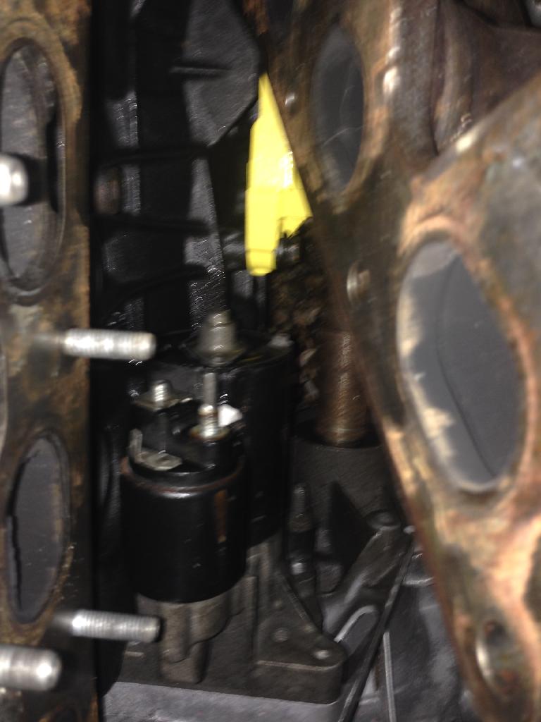

im going to remove inlet and unbolt manifold to see if I can get a good look at the starter motor connections . May use a mirror as I know I can't see from
above or below !

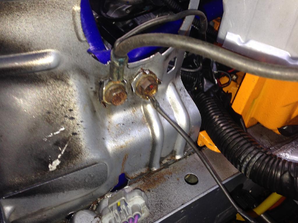

i removed starter motor connections. Big one goes to the long shaft with thread and smoothe and the exciter wire just pushes on and there's is one already on by a nut .
so don't think it's that .

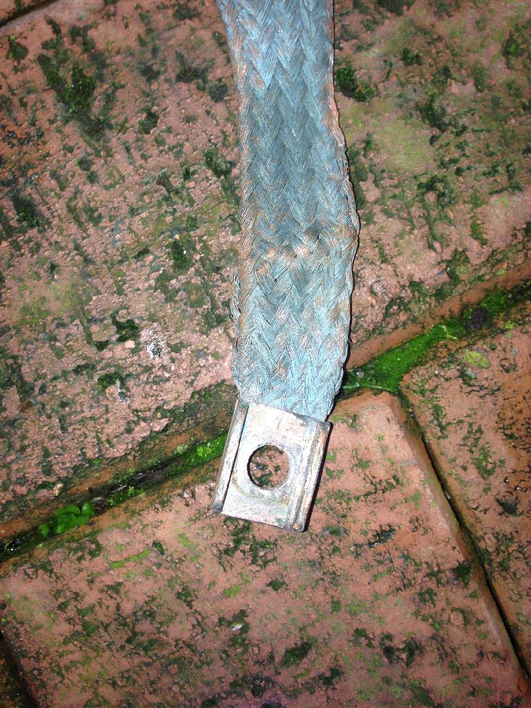

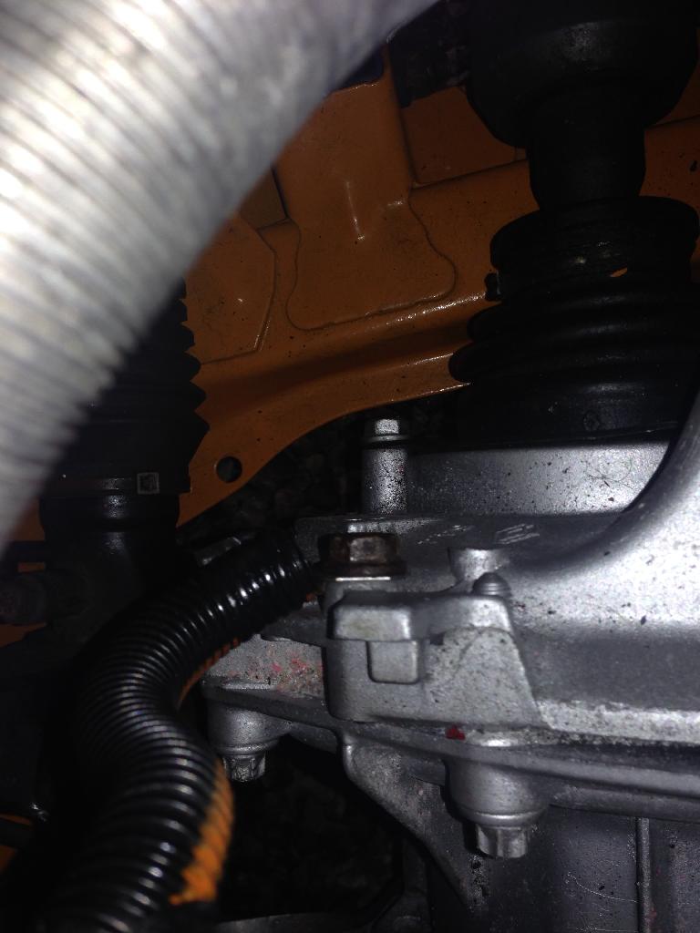

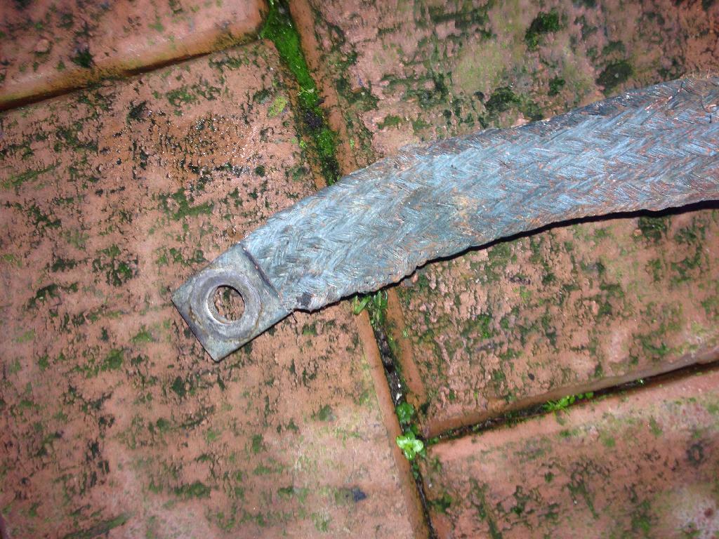

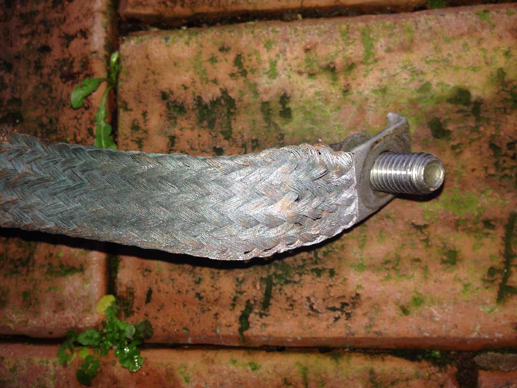

Dan I've got all them earths bolted . I've got it bolted to the gearbox case via one of the gearbox bolts .
could it be because I've painted the box it may have a bad connection ?
finch wxm
  clio 172
That's where it's bolted ? Is that right ?
im just going to remove the bolt and sand it and will so this for the one under wheel arch and the ones by where headlights go .
it has been standing for 2 years so the weather has probably got the better of it :-(
  182 ff
if the bolt is touching the paint.. need to take it off where it makes contact..just incase that's the fault.

Will try this in a minute once I've put the strap back on buddy !
