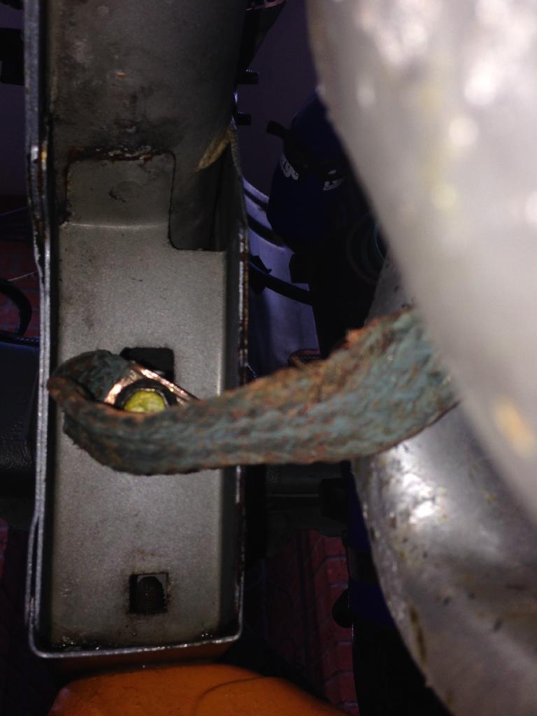

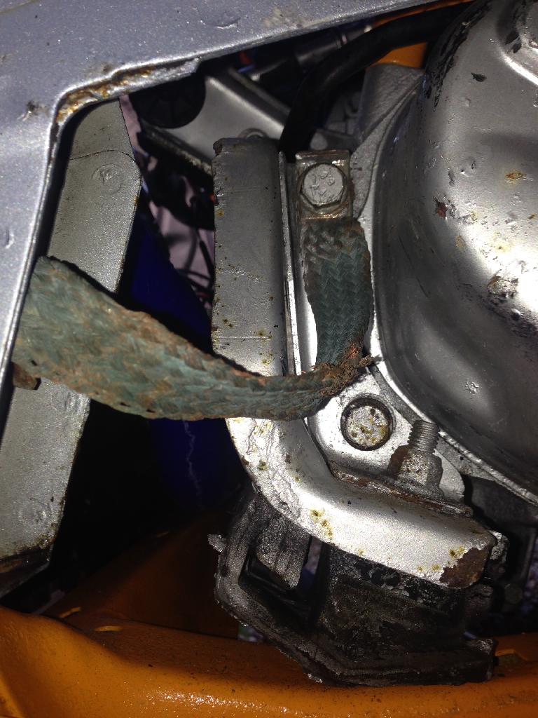

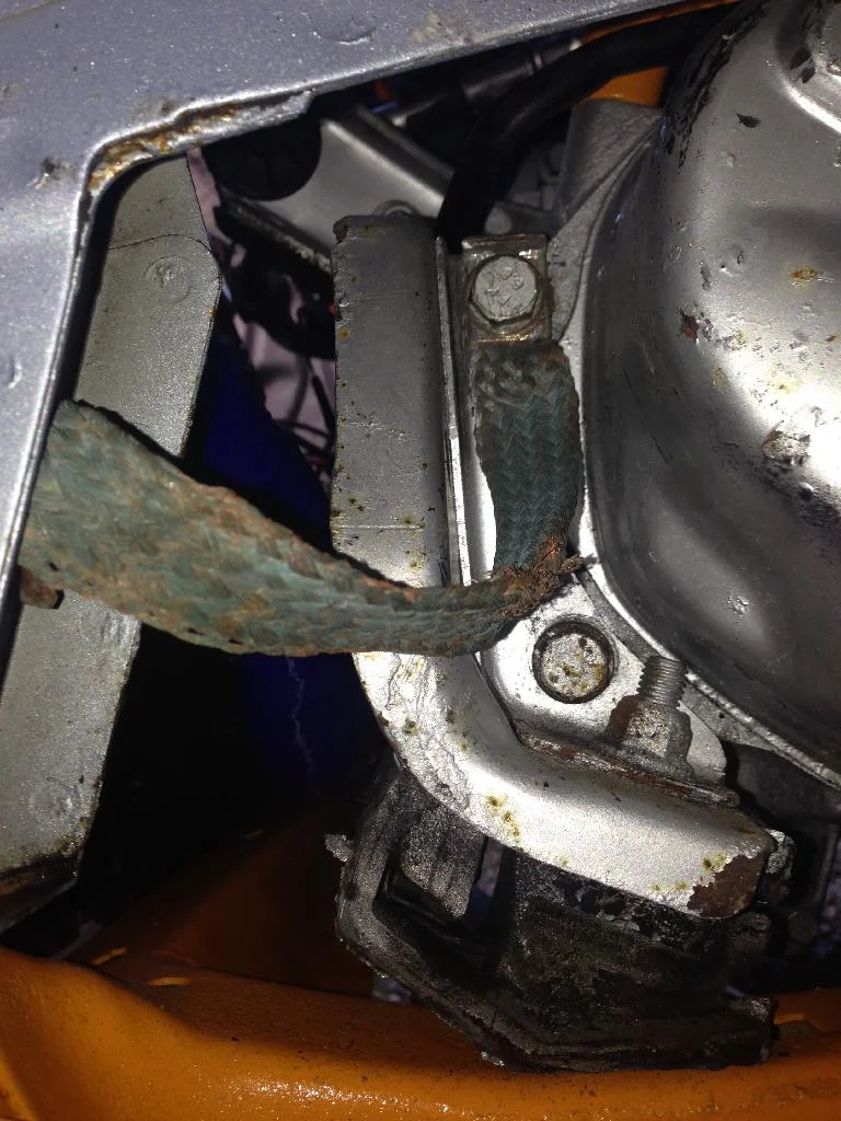

I have just read through a lot of this but cant decide if you sanded down all of the earth hoops and also sanded where they bolt to so that both join faces are shiney clean metal? What happens when you try to turn the key? (click, multiple clicking, whirring, nothing etc)
  clio 172
  clio 172
Yeah I've tried to clean both sides as best I can on all earth points .

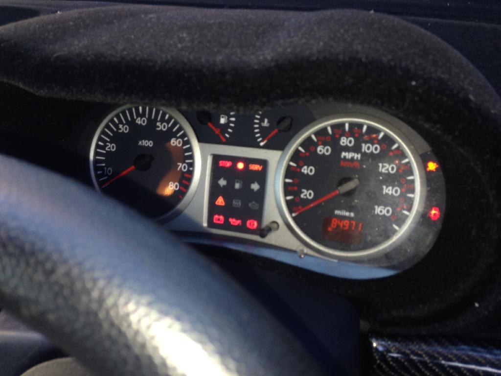

The flashing red light changes to a solid red when you turn the ignition and the stop and serv lights also remain on but it's not even try in to turn over .

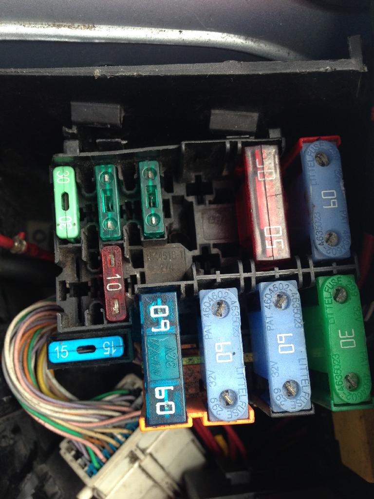

Checked fuses passenger side and had alook at relays in engine bay will have another check and check fuses there also again .

just found that where the 10a fuse is now there wasn't anythink in that slot !
Its now turning over !
Lets see if it will fire up !
  182 ff
got there in the end.... don't forget get some fuel .. ha ,if my car wont start, 1st place am looking now...(10a fuse)
  clio 172
I can't believe there was no fuse there . Must have come out at some point !

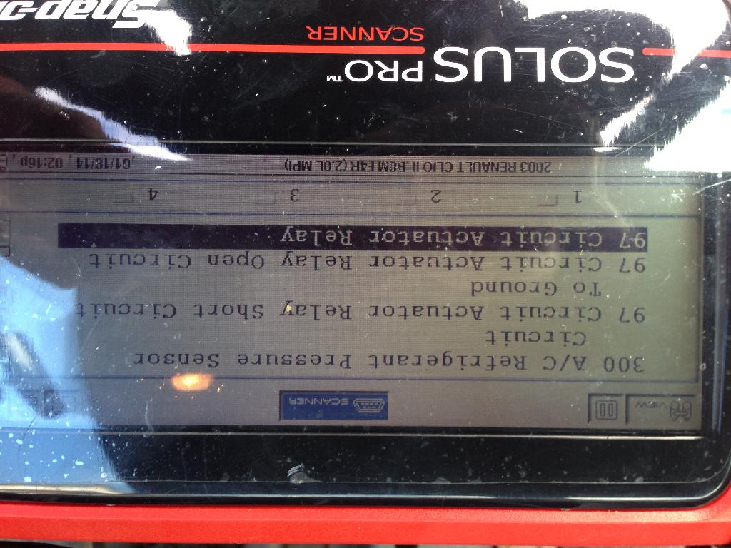

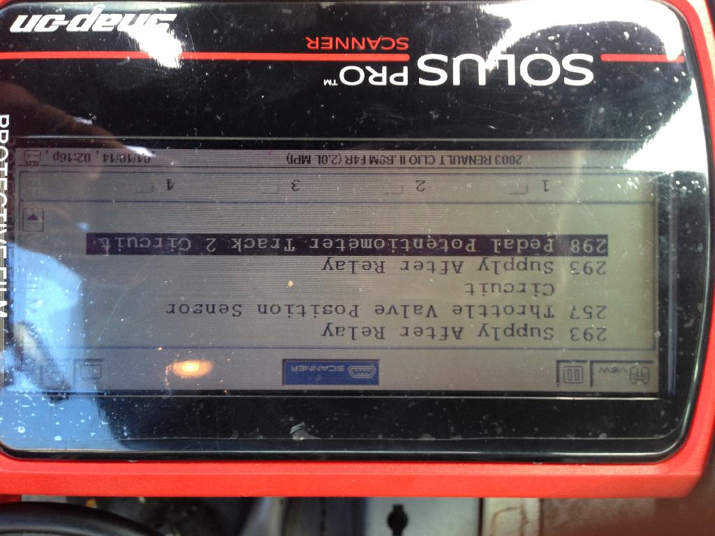

i can't find my diagnostic port.
my car is stripped out and can't find 16 pin connector .
is it actually attached to centre console as that went to the scrap yonks ago but can't find a plug with 16 pins by gearstick !
Diagnostic plug (as long as nothing's been moved) should be under the ashtray at the bottom of the centre console mate. Pull the ashtray out and plug should be directly under it.
  clio 172

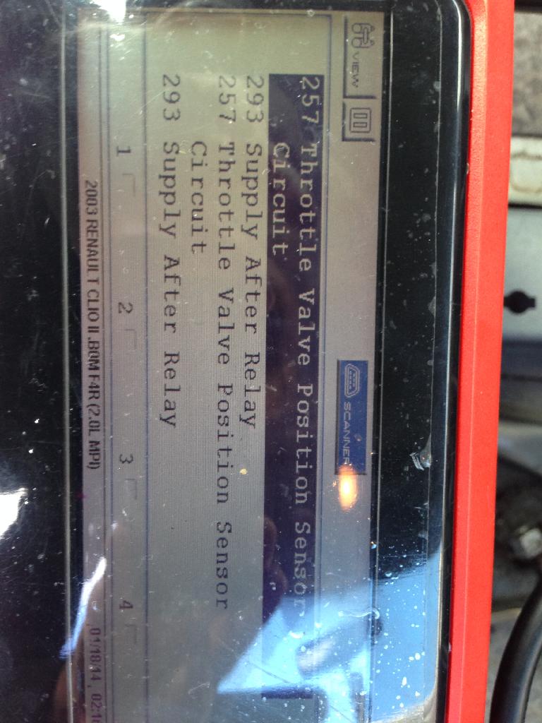

It's a snap on one buddy . I've borrowed it from a mate and I reckon it's probably £2000 - £3000 lol :-/

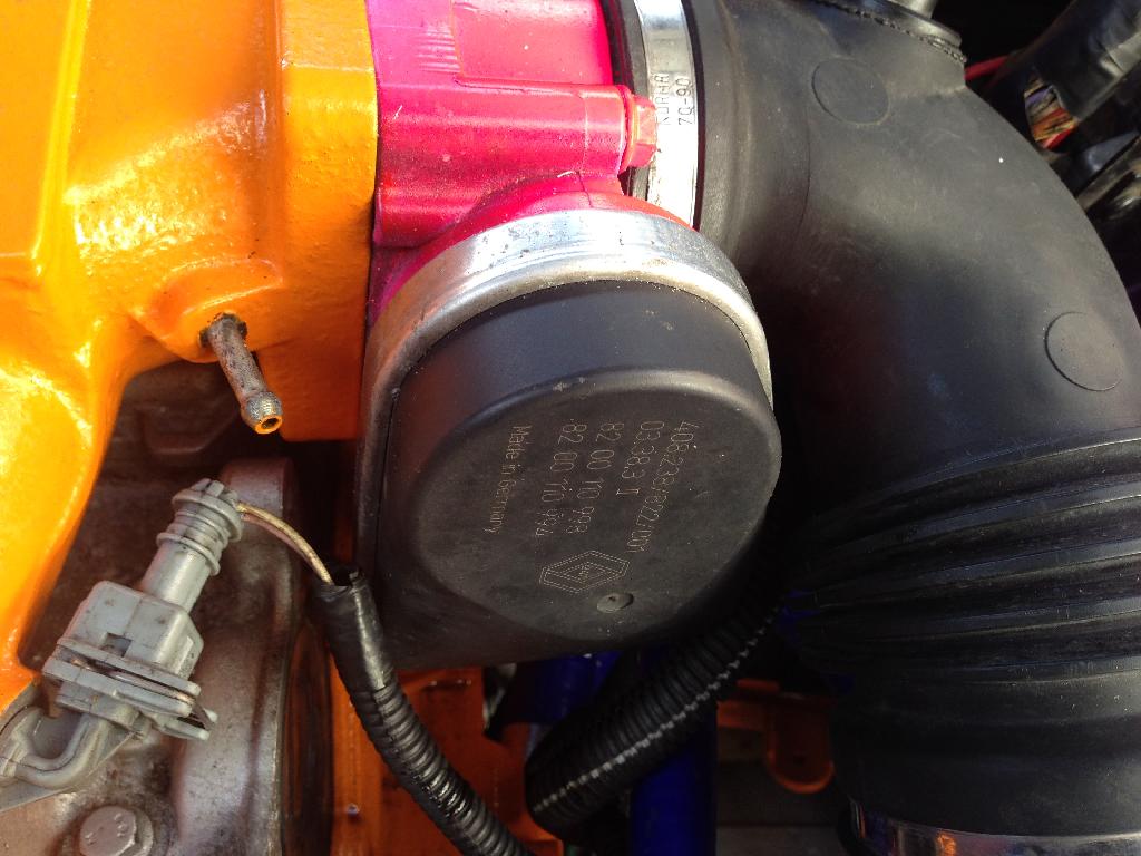

where's the vacuum of here go to ?
  dan's cast offs.

dash just remains with stop and serv but the red light goes out
The vacuum in that pic should go to the Acoustic valve iirc, if one isn't fitted the that vacuum should be blanked off as its sucking in air after the throttle body!

I've got a ignition light on the dash now since checking my coilpack and ignition lead order .

This wasn't on dash before but comes on now on ignition .
would this just be , coil pack or leads or does the square with zig zag refer to more ?
Will have to get code reader again
The light on the dash that looks like a square with zig-zag in it, I think it looks like a hear rate monitor lol. That's the engine immobiliser light/electrical fault light according to my handbook

i now have that on the dash so it's picking up a fault now that wasn't displaying on the dash .
not sure if that's a good thing or not !
  clio 172
No that goes of when the key is turned to ignition.
its turning over but not firing .
The electrical fault light is on but this afternoon it wasn't .

im hoping mark who I borrowed the diagnostic tool of is going to pop around one night NS plug it up as he know how to use it better and check sensors data as I'm struggling !
