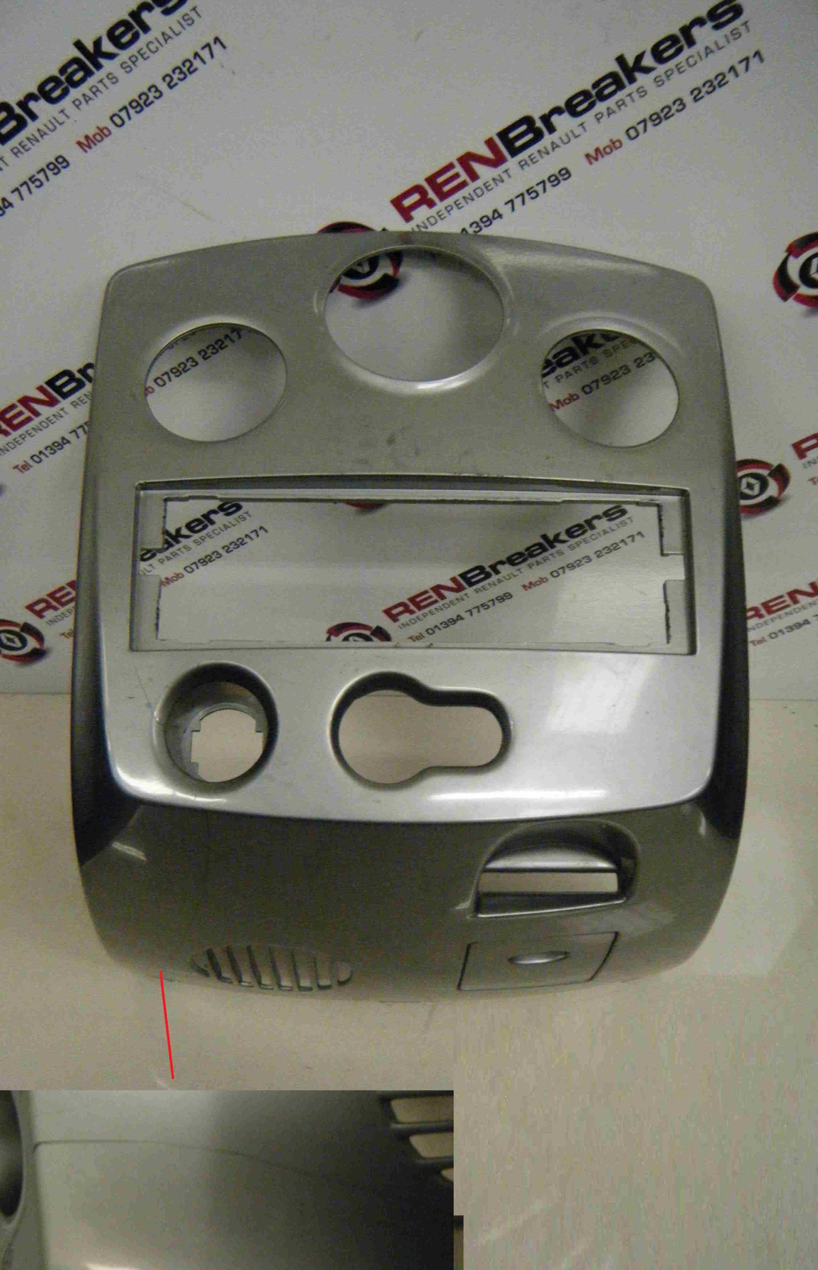

Not weird at all...yours also has a slot for the key, under the start button.
Where abouts? Under the centre console?
