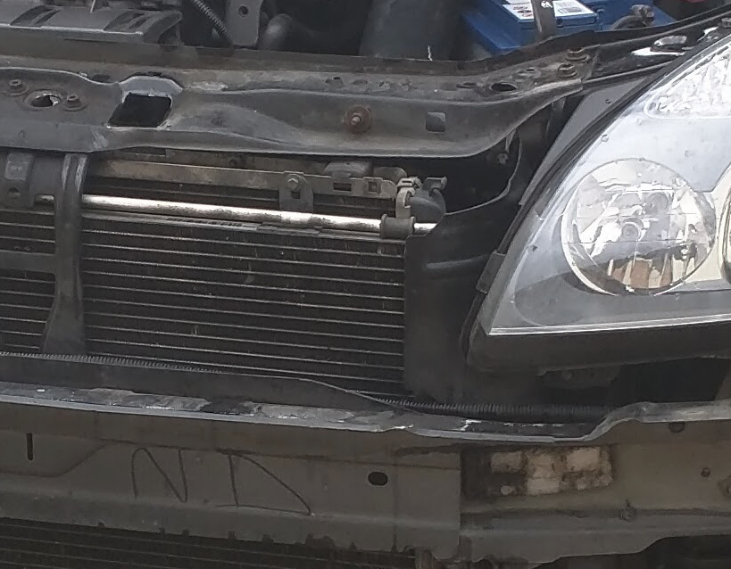

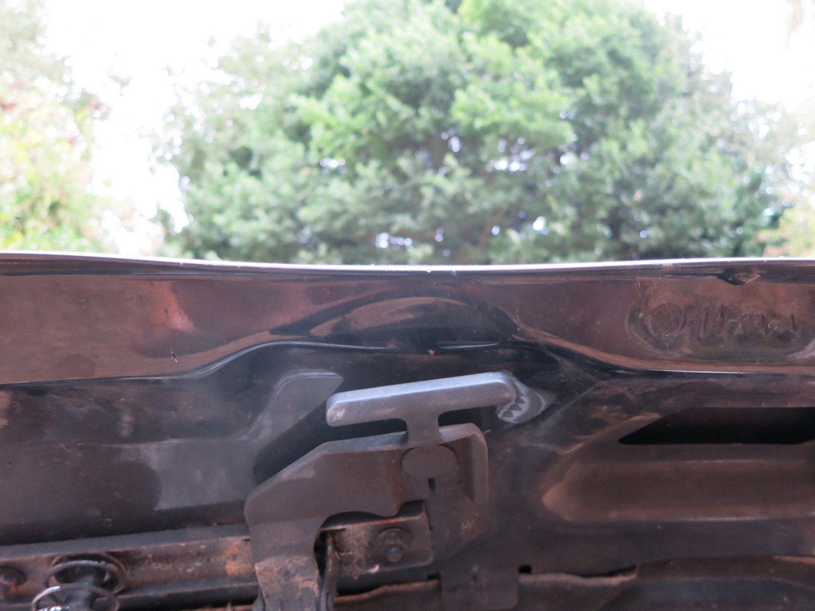

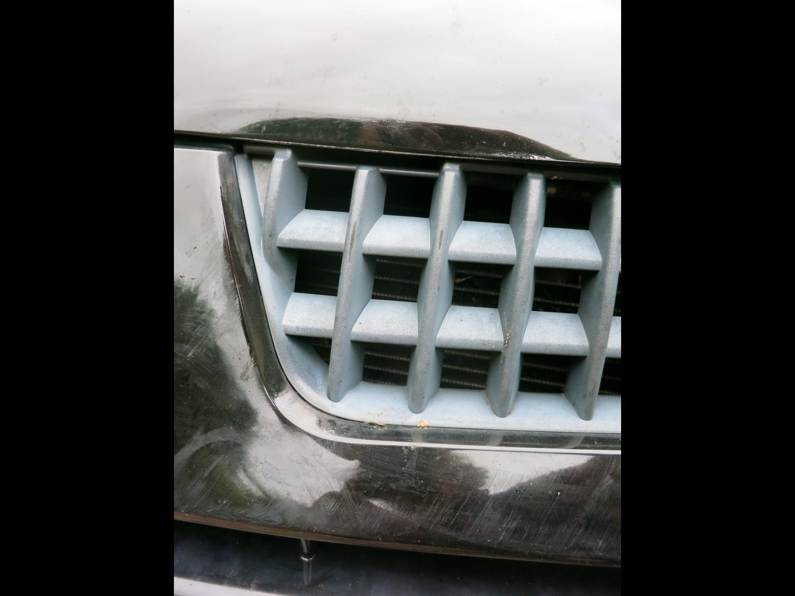

It was raining, I was with our toddler and in a moment of weakness I parked near the entrance when we went to the garden centre. Walking up to the car my heart sank when I saw a piece of paper tucked under the wiper, a request to call a number which was a few digits short. The damage would be considered minor in anyone's book and on my other car (a newer Mondeo) I'd not bat an eyelid, but my 182 is more special. Being black the light makes it show.
I've attached some photos, can anyone say whether this is possible as a DIY fix? It's always expensive when you go to the garden centre, but I've been quote £160 for it. Alternatively, I could buy a bonnet on eBay, but it's the black paint with gold flecks in so I'd guess that would be hard to find and the condition of one on eBay could be hard to tell. Does anyone know if any other models have the same bonnet shape and came with the same black paint with gold flecks?

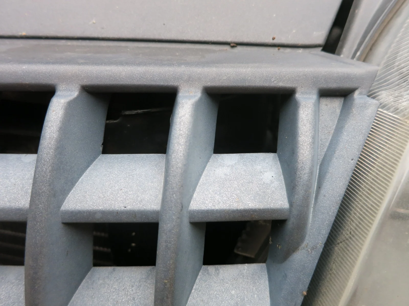

The grey plastic grill pulled back out (~10mm) easily but could someone please confirm that the painted grey metal bit behind the passenger side grill (light end) is supposed to be there. I can't believe it isn't, but it looks a tad funny.

The actual bonnet shape is the same from the 172 through to the 182. The 182 was the only model that came in black/gold. A lot of the bonnets seem to suffer from rust on the front edge on the 182. If you could get a bonnet it is a easy DIY fit. I have done them on my own, but easier with a second set of hands.
Not too sure which bit you are referring too behind the grill so can't confirm if normal or not.

It may be easier to find a decent non-sport bonnet and get it resprayed in Black Gold
Thanks Mbeau. I had a look at the bonnet to see what replacing it would involve and it looks to be four nuts and one hose connector. A difficulty could be that I think it is painted assembled so the paint will have formed a bond?

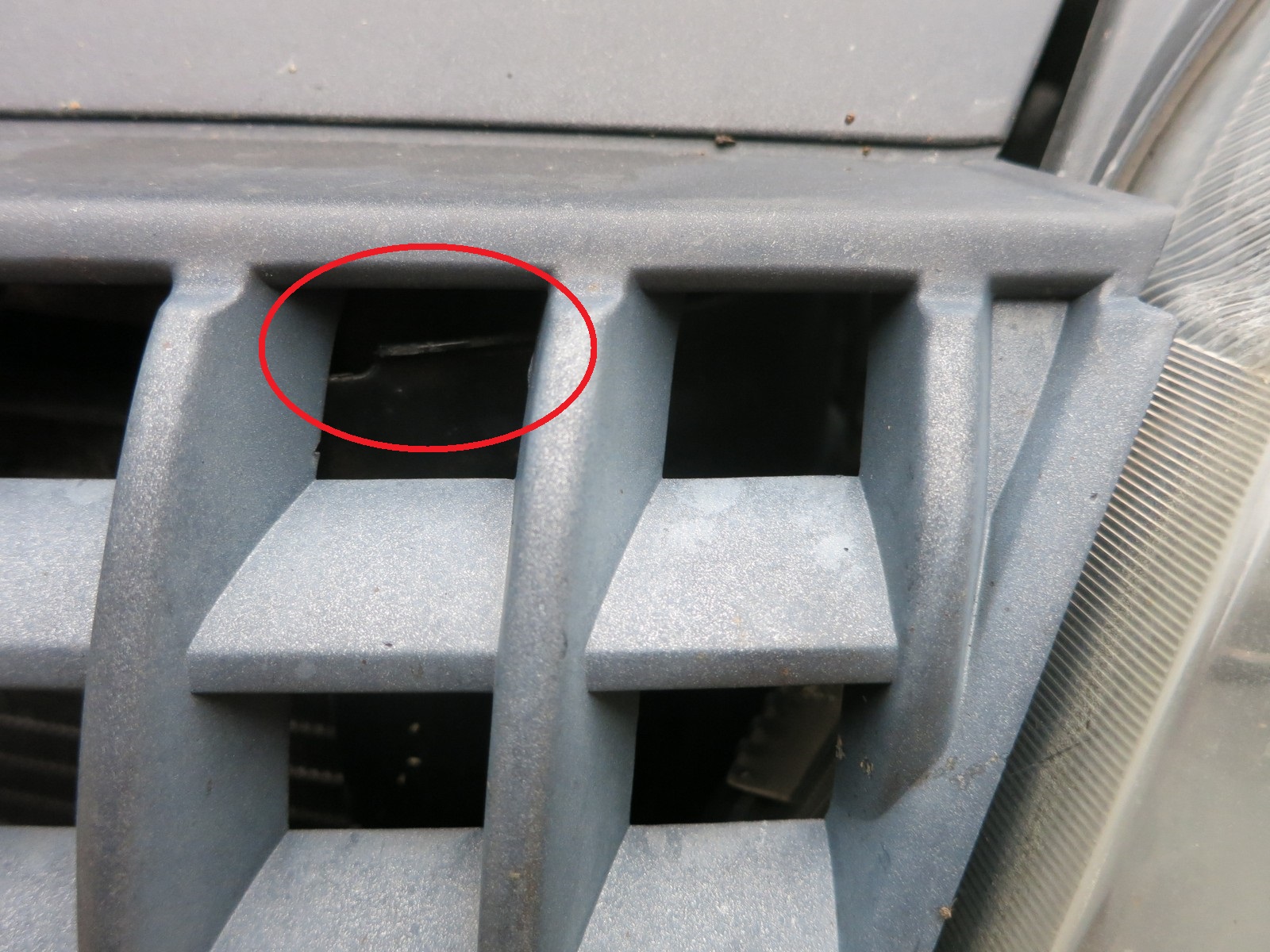

The metal behind the grill is hard to see but circled in the attached photo.
I will have a look at mine in a bit to see if I can work out what that is behind the grill.
Have removed a few bonnets and just the 4 bolts(two on each hinge) and the hose for the washer jets. Then the bonnet has always just lifted off. Never had any problems with them being bonded with paint.

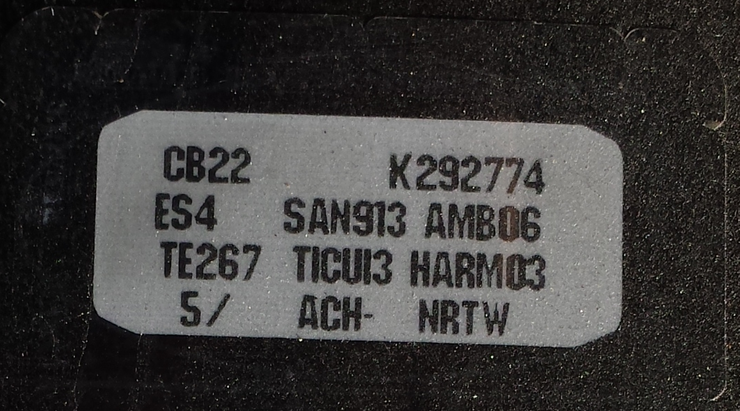

Paint code should be on the label in the drivers door shut. Black/gold I believe is code 267.
Thanks Mbeau, you really know your stuff! Attached is a photo of one of the driver's side door shut labels. So it's the TE267 is it? Out of interest, what are the other codes?
Can't really make it out, but this might help decipher it (from my car)
The other codes are just for things like interior trim level and anything like cup packs and other things specced when the car was ordered.
