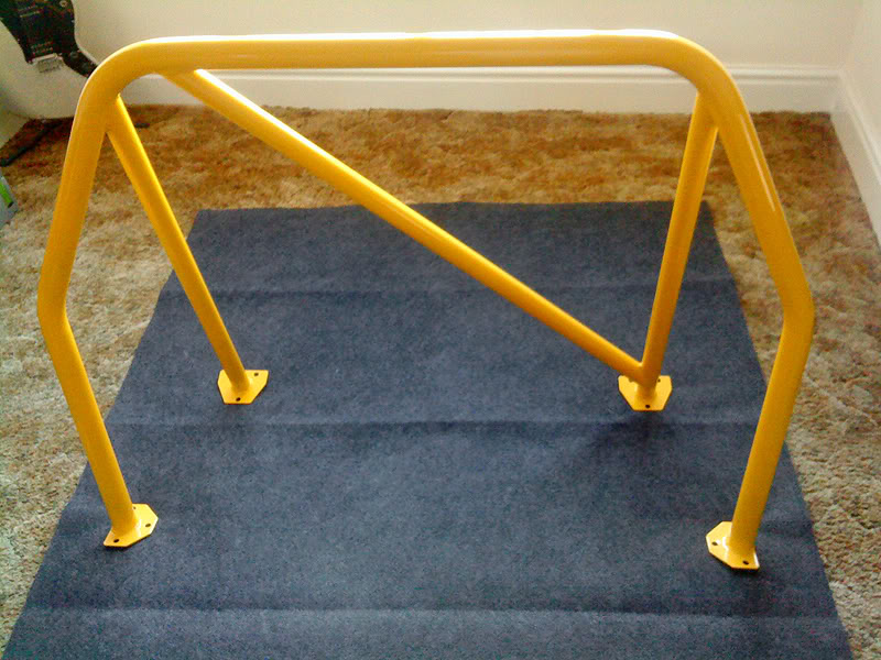

Got the cage painted up ready, got carpet bought... will buy some ply and laminate flooring underlay to cut some sound/knocks out.

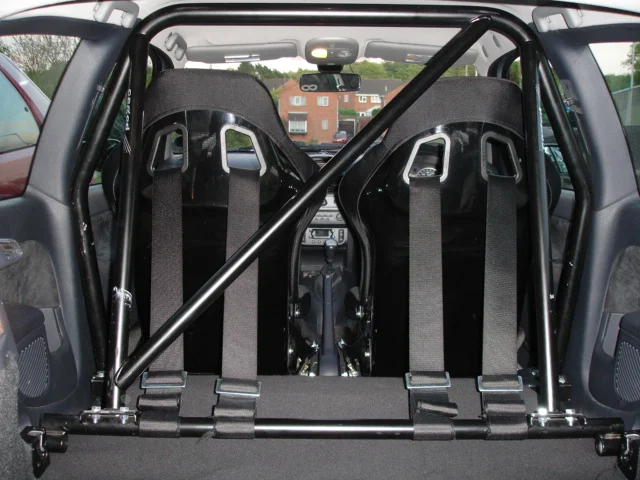

And also would it be acceptable to use the rear part of the baseframe as a harness bar?

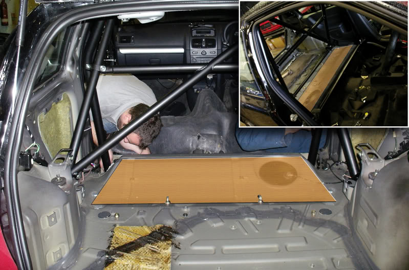

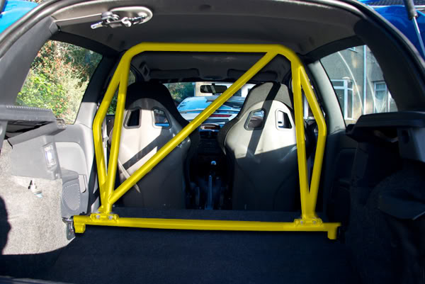

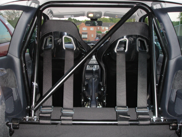

Trying to achieve this;
From something like this;
Using this;

As for the bar, I think most people with the msv cage bolt the harnesses to the floor.

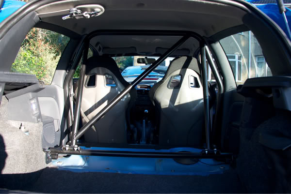

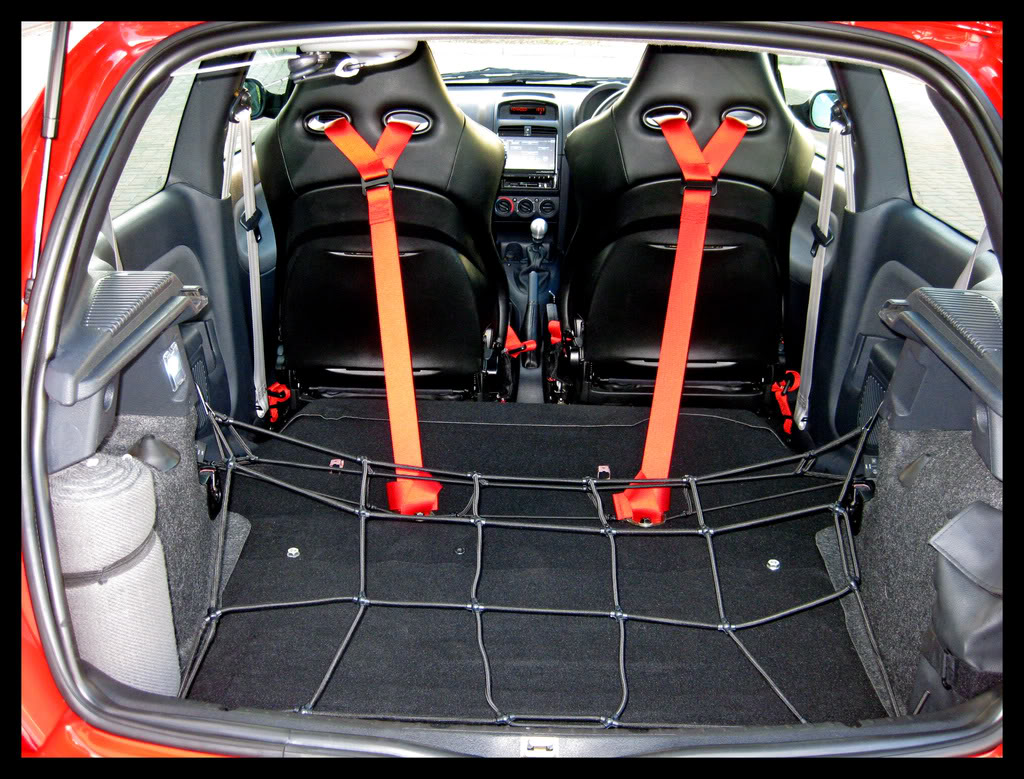

Legend, this pic is exactly what I'm after... although I'd like to know how he's done it (wood etc) and if he's carpetted down the slope bits down each side...

I know mate, but where the seats used to be there is a curved recess, and slopes down the side towards the door cards... not sure how to go about this, whether wood over the main dip will foul on the base for an MSV.
I don't want to sort it all with wood/lining/carpet then come to fit the cage and find it doesn't fit/fouls.
Last resort would be paying an upholsterer/carpet fitted to just flow the carpet to the curves of the rear... I'm not sure that would look good :dead:

Thanks mate, thats a good picture... I don't think woods used there at all as I think I can see a slight dip where the seats used to be, and its flowed down the side slopes. I'm not sure?

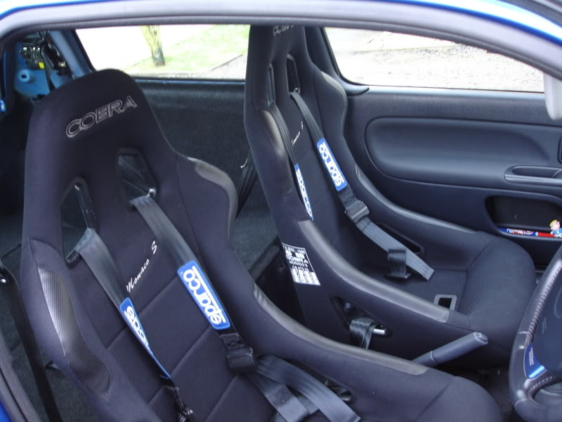

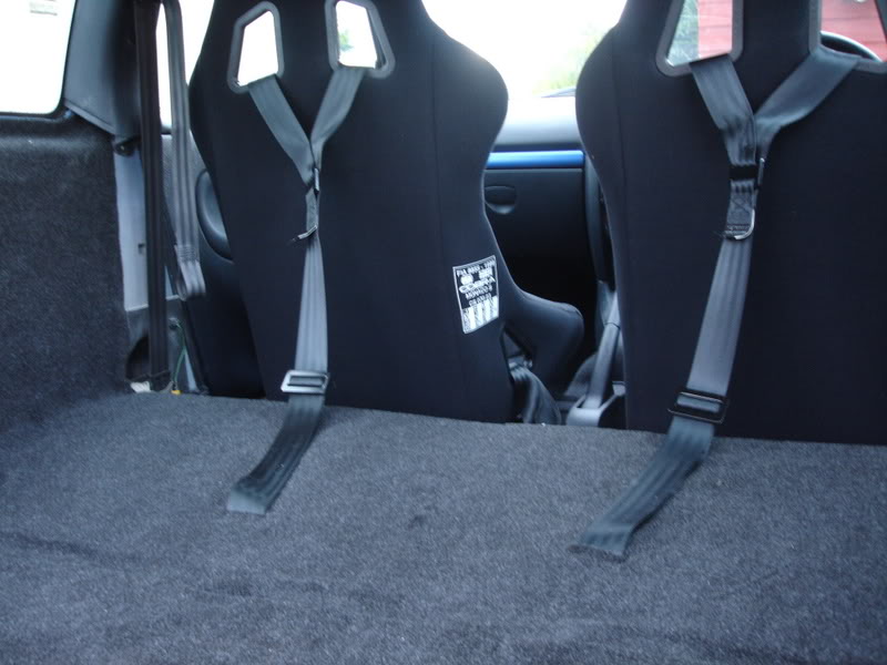

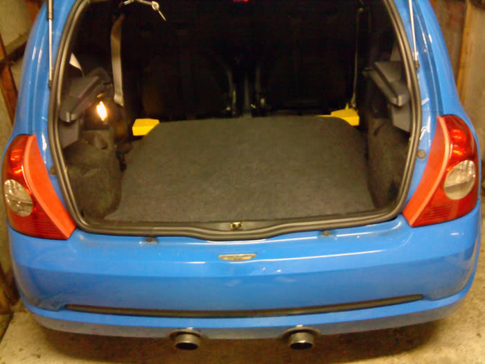

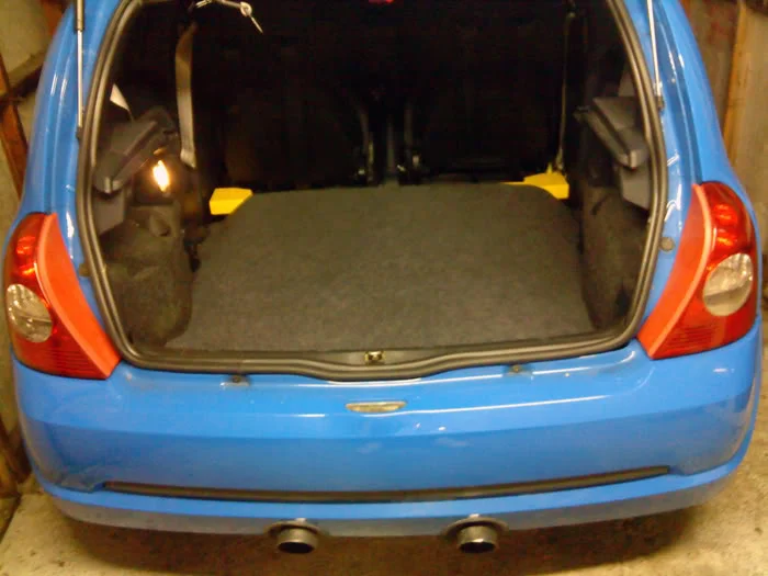

I've done the same as the trophy:
I think it looks fine following the curves, tempted to change the carpet for a lisghtly darker shade though

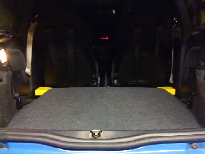

Thanks for that mate, but I still think I'm going to use plywood like this photoshop. Want it to look as tidy and 'OE' as possible...
Hope sm_wrc doesn't mind me chopping his pics haha

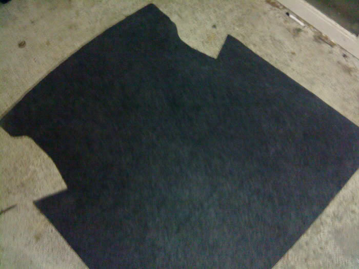

The way I did mine was:
1) Old cardboard box cut a little bigger than the width and length needed
2) Bent the cardboard in and around the parts in the back of the car and then use a marker pen to mark where the bends are
3) Get a stanley knife and cut out the template, cut outside of your marks and then take bits off at a time
4) Get a nice thin sheet of ply wood (very light) about 4mm thick
5) Stick the cardboard template to the wood and draw around
6) Cut the wood
7) Now you will find that you can't get the wood in as it's too big so get the cardboard template, put it back in the car and mark a line where the seats fix into the side of the car (metal plate that allows the seats to fold up/down)
8) Using the template mark on the wood and then draw a line from one side to the other, cut along this line and now you will have 2 bits of plywood.
9) Now you will be able to test fit both parts in the car and make changes where needed.
10) Cover the 2 bits of wood using a good acoustic cloth (sub box material) in whatever colour you like.
11) Put the 2 bits of wood back in to the car and if done well it will all sit nicely

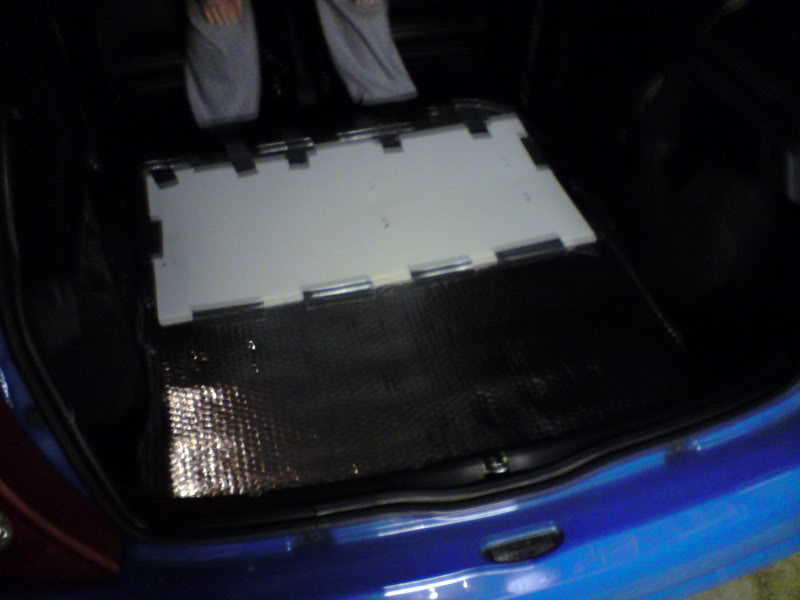

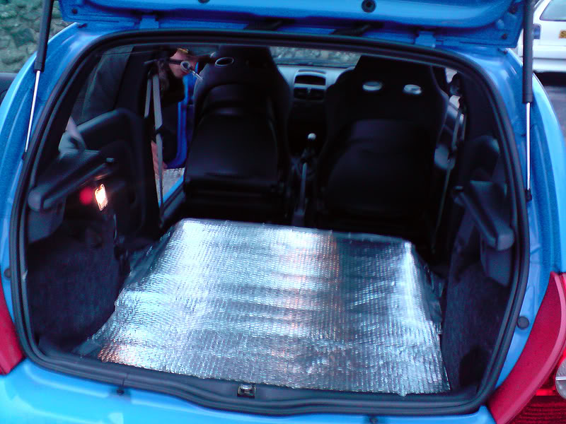

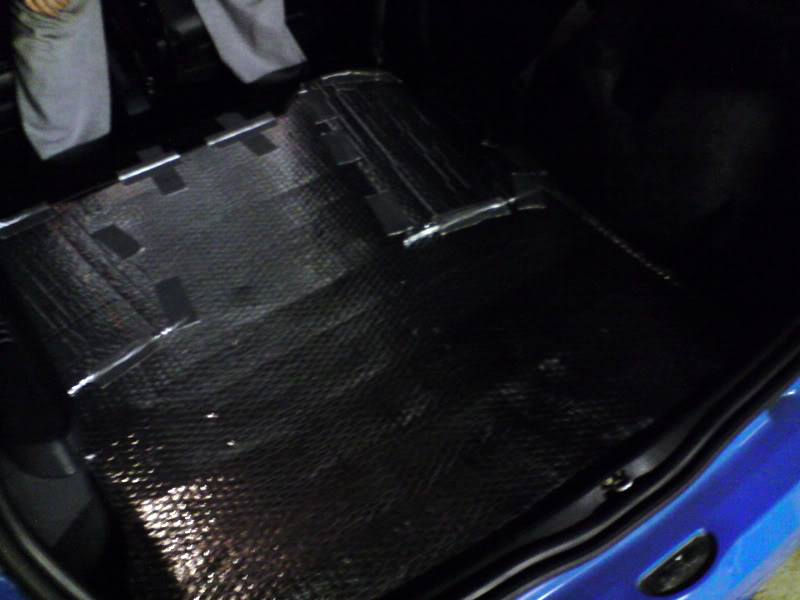

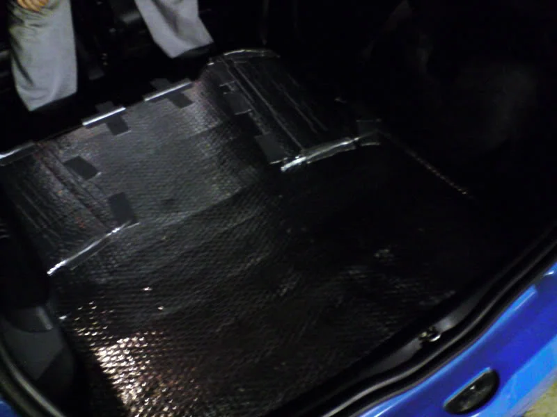

Was just plastic corrugated stuff like For Sale signs mate, weighs fook all... as does the insulation stuff its just bubble wrap in foil basically!
