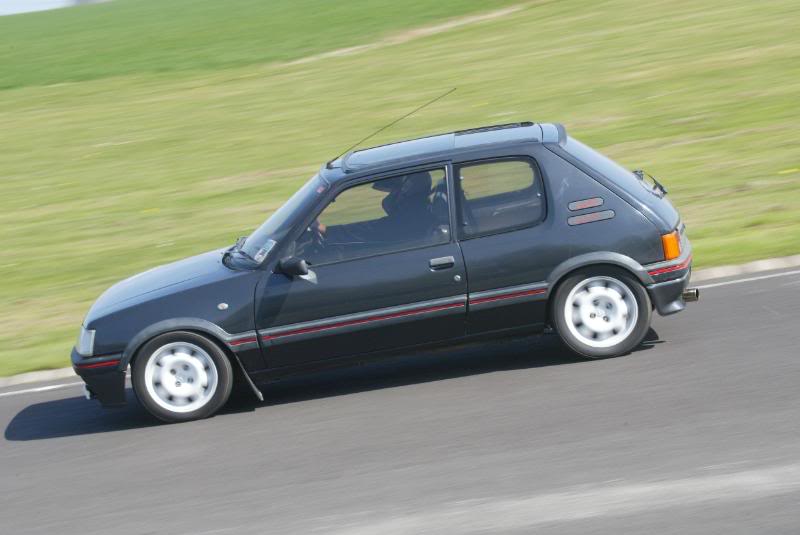

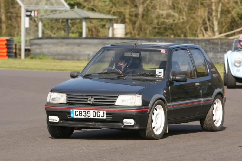

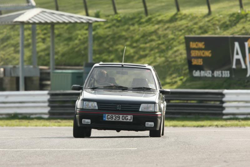

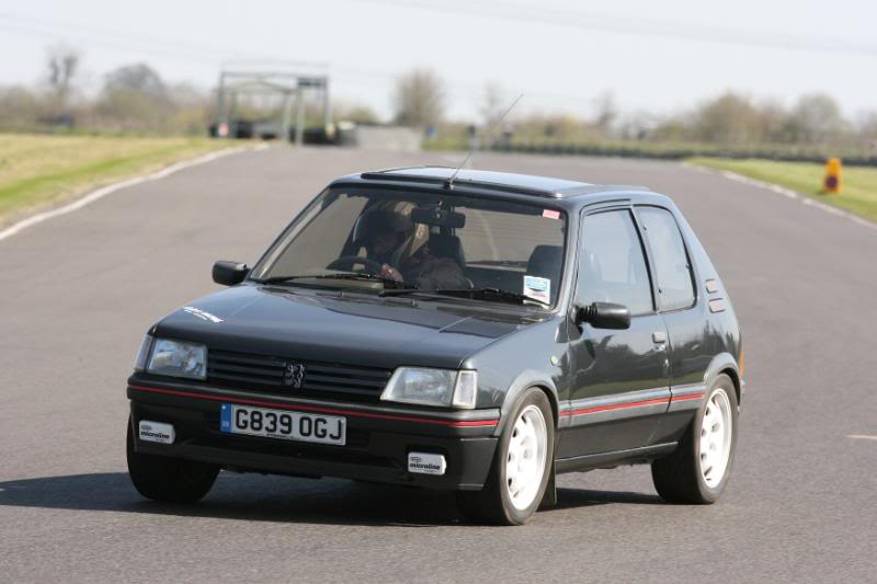

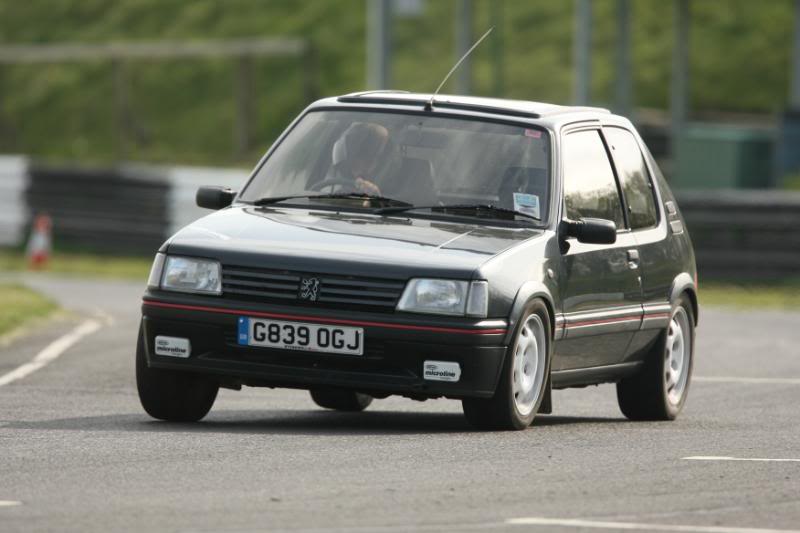

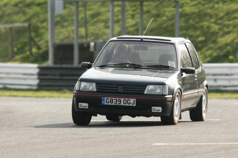

After all the setbacks we had the gti came up trumps. It got me to castle combe and back and did 200 miles on track in between without any major problems. All the little niggling doubts I had when I arrived and saw cars faster/more expensive went after that first session on the track. I couldnt believe how much fun it was. I was grinning like an idiot all day. And my little gti made a good impression with the other drivers. Alot of "what engines in that then, its fairly flying". Had such a great day and my list of plans for it has got longer. Time to find a second job I think!
Thanks for reading. Dont think Ive ever written so much on here before, hope it wasnt too boring! Heres the pictures from the day.
