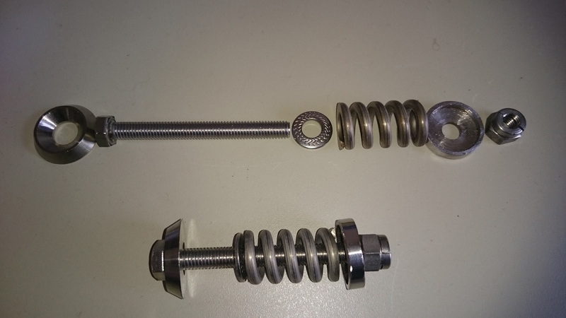

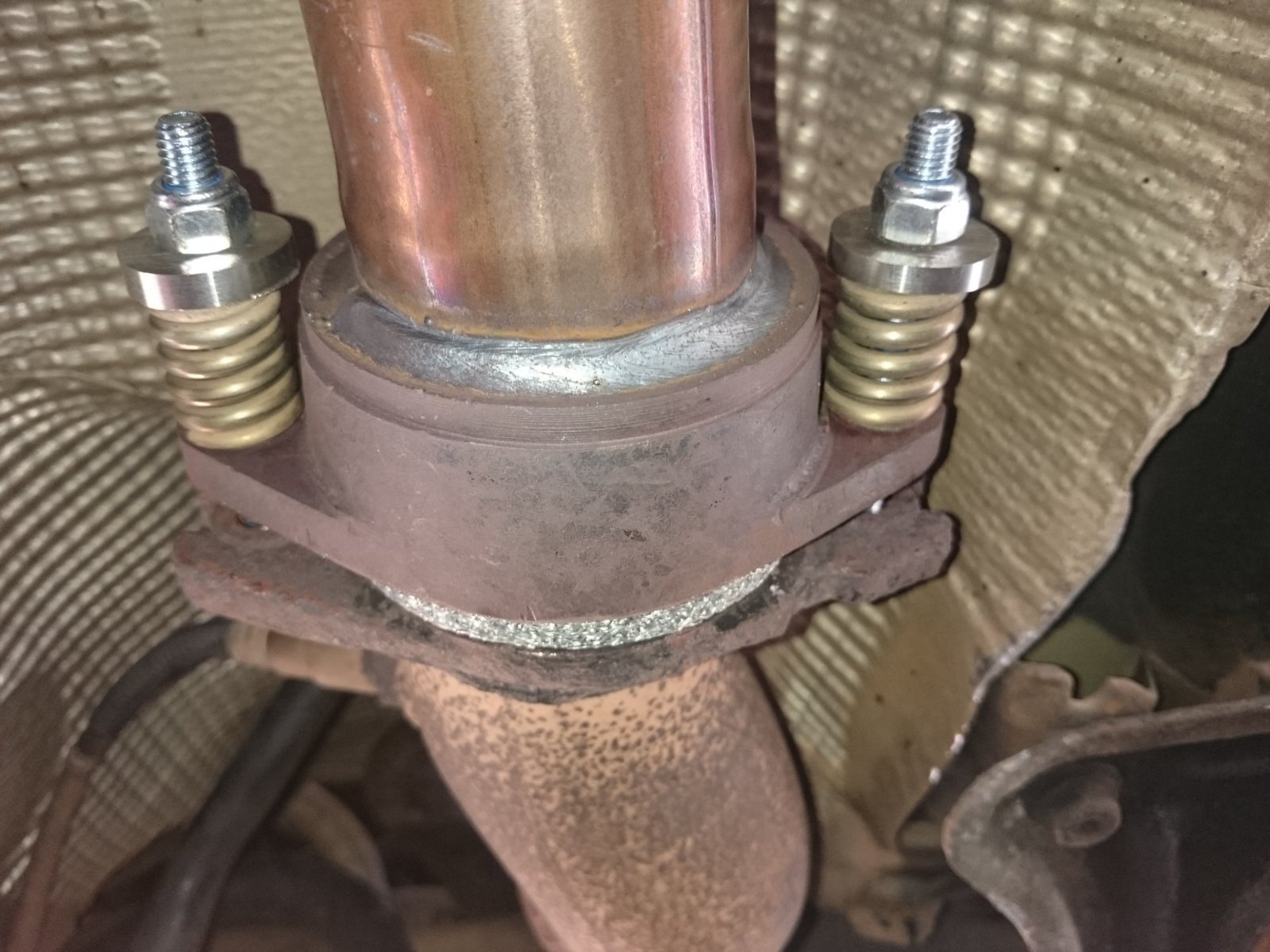

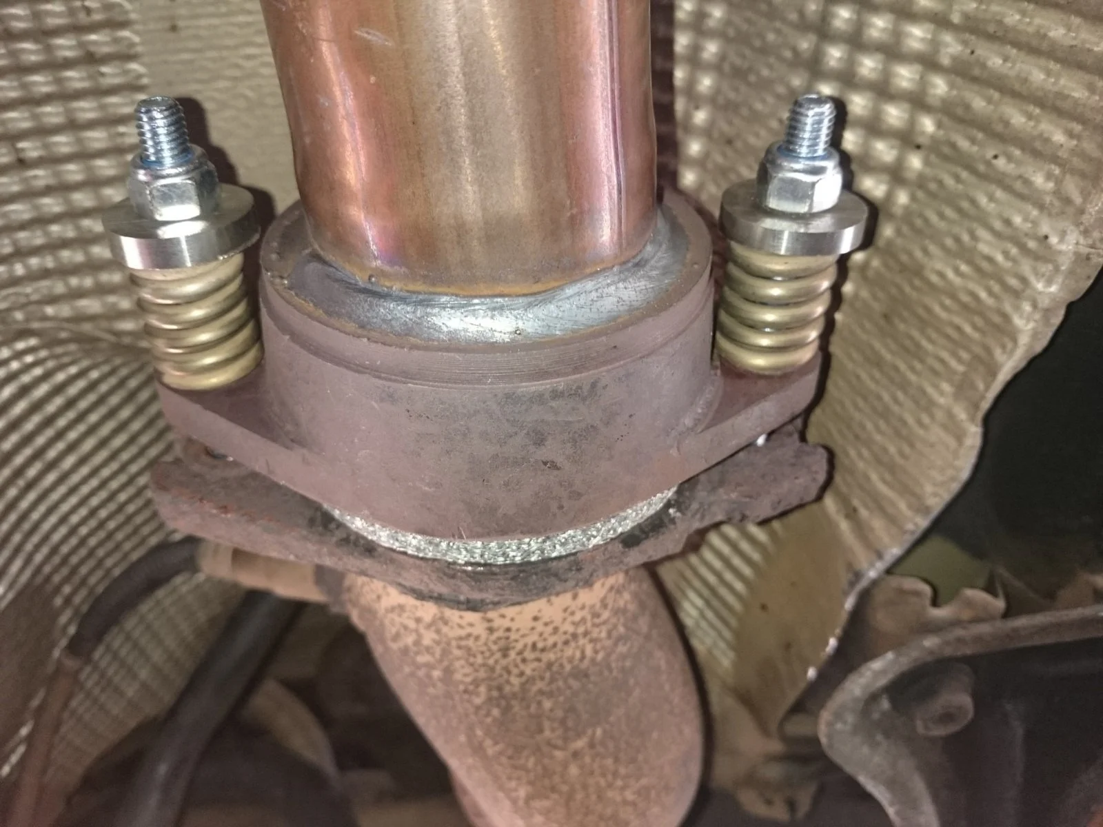

Having owned my 182 for 10 and half years and going through God knows how many fitting kits because they rust away within minutes I thought I'd have a go at making an alternative using all Stainless parts .
I don't know if anybodys interested , but there are the parts I used
M8 x 75mm stainless bolts
http://www.ebay.co.uk/itm/201443036339?_trksid=p2055119.m1438.l2649&var=500622995977&ssPageName=STRK:MEBIDX:IT
M8 stainless locking nuts
http://www.ebay.co.uk/itm/M2-5-M12-...hash=item35dbf833c0:m:mxSIktvYrUW7ObGElLKvYTA
M8 x 25mm stainless countersunk washers .
http://www.ebay.co.uk/itm/A2-SOLID-...W-CUP-WASHERS-CSK-SOCKET-METRIC-/360796868434
M8 serrated washers.
http://www.ebay.co.uk/itm/201466471743?_trksid=p2055119.m1438.l2649&var=500646180121&ssPageName=STRK:MEBIDX:IT
I used the original springs and had some stainless end caps for the springs made at work.
Time will tell if they last . Surely It can't be any worse than what Renault have to offer. Fingers crossed :tongueout:

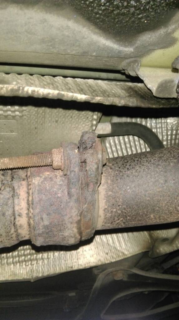

How's this setup holding up mate? I'm replacing my cat soon and this join is in sh*t state.
Sent from my HTC Desire 820 using Tapatalk
It's spot on mate . I still get the occasional blow from the olive joint to centre section end , but the manifold end is fine . It should outlast any Renault kit with it being all stainless and it's certainly hell of alot stronger .
Won't end up looking like this then! Whoever installed this one last time around forgot the springs and the joints suffered!
If it ever had, it's long worn away so defo getting stripped down and starting again!
Looks a proper bodge job :astonished: . Doesn't look as if a gasket was ever fitted , just a nut and bolt . The parts I put a link up for should sort you out no problem , you'll just need to source a gasket . I already had one from a previous kit , although the old one wasn't actually that bad when I took it off .
Was going to say you should be able to see the gasket between the cat and manifold.

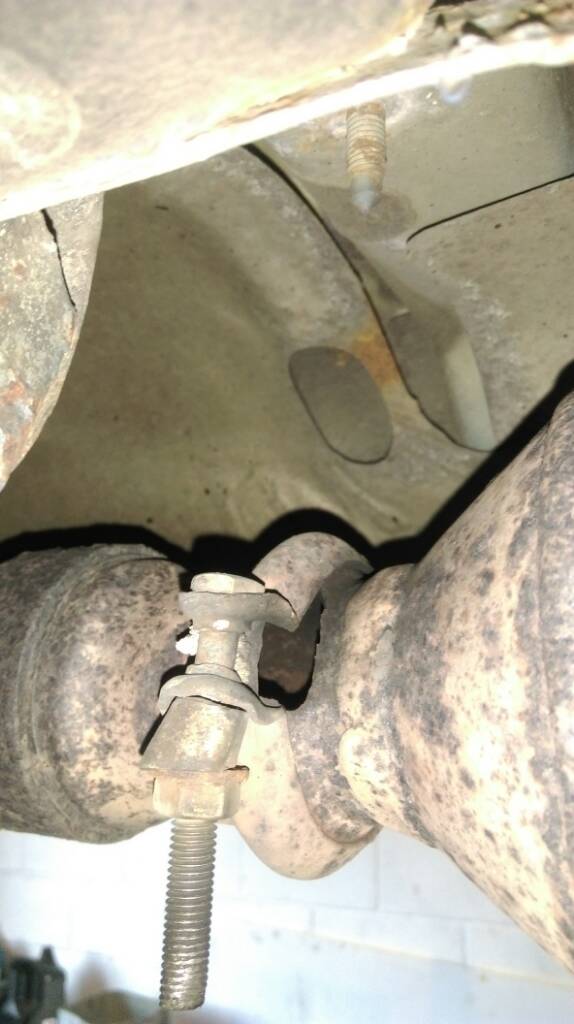

State of current cat just for everyone's entertainment:
Only bought the car in October and already pumping money into it as it's been neglected for too long [emoji15]

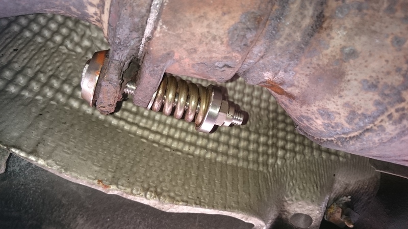

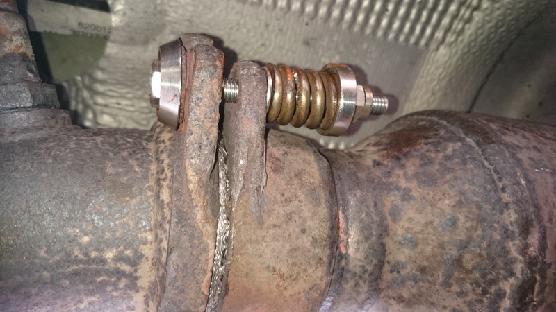

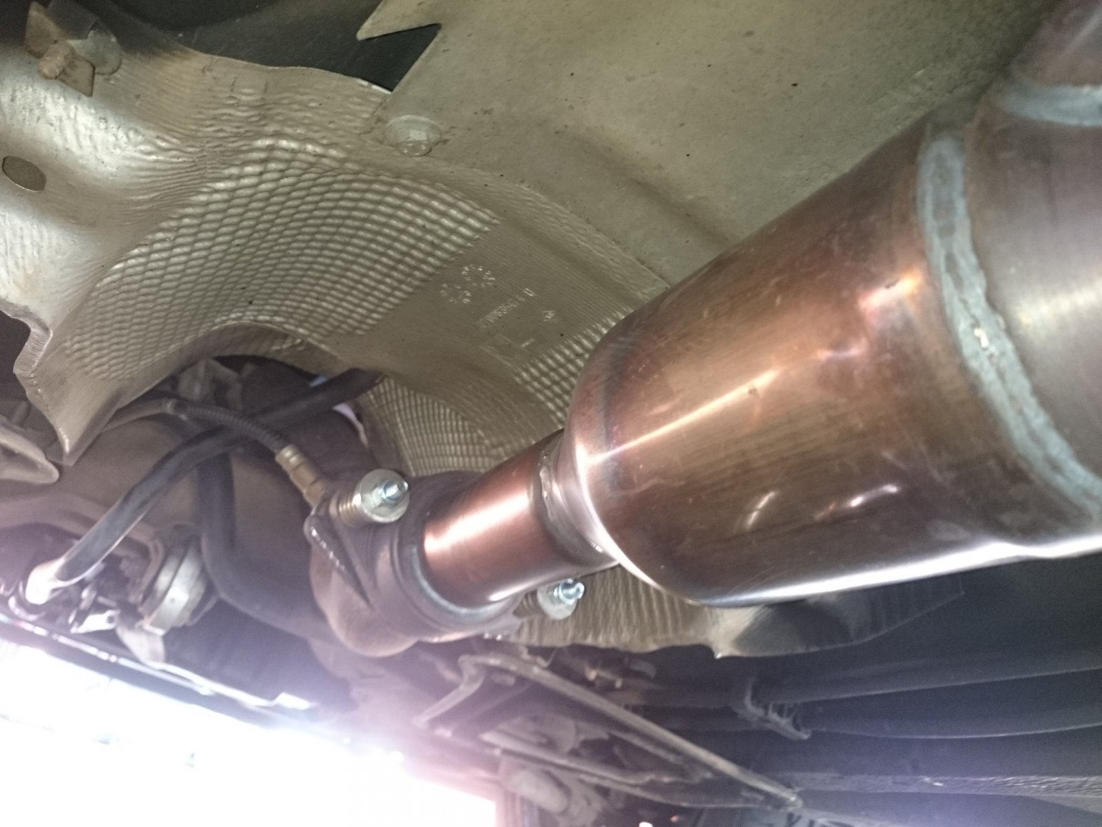

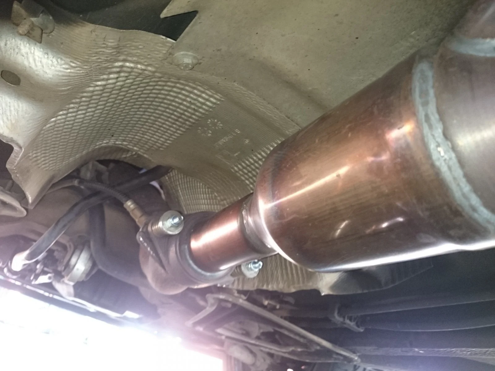

Surprised this kit didn't attract more attention, ive fitted near enough all of the components above and the joint is so much stronger and saves having to continually replace with the full kit. Top work and appreciate all the advice ;)

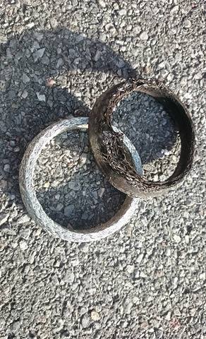

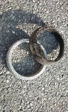

Managed to get the full kit fitted today and used a 2.5" donut gasket from my local motor factors for £3.
Pictures added to show the results.
I followed MRBILLYUK's advice and went for the M8 75mm bolts and locking nuts with his custom made spring 'cups'. You can easily use the original cups and just drill a bigger hole to slide over the bolt but it doesn't look great. The whole setup is then much more durable and only £3 for a gasket rather than £22-£30 depending on your dealer cost for the whole fitting kit which are very weak.
