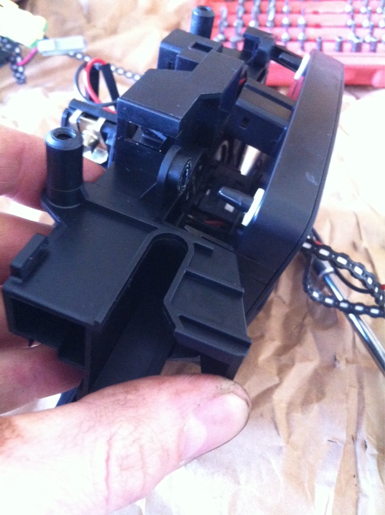

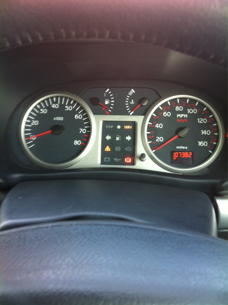

Hello fella's. Got round to fitting my cruise control today. I had to separate the squib to fit my indicator stalk it came with one on and everything taped in place and as the lad said he couldn't remove it I thought I'd give it a shot. I am now regretting my decision I now know it was taped up for a reason something to do with the steering angle sensor. I now have ABS, serv and ESP lights on my dash. How do i fix this problem?

I've bridged the clutch switch and the abs lights has gone. I've just got the esp and serv light on.

I'd accidentally used the old angle sensor on the new squib. The little lugs on the old one which lock it on the wheel had broken off meaning the wheel moved but the sensor didn't so it was registering as being out.
