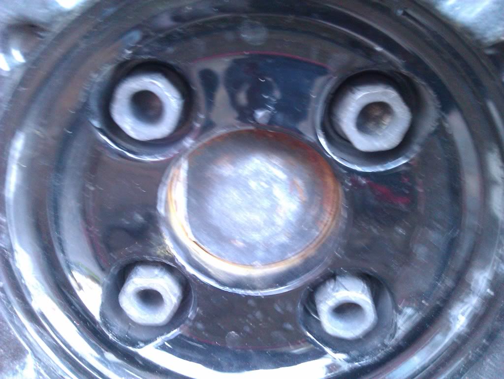

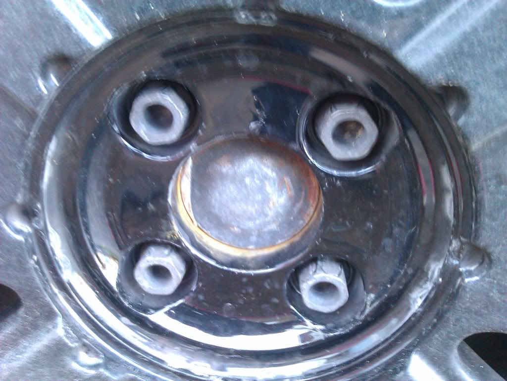

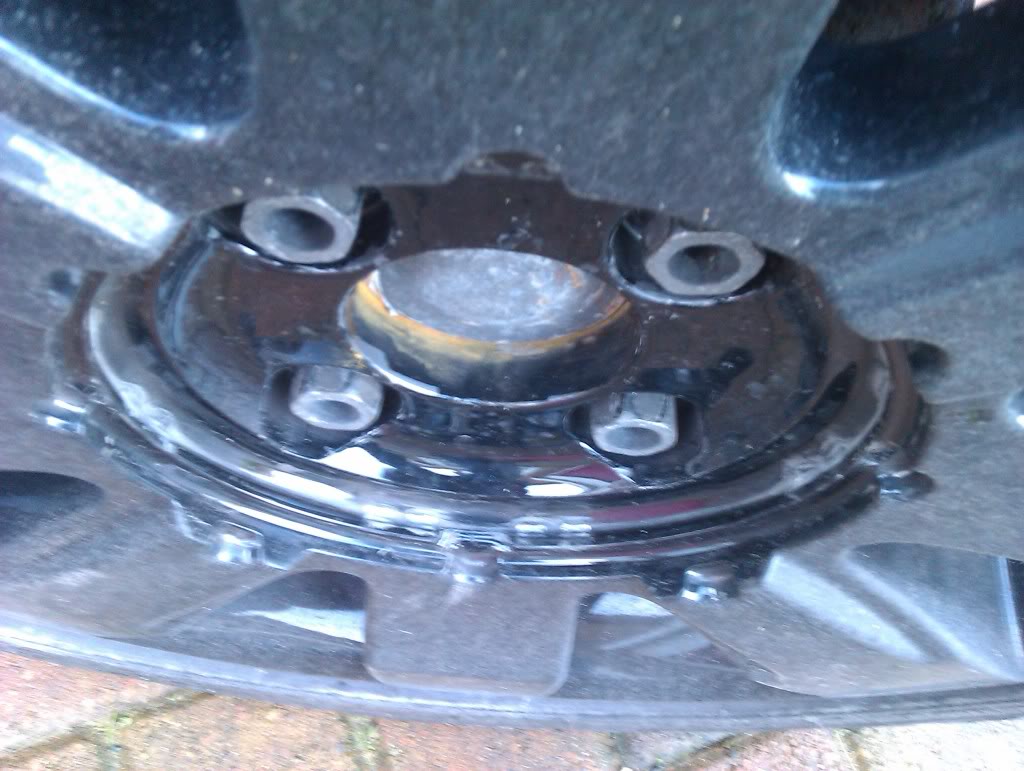

ok... so i got some pics of how far through the centre spigot is on my 182 alloys, ill get some on my steels to see the difference if you want?
excuse the HTC pics...
does this look reet to you?
think on left side is gaffer tape which i used to align the spacer...
Personally I'd say they are more for alignment than anything else. It makes it easier getting the wheels on but apart from that they don't server and real structural/safety purpose.
The spigot ring should fit tight and flush inside the centre bore of your wheel and should just fit snug on the cars centre hub.
A spigot ring is fitted to reduce the bore of the alloy to fit the cars hub. This helps when fitting your wheels as they fit tight and help in alignment as mentioned.
You should be looking at 60.1 hub for a clio i think (i know my 172 is) and whatever the inside circumference of your alloy centre bore is. For example 72.6 - 60.1.
