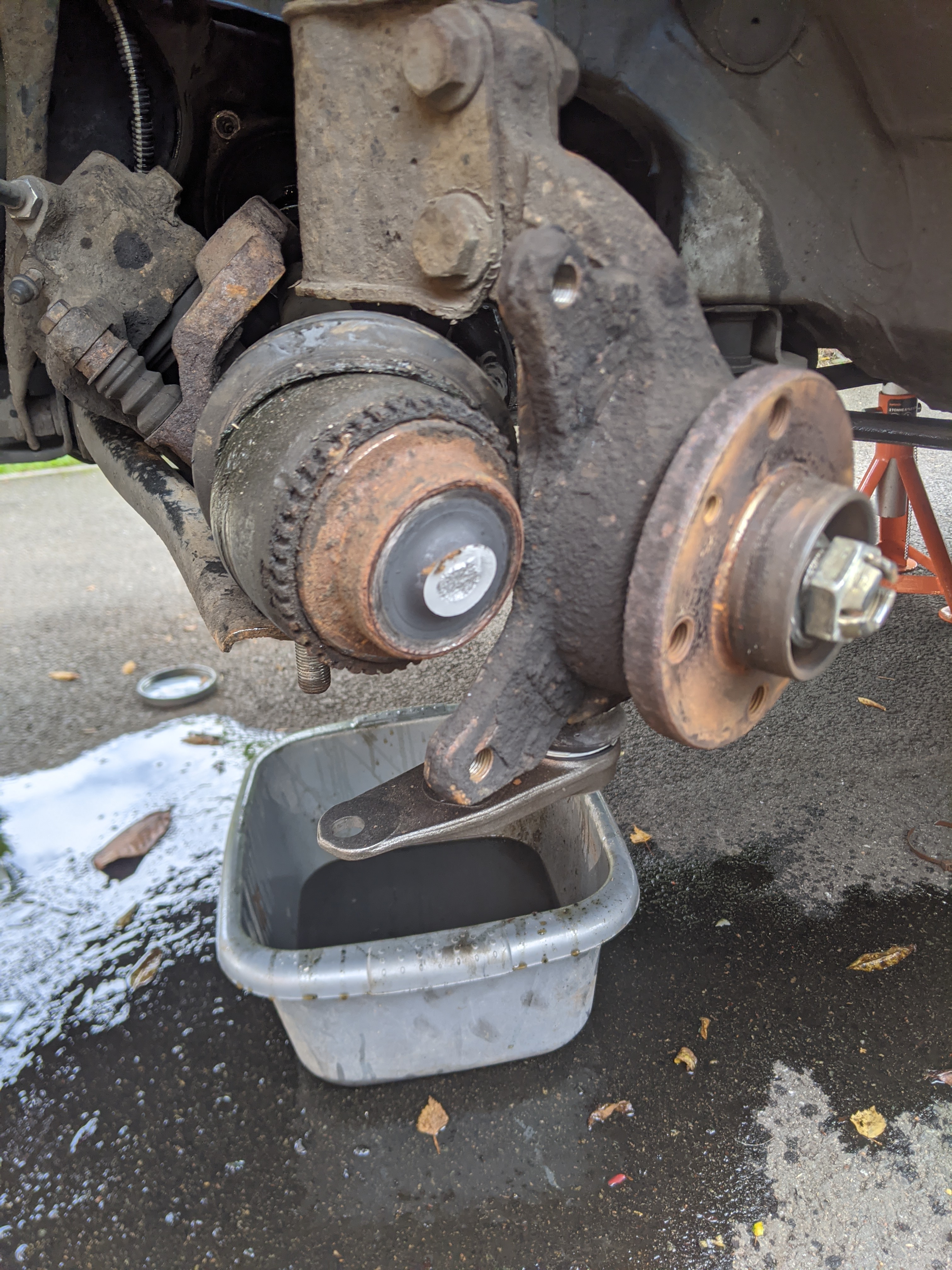

When I was 17, 16 years ago!, I pulled the pass side shaft out not realising the box oil would empty on the floor, there is no sign on the garage floor that it ever happened, but when I lie on the floor under the car at that same area I still smell it!
I was changing over to roll centre hubs and dealing with a siezed driveshaft managed to pull the driveshaft out the gearbox. Oil everywhere. Luckily it was on my brother's drive. Everytime I went round you could still smell it. He's moved on and now just his ex there. Couldn't have done it to a more deserving person 🤣. She was horrible.

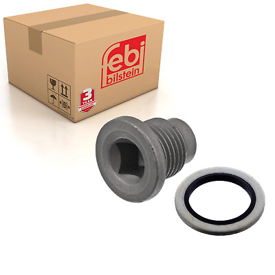

I'm planning on changing the gearbox oil in my 182. Just wondering if the gearbox oil drain plug is the same as the engine oil drain plug [link below] and if not, whether anyone would have the part number for the drain plug washer as I'd like to swap that while I'm at it.
Massive thanks in advance.
JamesBryan
Yeah same 8mm square.
The washer on the gearbox is a copper crush washer, can find them cheap in kits or individual on ebay.
Look for M16 copper crush washers.
