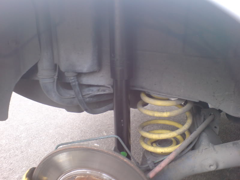

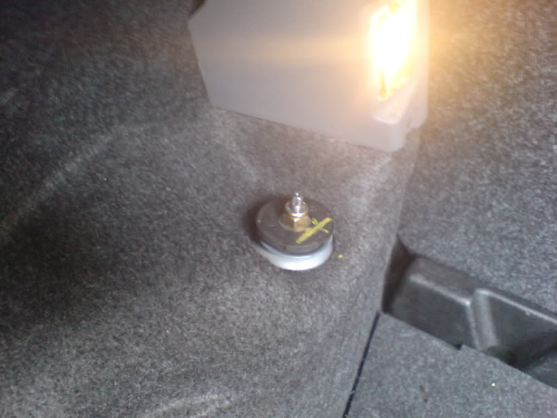

You may need a small adjustable spanner/vice grips to use on the flats on the top of the shocker/damper rod (the chrome rod coming out shock absorber) turning when removing the top cap and nut.
