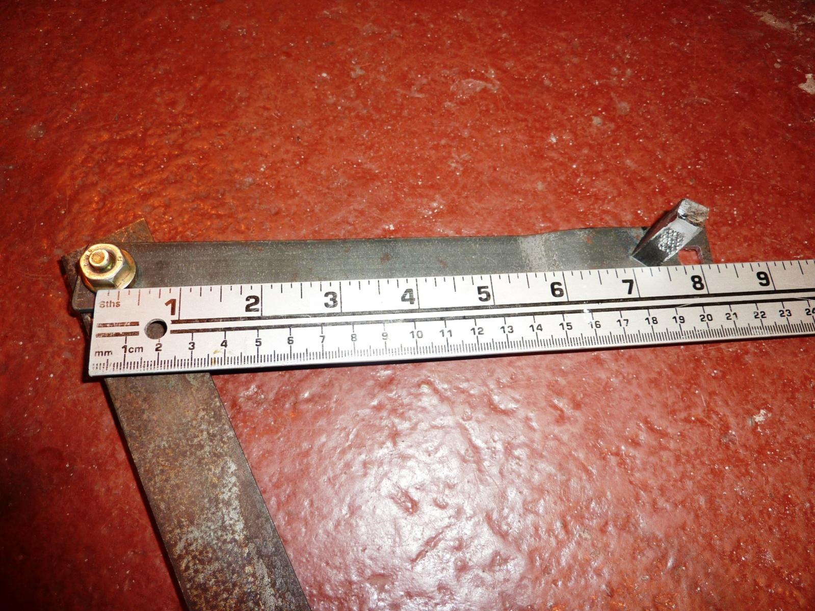

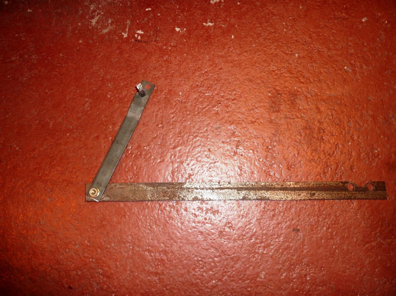

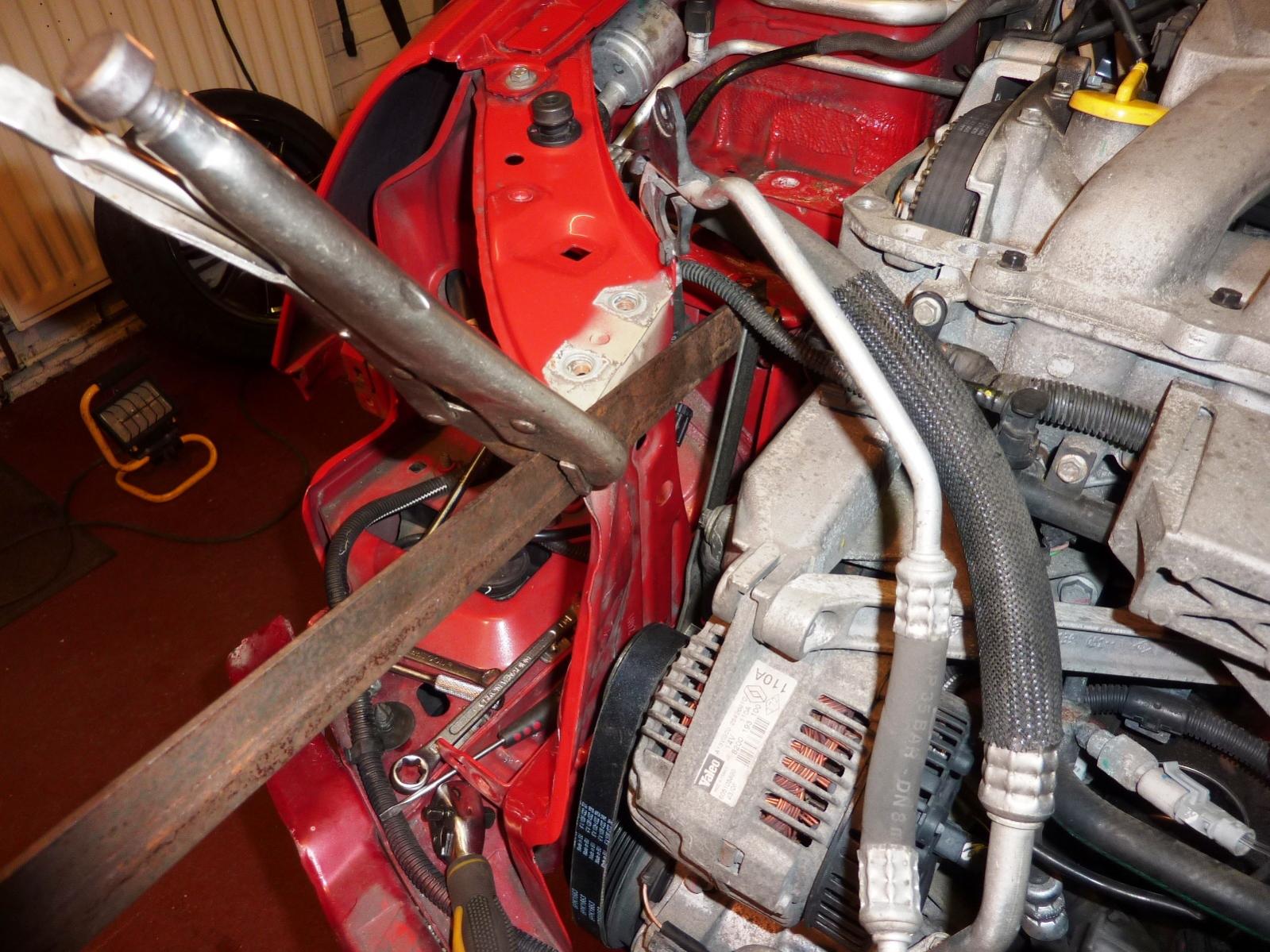

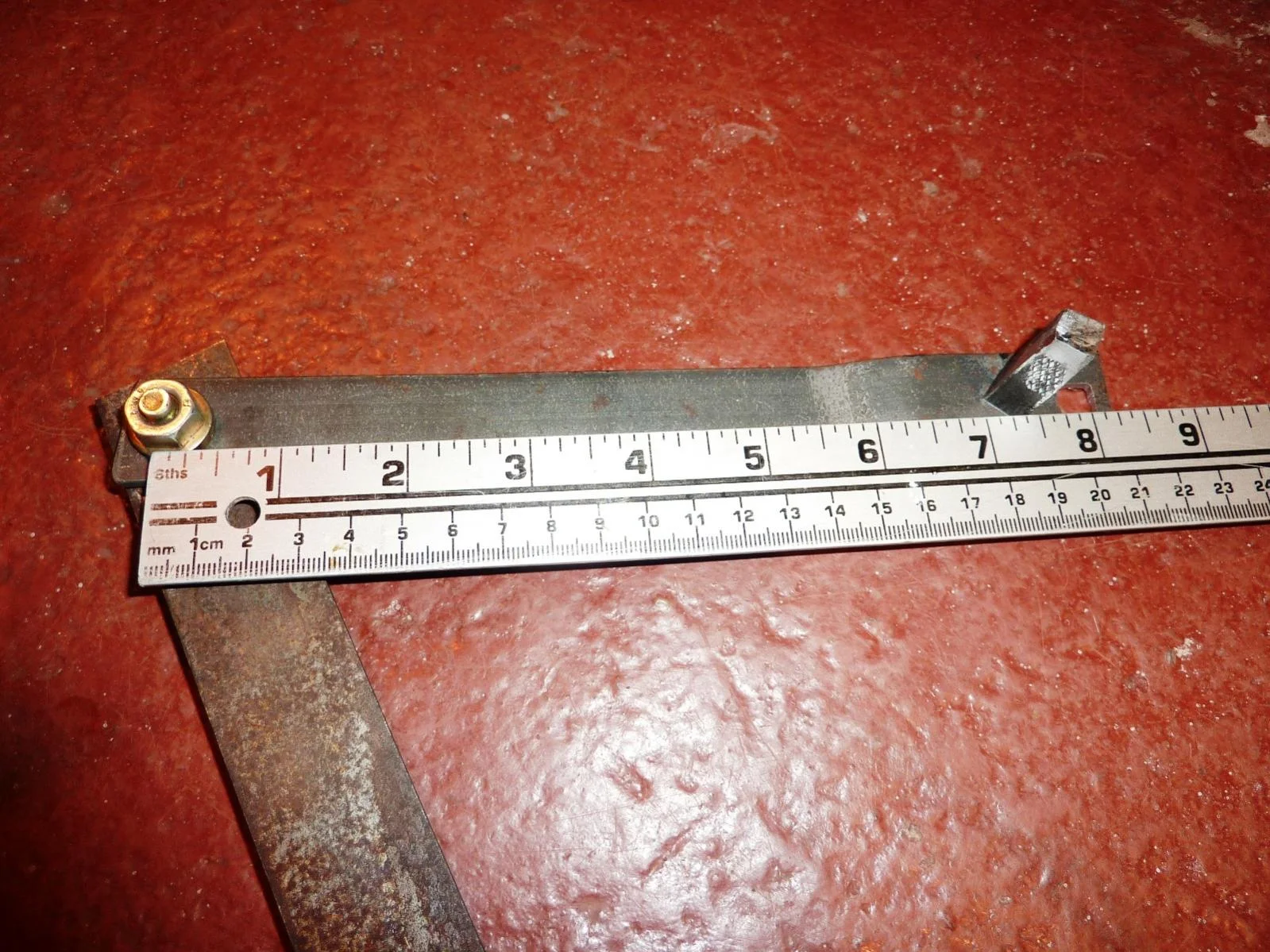

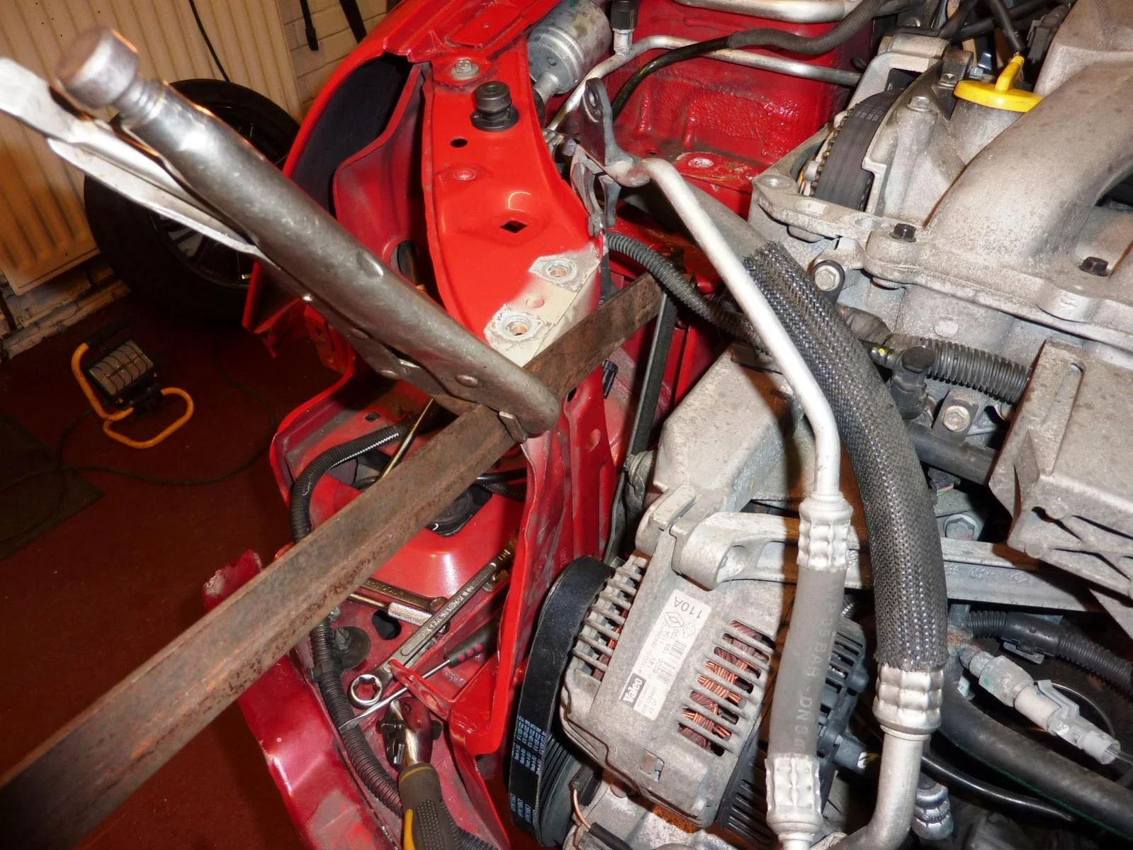

to pull back the tensioner I made the tool in the pictures. Not pretty I know but doing it this way meant that I could use the mole grips to hold the tensioner in the off position while I put the belt on. The square bar is 10mm and I used an old lathe tool to make it out of.

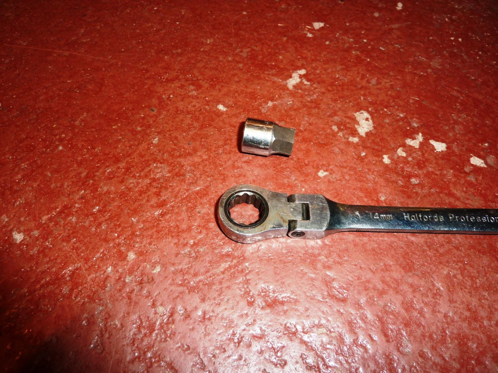

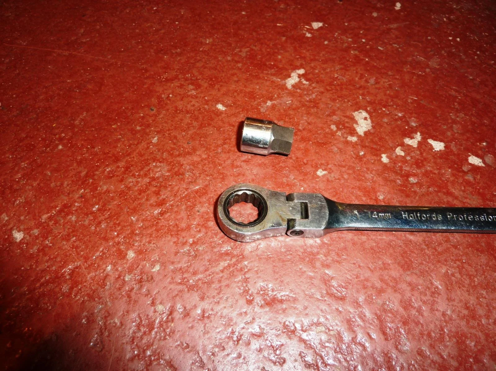

The other bolt I struggled with was the lower Idler wheel bolt. For this I ground a hexagon on a cheap 13mm 1/4 drive socket so I could then use a 14mm ratchet spanner on it. it worked a treat!
