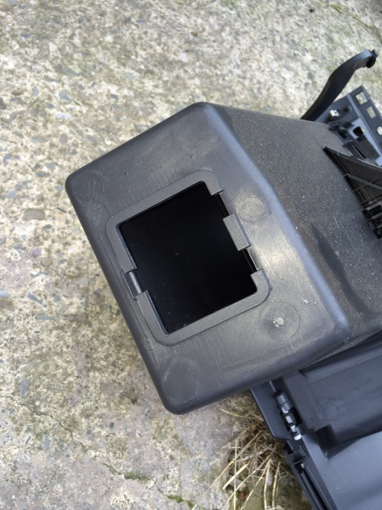

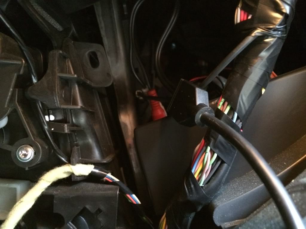

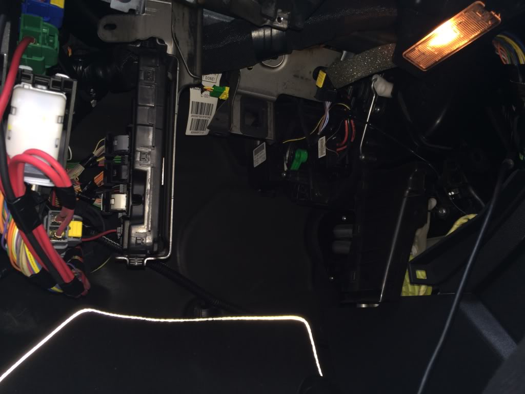

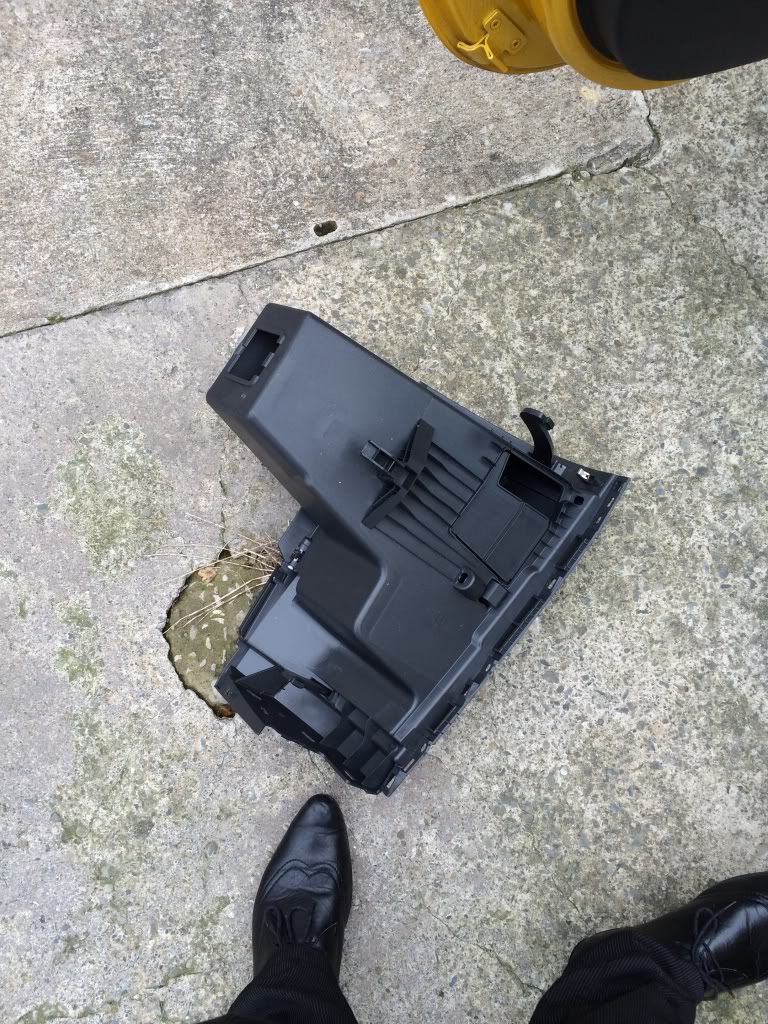

i tested the adapter in the house, it didn't work on either of my docks... Not a very good start. So I set about changing the broke ipod lead in the car for the new, working one. Which worked thankfully.
I put the lead braking down to where I positioned it, down by the hand brake... So I re routed it to the glove box
thank god for Renaults being s**tly built
I put the lead through here, I'm going to drill into the back plate to allow the wire to pass through it
What a mess
this makes it so much easier to dick around with the head unit, I think I'll do this whenever I have to remove it
