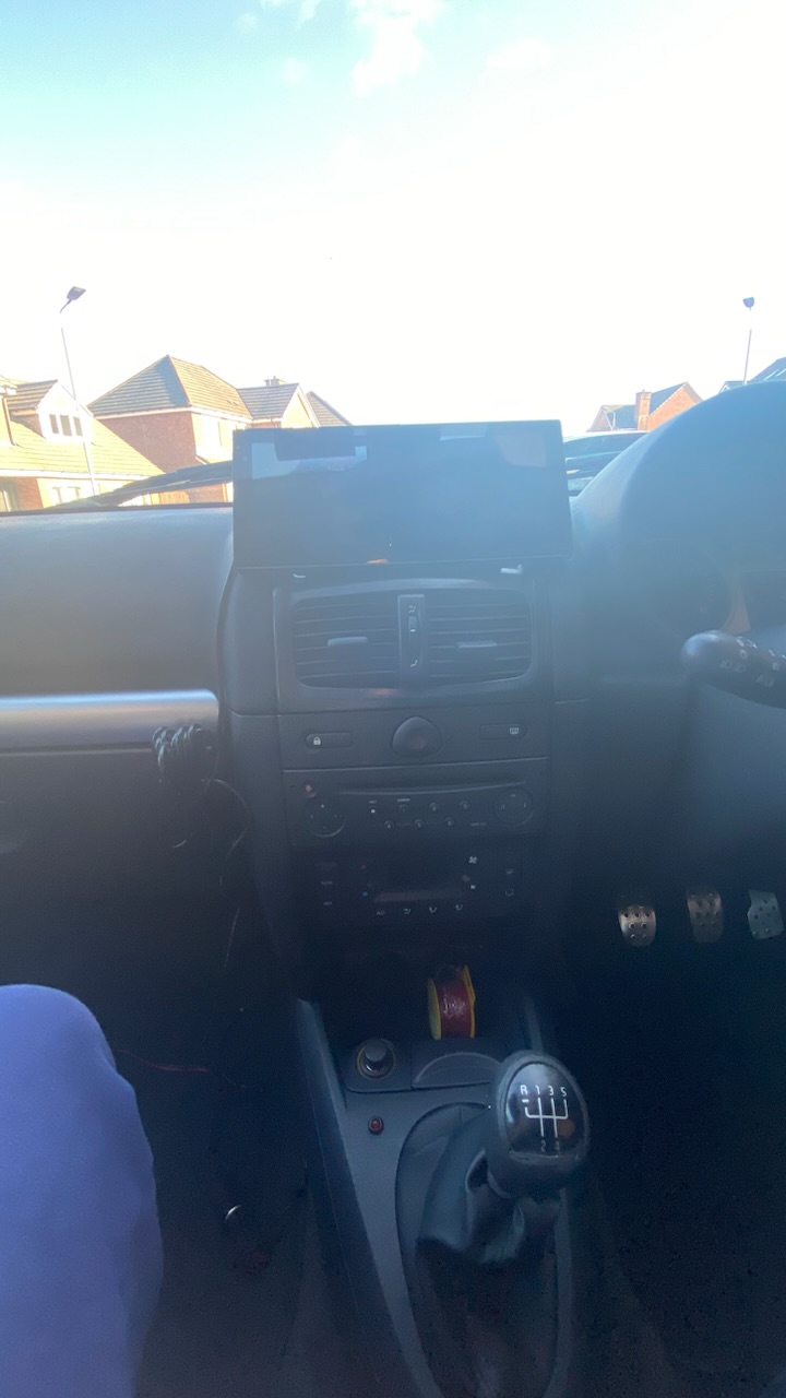

Trying to achieve something similar, Been in the process of fitting this, with a few adaptations to make it hardwired, and look part of the dash, no wires etc. whilst retaining the orginal headunit, and controls. only issue is the mic that ive wired in up to the cabin light has awful feedback so makes the hands free abit problematic. Still working my way through attaching it against the orginal display screen, looking at some plastic welding with a ball joint as an anchor point etc to attach the screen to .View attachment 1629413

Sorry for the delay. Link here Some top drive/ top road or something similar one from ali express but it specifically had dual-band Bluetooth. From my searches its one of the only at an alright price sub £200 this was around a year ago so something new might be out now that's bit more stylish/powerful/priced better etc
