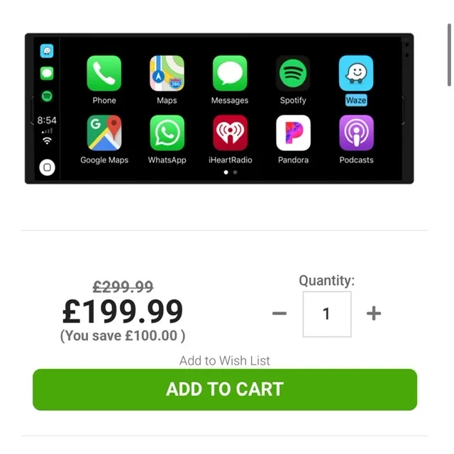

I found this Single DIN head-unit available from AudioTechDirect:
And it appeared to be everything I wanted… for a reasonable-ish £200?

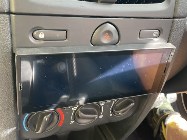

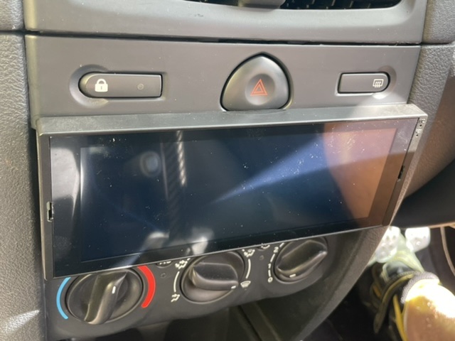

When it arrived, I offered it up, and saw that the display was larger than the regular Single DIN, so it would not fit into the existing hole:

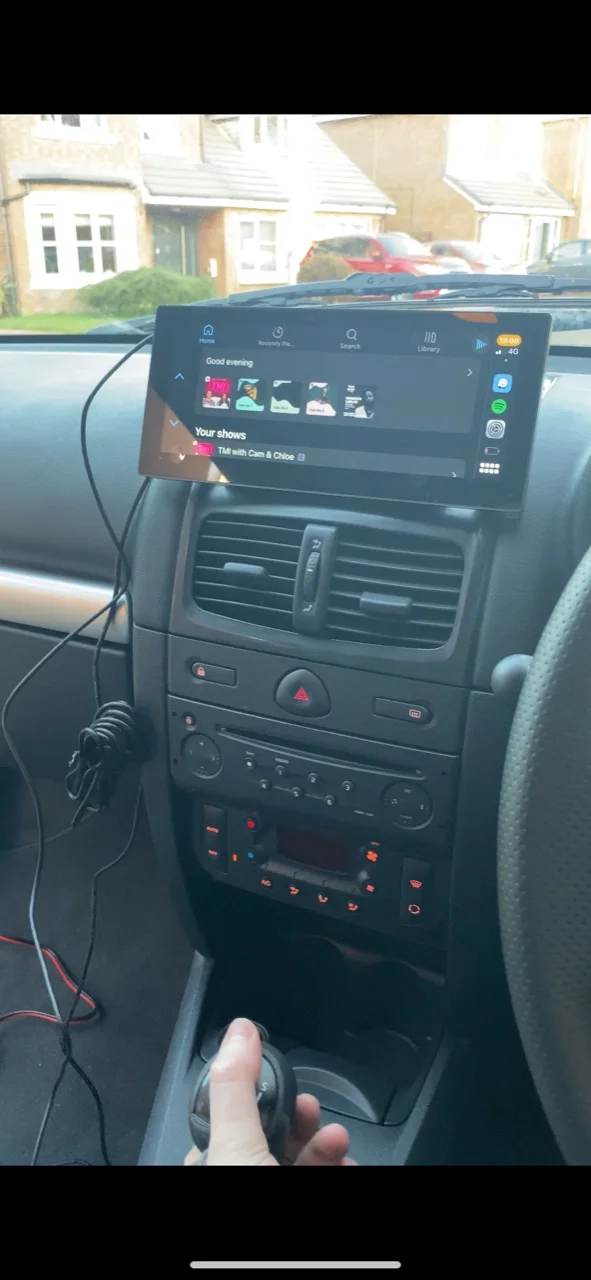

The unit actually comes with 2 mounting positions, and you could mount it like this, but I wanted it to be a little more seamless, so wondered how I could push it further back, into the dash?

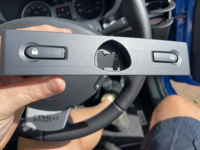

Knowing that fitting it would involve some cutting, I ordered a used hazzard switch panel from eBay for £6, off a breaker, so I can always revert back to OE.

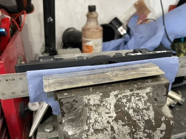

I then scribed a line on the used hazard panel, using the top of the Head-Unit as a guide:

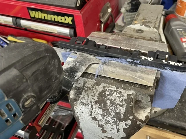

I then lined up a metal rule as a straight edge, and some blue roll to stop the face of the hazard panel from getting marked, and held the lot in a vice:

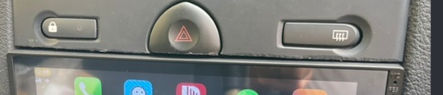

I then used a vibrating Multi-Tool cutter with a wide blade, to cut off the bit of the hazard panel I wanted:
The first cut was actually great, and came out nice and straight, but I then needed to gently cut back the rest of the material at 90 degrees to the original cut, to end up with something like this:

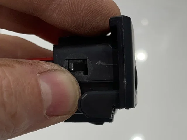

I then needed to cut the hazard button as well:

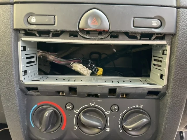

Now the hazard panel and switch was cut, I could mount the cage into the dashboard. But I realised that the cage was a little taller than the OE DIN size, so I needed to give it a little shave with the Multi-Tool:
As you can see, I also removed the bottom piece of trim from the centre console as well.

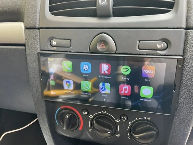

It then slipped in a treat:
Using an Audioleads adapter, I also managed to get the steering wheel remote control to work, so I could turn the volume up & down:
So having had the unit in the car for a couple of days, I’ve got some feedback I’d like to share with you all to give you the inside track:
PRO’s
  • Apple CarPlay works great, when it’s plugged in and gives you the full seem less integration from your mobile phone to the screen, Waze, Spotify, Google Maps, all work great!
  • If your phone dies, it’s got a built in Navigation, Radio etc Apps which mean you can get some entertainment thru the device.
  • It’s a cheap way to get a proper Apple CarPlay system into a Clio 1*2
CON’s
  • It’s an android operating system which is a bit clunky, and uses an app to power the Apple CarPlay system, so every time you turn it on, you need to go thru the Android boot up screens.
  • The Radio within the unit, is only an FM unit, and has no RDS system, so it doesn’t tell you the station you’re listening to.
  • Adjusting the volume for the passenger is not easy, as you have to swipe down from the top of the unit, and then adjust.
  • The icons within the Android OS are REALLY SMALL and impossible to navigate if you’re driving

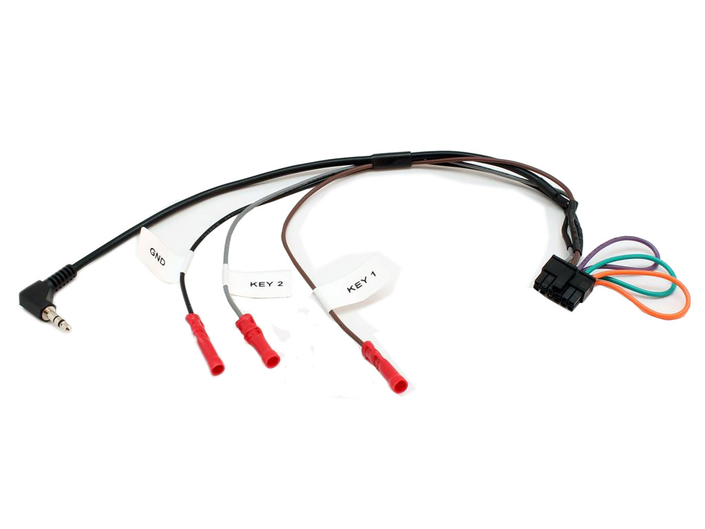

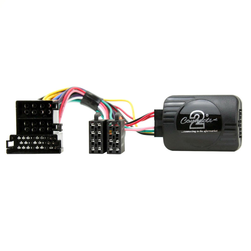

Could you link the lead you've used for the stalk controls?
You need this:
And this:

At first I thought this was a proper clueless doohickey installing a radio to their clio when I saw this
Honestly what the f**k were you thinking? The finish on that is worse than Jordans face. I'd rub my finger across that and get a blister.
I then saw your pragmatic approach to the install and your in depth review at the end but quite frankly any credibility was notibaly launched into the bin when I refreshed my mind at the fact you've literally cut the f**king hazard switch in half.

Looked at that, but with the PMS Shifter it means your hand is at the same level, and I don’t want to be knocking the screen every time I’m in 1st, 3rd or 5th? 🤷🏼‍♂️
I've not had my clio for a while, but when I had mine I swear the gearstick was pretty much at the level of the radio anyway as I used to rest my hand on the knob and poke the screen from there. I can't imagine the throw on the PMS would be massive anyway so it should be alright.
Never had a problem accessing the hazards etc either.
I've got a dab Kenwood and just use Bluetooth to play whatever music app I want on my phone. It can skip tracks using the headunit, and if I really want something else on I can just tell the phone to play it.
Not sure why you'd want a touchscreen in that place on a Clio, it's far from ideal.

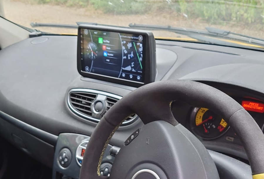

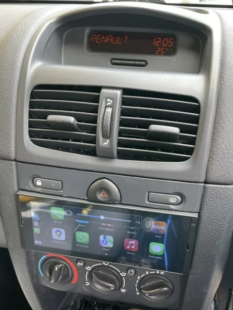

Whilst I agree sort of… I think the man’s done a great job and just needs to invest in a new hazard panel, trim it a bit more carefully (I’d use a wood planer personally, or a fixed belt sander for a perfect flat edge) then wrap the panel in some generic carbon stuff, and it will look proper.

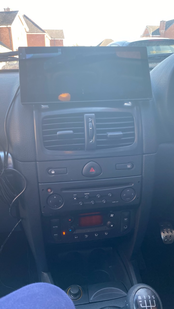

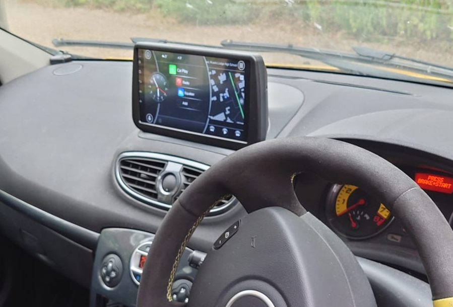

Do you have a link to that, does it require any modifications to the clock area? I have seen similar ones which stick out of a single din slot but never mounted in such a way before.
The one pictured is this one: https://www.aliexpress.com/item/1005004147324367.html?spm=a2g0o.order_list.0.0.21ef1802YIbkTq
...but there are lots of versions and resellers, depending on processor speed, RAM, connections, screen resolution, 4G/5G SIM, wifi, etc. The clock is removed (pops put easily) and is replaced with a plastic stand that fits exactly where the clock is removed. To get the cables up and through, you'll; need to make a hole in the hidden bulkhead beneath where the clock was, which is fairly simple with a dremmel, and hidden once the head unit is installed or the clock replaced. I found it easier to feed the cables up with the airvents below popped out and the glovebox removed.

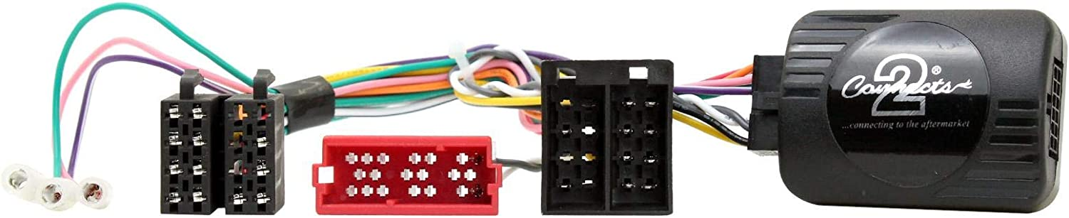

Are the steering wheel controls still usable?

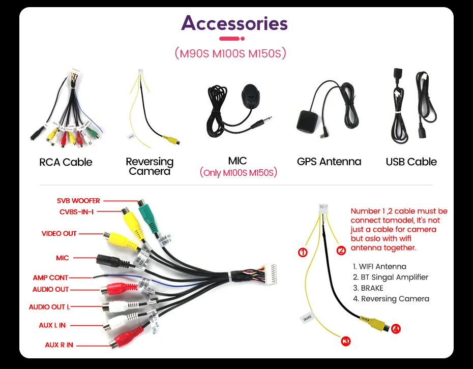

In theory, the supplied box on the right preserves the steering wheel controls, but in practice it relies on the software being provided by the factory that the AliExpress reseller sources from. In the unit that I got, the particular Clio year wasn't listed.
In that case you need a Connects2 lead and patch lead. Their telephone customer support is quite good, to help you select the right one.

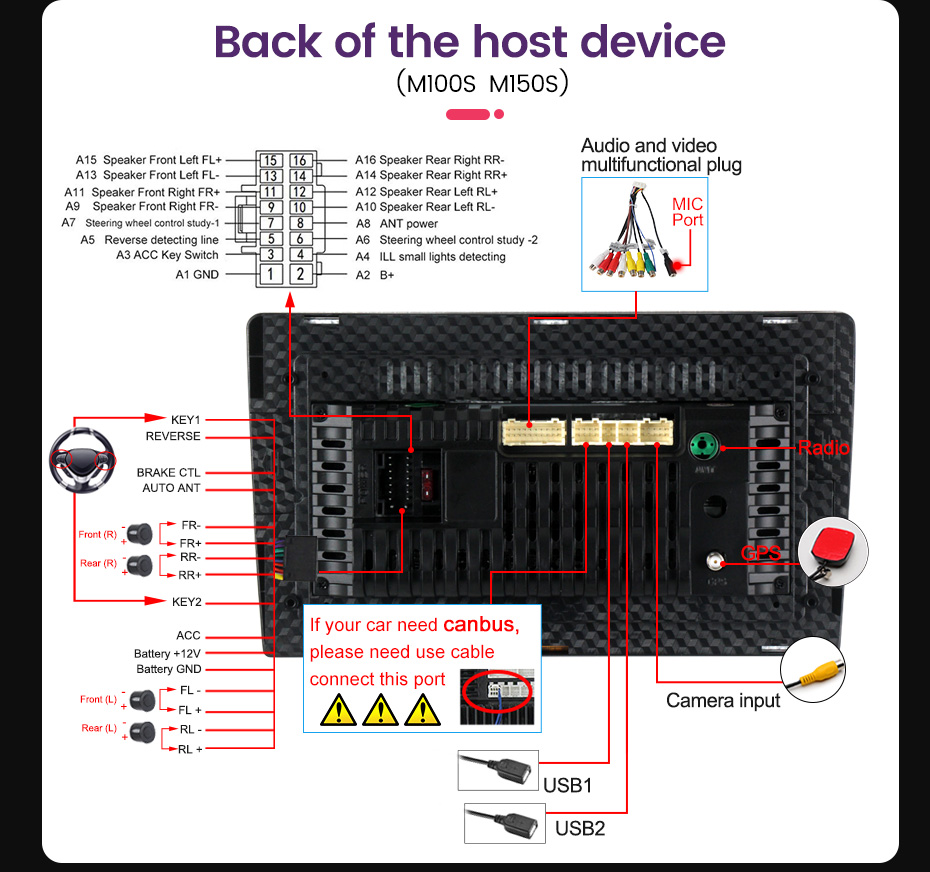

How was it to install to,

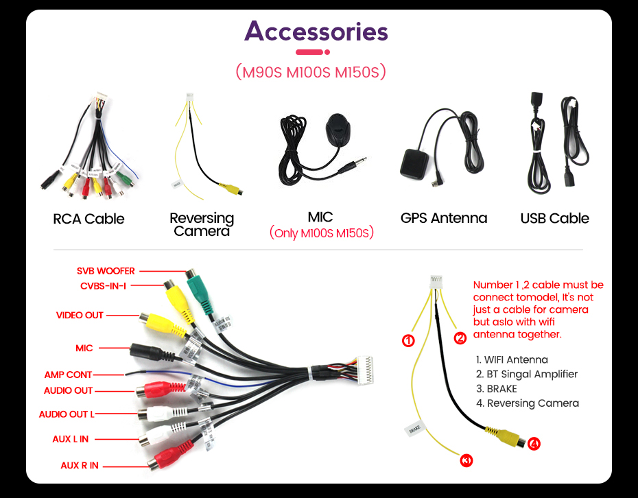

A bit fiddly to get the ISO connectors up into the space underneath the unit. As I said above, to get the cables up and through, you'll need to make a hole in the hidden bulkhead beneath where the clock was, which is fairly simple with a dremmel, and hidden once the head unit is installed or the clock replaced. I found it easier to feed the cables up with the air vents below popped out and the glovebox removed.
did it come with any kind of instructions?
No, but most of the suppliers have detailed diagrams, like the one I posted above.

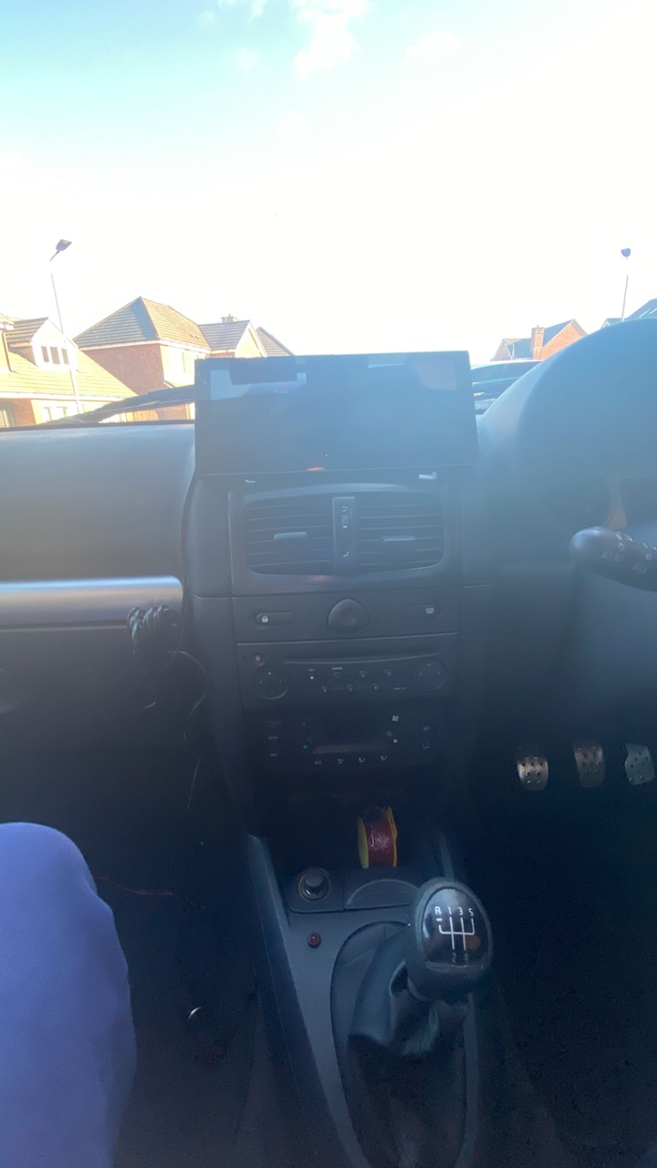

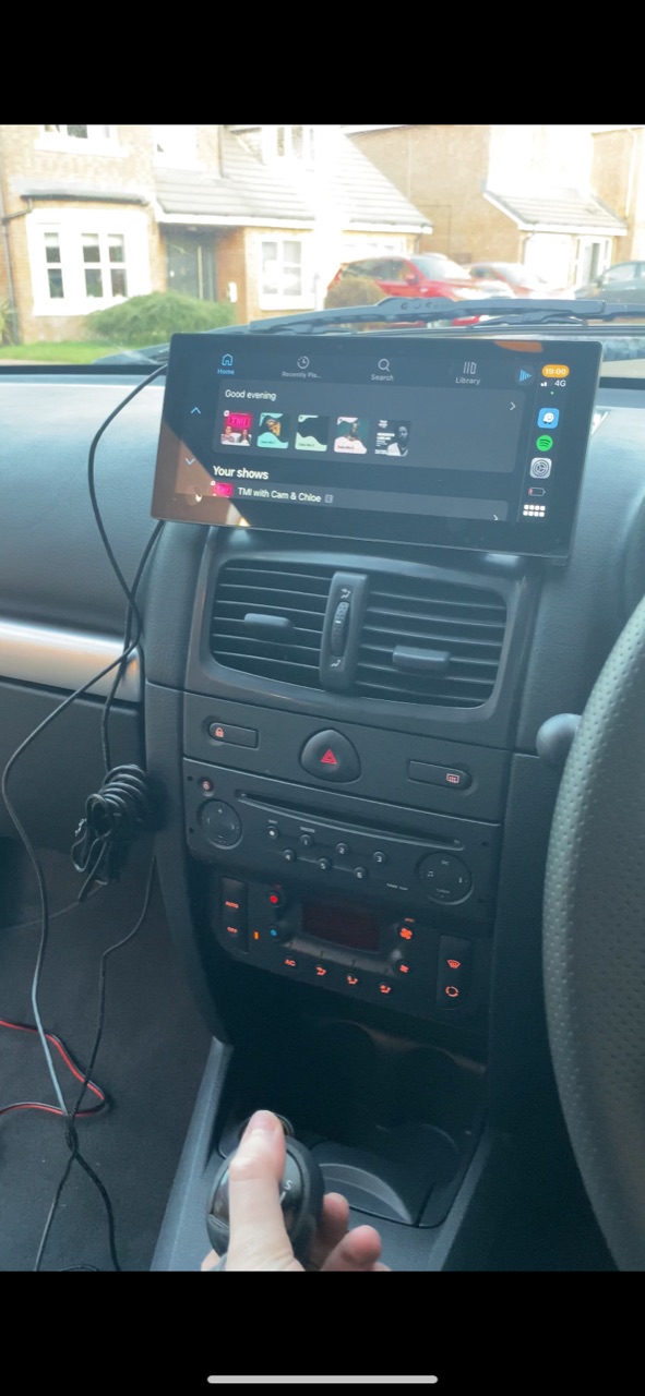

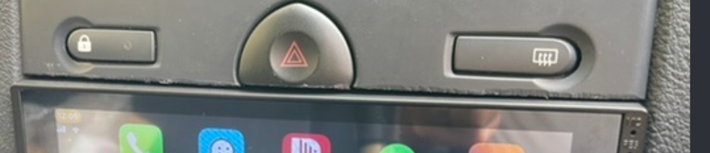

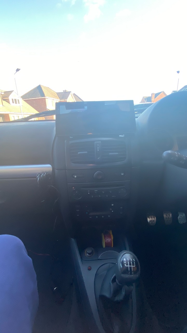

Trying to achieve something similar, Been in the process of fitting this, with a few adaptations to make it hardwired, and look part of the dash, no wires etc. whilst retaining the orginal headunit, and controls. only issue is the mic that ive wired in up to the cabin light has awful feedback so makes the hands free abit problematic. Still working my way through attaching it against the orginal display screen, looking at some plastic welding with a ball joint as an anchor point etc to attach the screen to .

Might be an idea to keep that screen cleaner than your camera phone one.....
Trying to achieve something similar, Been in the process of fitting this, with a few adaptations to make it hardwired, and look part of the dash, no wires etc. whilst retaining the orginal headunit, and controls. only issue is the mic that ive wired in up to the cabin light has awful feedback so makes the hands free abit problematic. Still working my way through attaching it against the orginal display screen, looking at some plastic welding with a ball joint as an anchor point etc to attach the screen to .View attachment 1629413
Great work sir!! I’m all for bringing the new tech to these older cars!!
