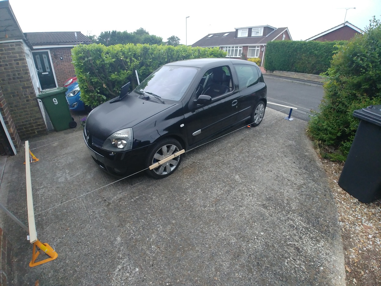

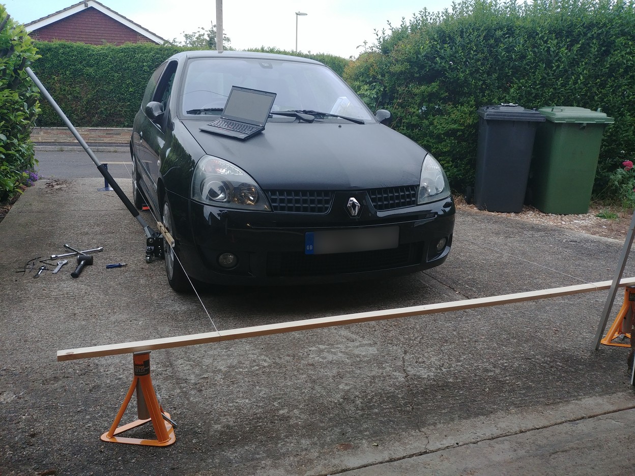

After changing the track rods, I thought it would be a good idea to set my tracking. It's set to just a tiny bit of toe-out. Please excuse the carbon wrap on the bonnet (it was the previous owner!)
I had about 1.5 degrees of toe-in when I started. I wasn't careful to keep the original settings when I swapped the track rods.
I've just taken it for a good drive. The horrible creaking, knocking and play have all gone. For the first time in two months of ownership, it feels absolutely lovely to drive ? With hindsight, I think the sole culprit was the left outer track rod end, but it's nice to have it all nice and tight!
Once I'm happy everything is as it should be and I don't expect to have to change anything else I'll get a laser alignment done. It'll be interesting to see how close I've managed to get it. I was aiming for 12' total toe-out. I've got the steering wheel in the right place for straight ahead.
