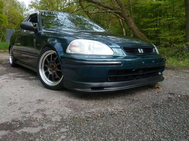

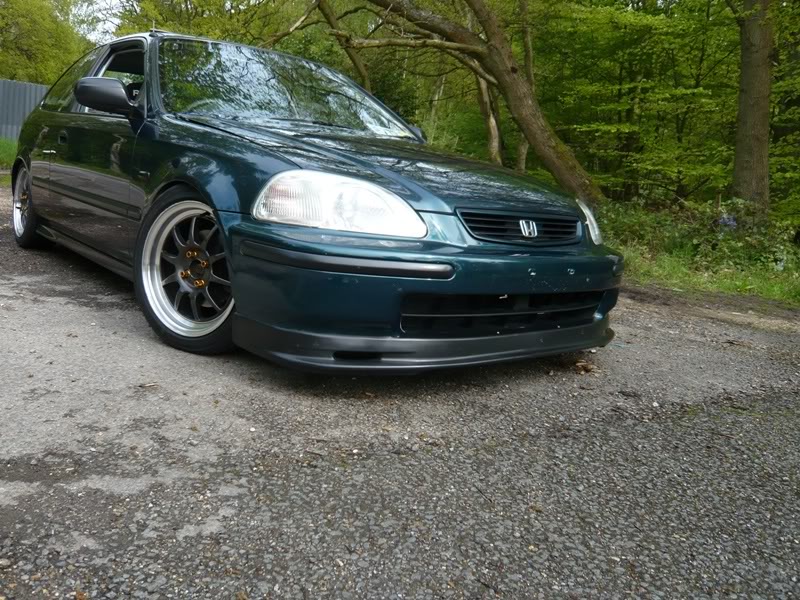

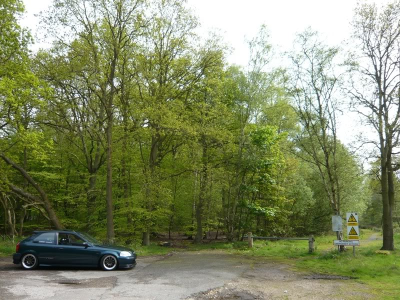

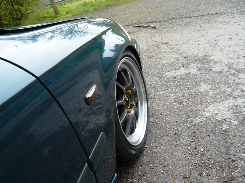

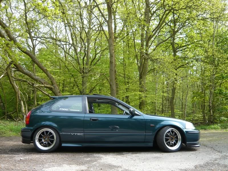

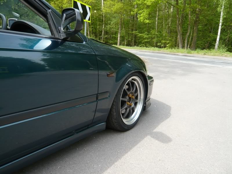

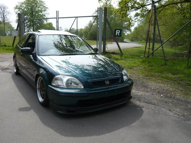

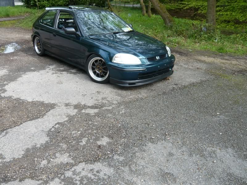

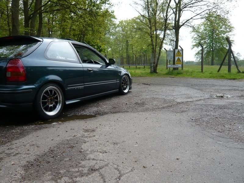

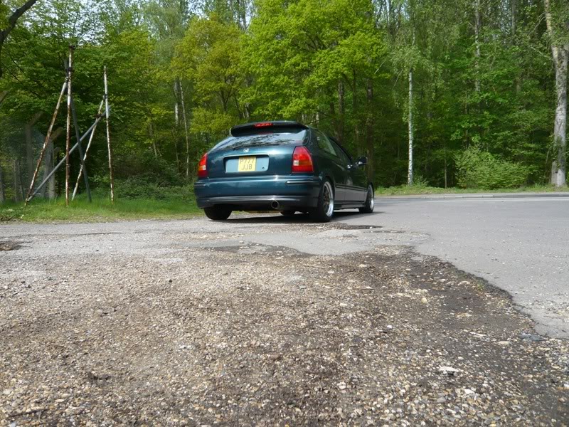

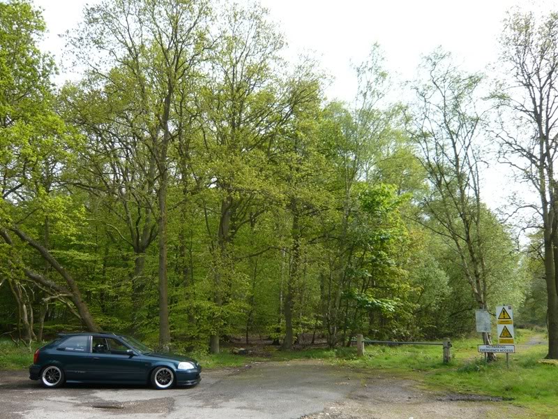

Amazing day today! Got a new camera for my birthday so have been trying to use it as much as i can.
Heres some updated picytures of my "new" car, had it for a while now since i sold the old RT :) Bought it bog standard, here it is today....

seriously thats gorgeous... i would get 1 for my first car but a 1.4 engine not sure about the insurance tho im thinking it would be pricey

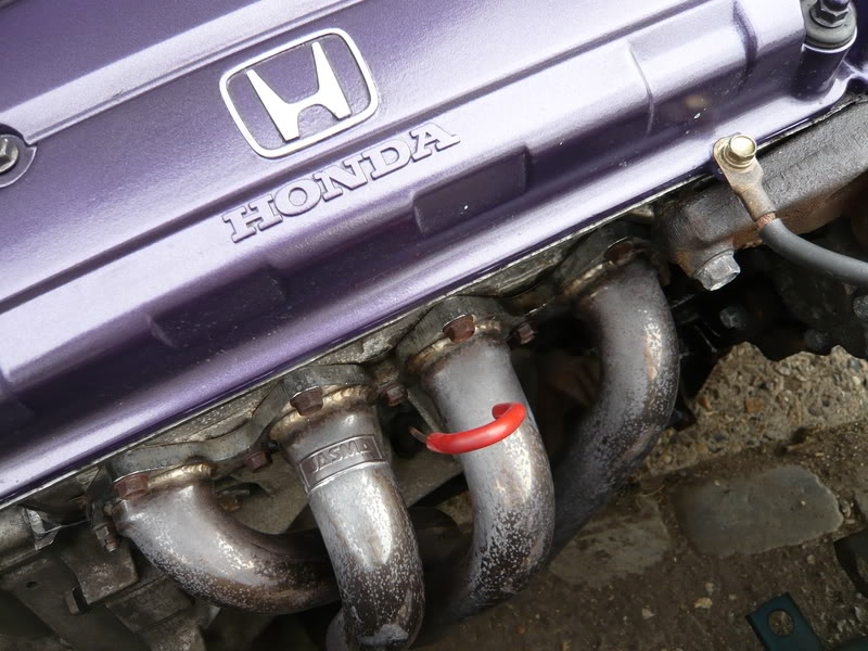

Engine so far is b16a2, 5zigen 4-2-1 manifold, EK9 type R camshafts :), NGK plugs and leads, crappy air filter which will be gone soon for a dc2 air box! oh and a short shift too,

I forgot to say, it has a EK9 type r flywheel aswell (bit lighter than stock), exedy clutch and custom one piece b-pipe from the manifold back :)

Looks mint :D

If you have aftermarket manifold on and ek9 cams you should be getting some management on their as you could be running very lean

My mate had the exact same setup (its his manifold i bought from him) but with dc2 cams, he made 173hp and his afr was fine, this was at Surrey rolling road btw. His dyno result is the reason i got the ek9 cams, i am getting my ecu slighlty mapped to accomodate the mods but its not 100% needed.
Each car is different mate
The age of your fuel system can affect things i.e age of the fuel pump whether it can produce the psi it used to (Hondas generally run around 35psi) plus whether the injectors are still working to potential and not clogged up slightly.
Best to get it on a rr and check the afr. If its fine then sweet money saved :D If its a little low a cheap alternative would be fitting an adjustable fuel regulator and just up the pressure a little

awesome car man. was going to get one of them down here, but they have ALL been driven into the ground and are modded the cheap way. but still, here their book value is 4900 but if you want one with lowish mileage and in good nic, you can expect to pay 6600. ppl pay crazy cash here for those vtecs
Englebert, thanks, a guy has his done the same colour and it does look really good actually, your right though only works on some cars

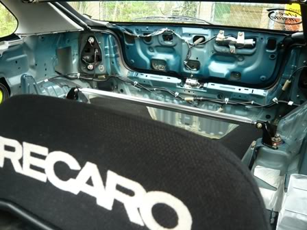

Cal46, yea recaros lol but the type of recaros is the same as the dc2 etc, from an evo 4/5 iirc
