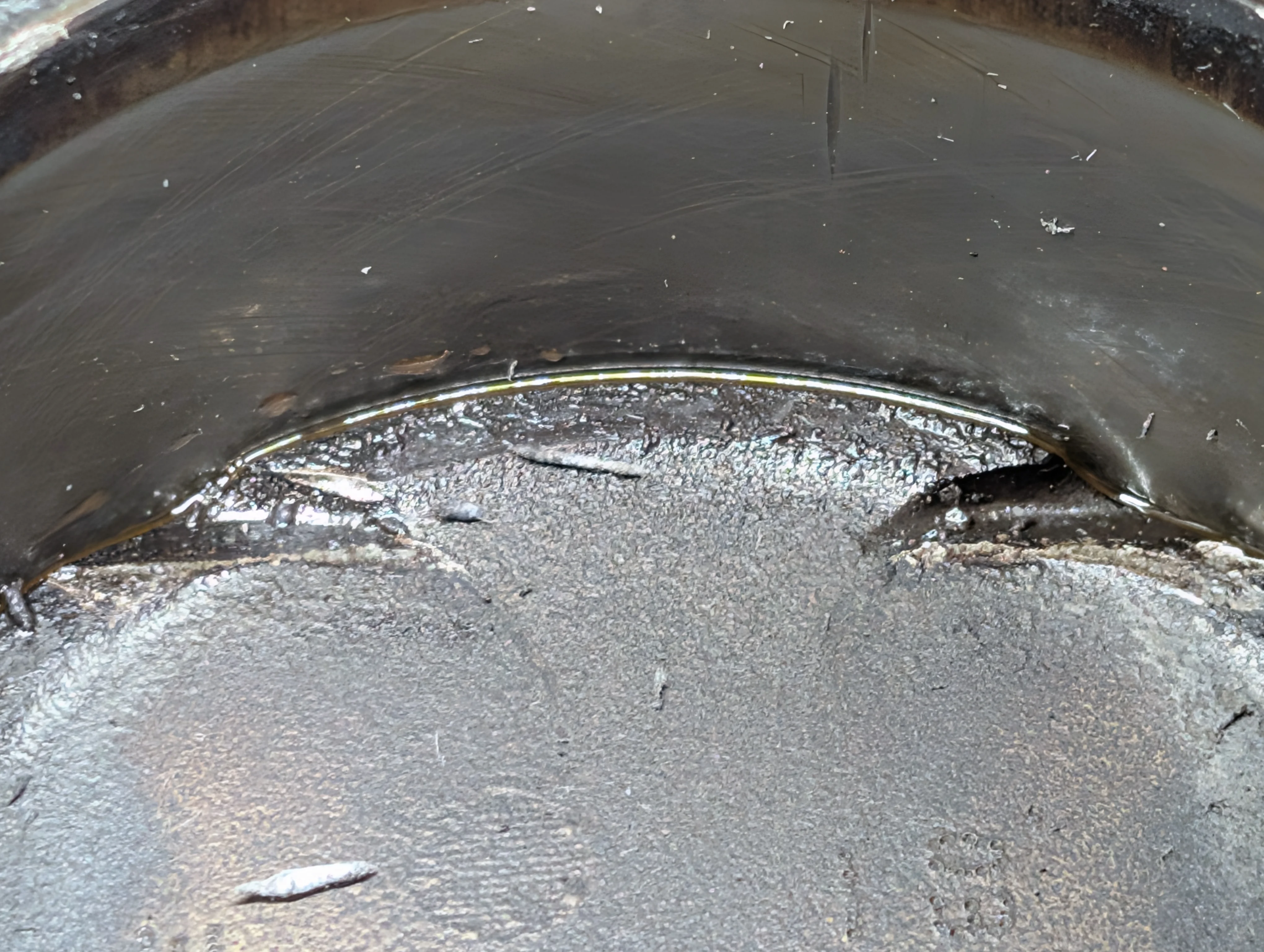

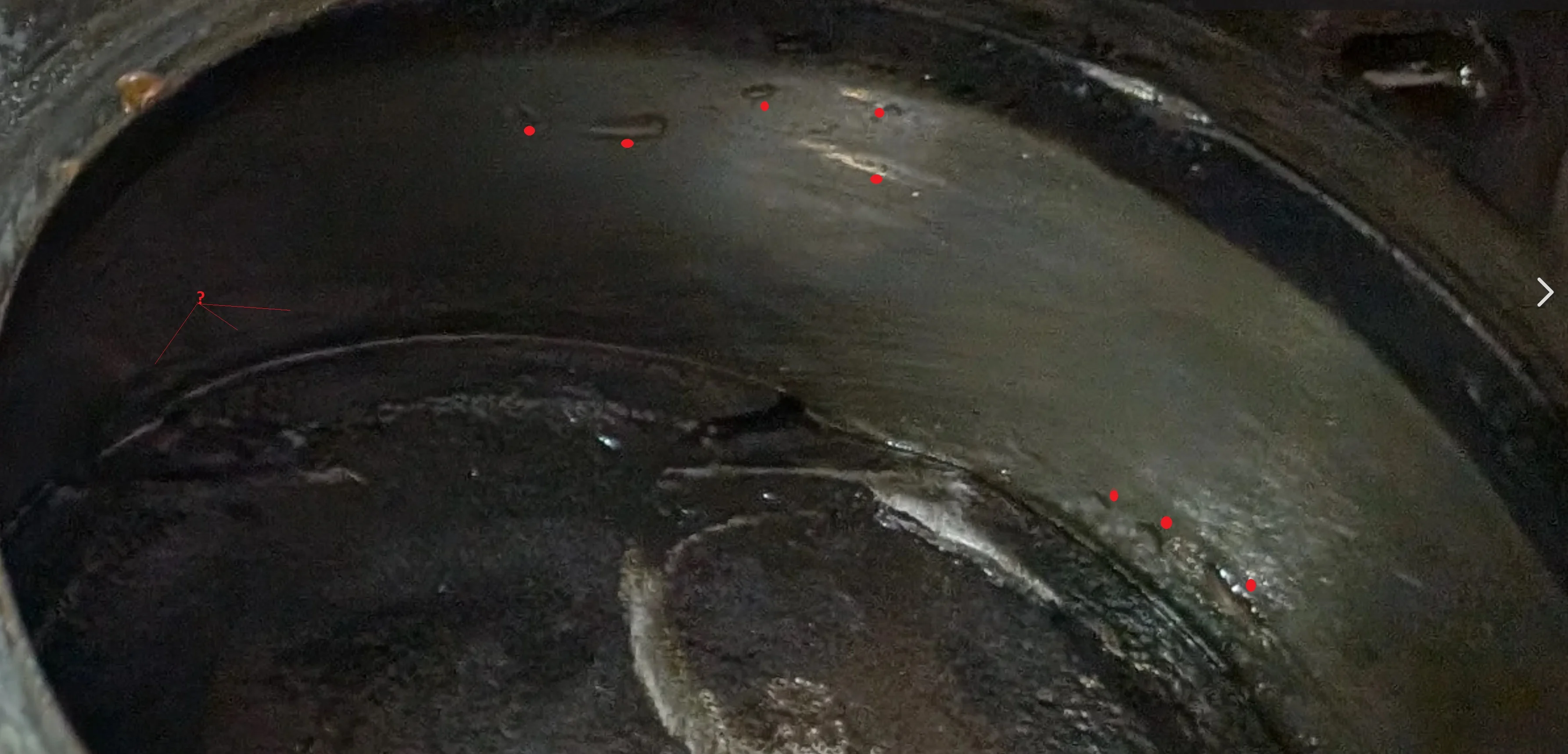

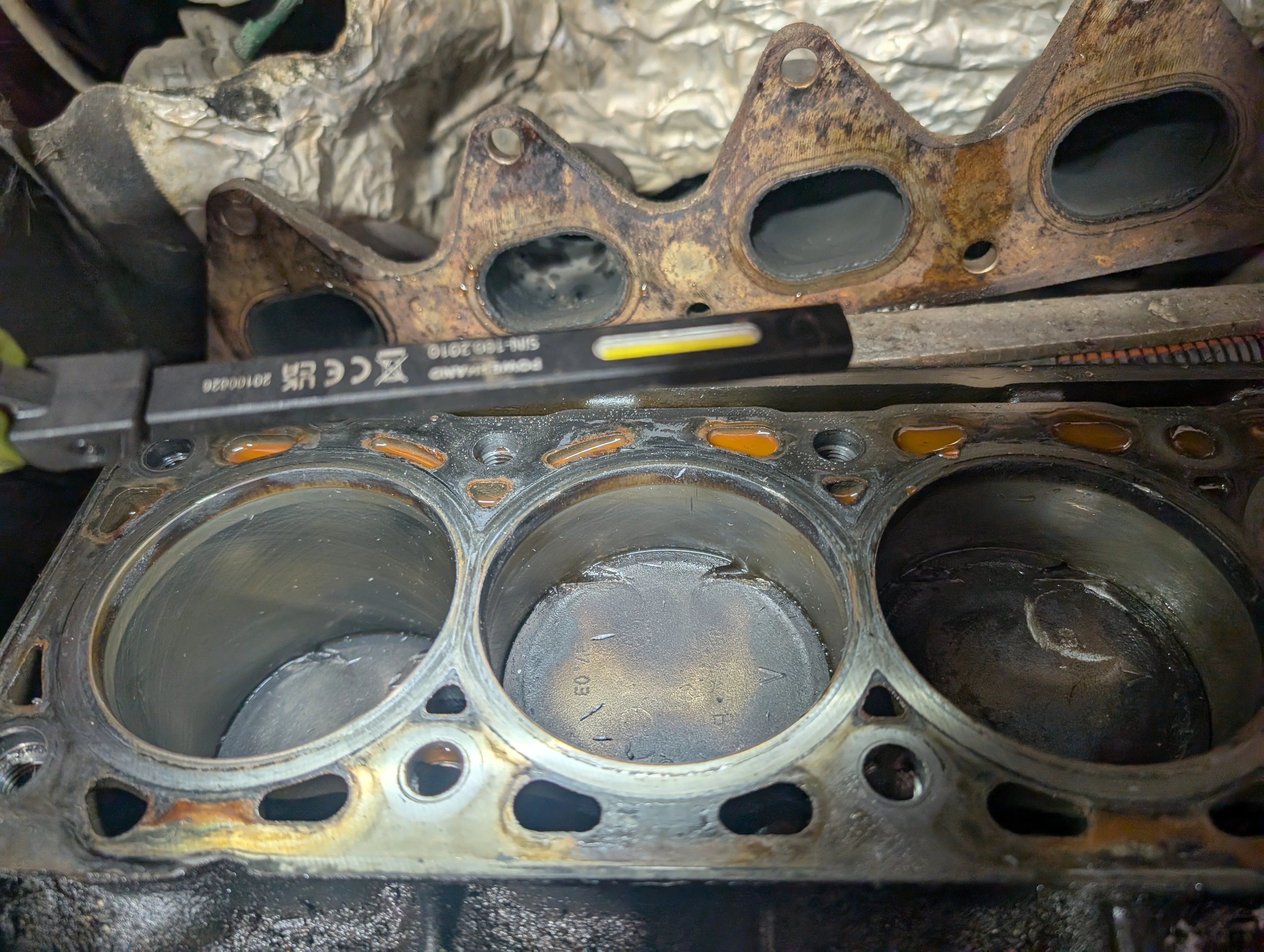

The day they started, they sent me a picture of the damage to the pistons and block... (only because i asked for pics of the rebuild for my documentation, and have been particular with my questions for a number of things after taking advice from this and other RS groups about certain questions...like genuine timing tools and Group N timing potential) Garage say they would smooth the damage and put the head back on but upto me. If it were one of their cars they would do this.

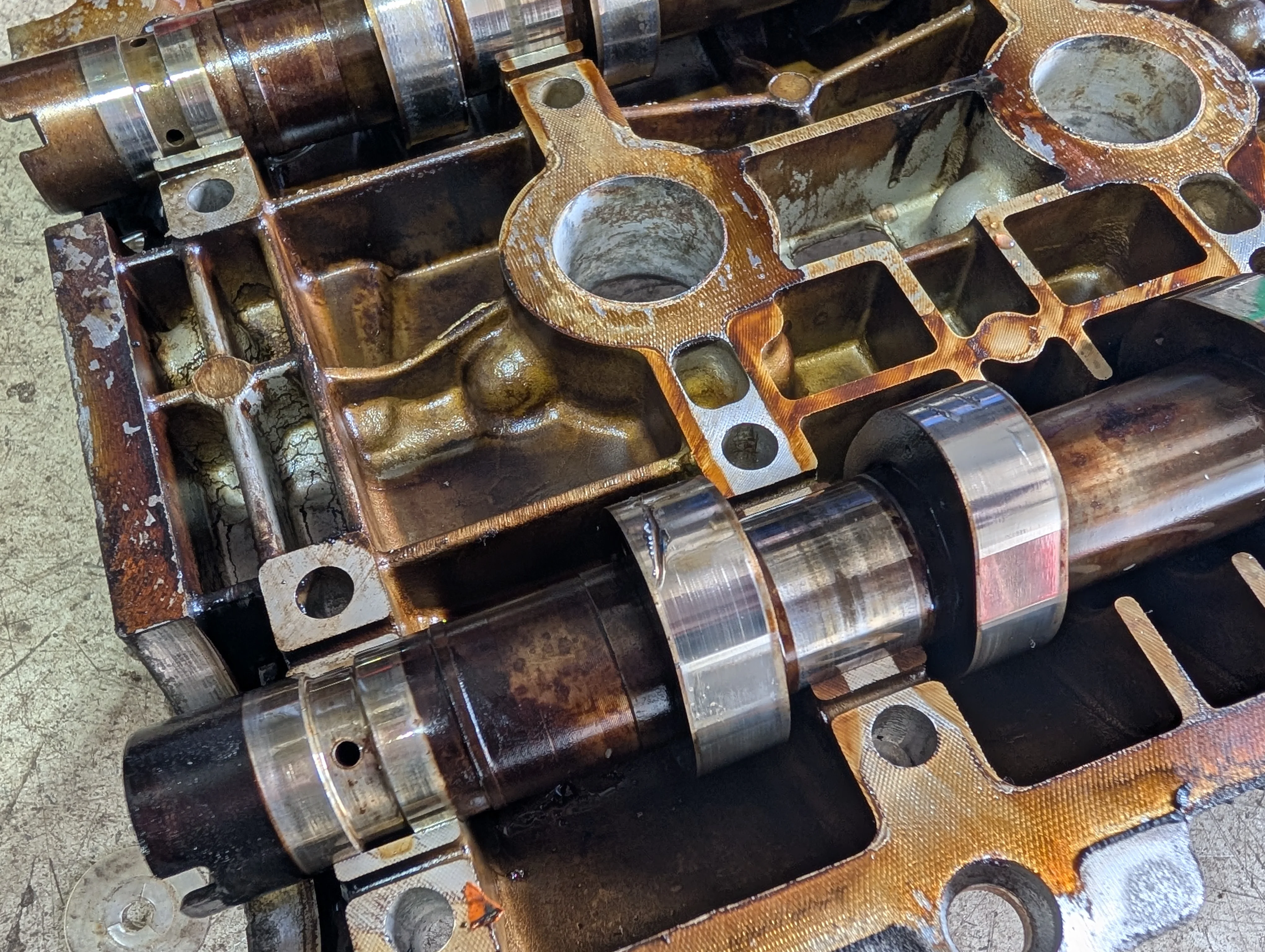

The following day I recieved the picture of the cam, which played on my mind when trying to sleep because i thought you would spot the cam first before taking the head off...making me unsettled so asked them to stop the work.
also feel this could have been found quiickly before the long wait for sorting head out and would have gone new engine route.

The cylinder walls are fucked, that's a re-bore and over-sized piston job.
f**k the entire engine off and find a replacement.

The cam lobe damage is an easy miss. If you remove the burrs then the cam will also run again.

As already said I'd be concerned about the rod bearings, the cam is scrap and there's some decent gouging in the cylinders right where you don't want it.

Cam - toast
Cylinder walls - toast
Piston far right first pic looks to of kissed the valve and left an impression in it.
Swarf everywhere - going to be in the oil. That'll get in to crank bearings and all sorts if it's not already found its way there.
You can put it back together, but I fear you'd be pulling that back out within a week.
Not 100% sure can say that without more pictures.
Can only see 3 cylinders, and there's clear damage on the walls of two of them. Even then we can barely see half of the actual cylinder, so extremely likely there'd be more.
Considering he's lashed out £700 on a decent cylinder head, you'd not wanna re-use that block without very serious inspection of the damage and wear.
I certainly wouldn't recommend to anyone they should re-use that in it's current state.

The picture focuses on the second cylinder, but the party looks to have been going on in the 3rd?

Yes seeing 3 of the 4 cylinders...either last one is worse than these or so imaculate it didnt need photographing....🤔 but yes i looked closer after saying ok to smoothing and i see dinks and chios out of the cylinder, split chunk in the piston that coukd weaken it and split or atleast cause hotspots in the cylinders. Who knows what the rods are like and from what i've seen, they like to hurl a rod or 2 when driven hard so isn't uncommon.

As said above, looking at the pics closer of the cylinders, id say that block is fcuked/needs rebore.
Prob better off finding a 2nd hand engine sadly.

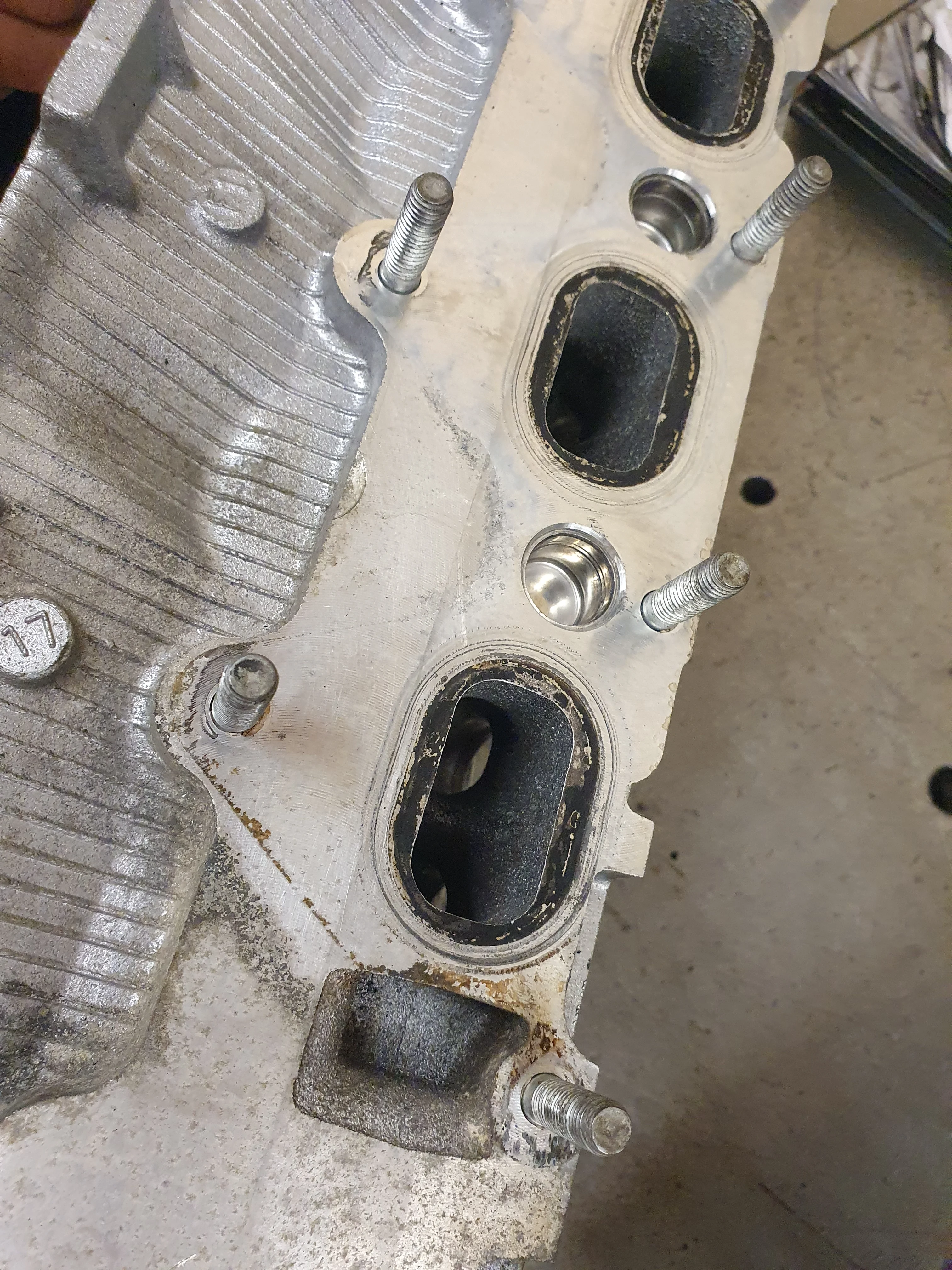

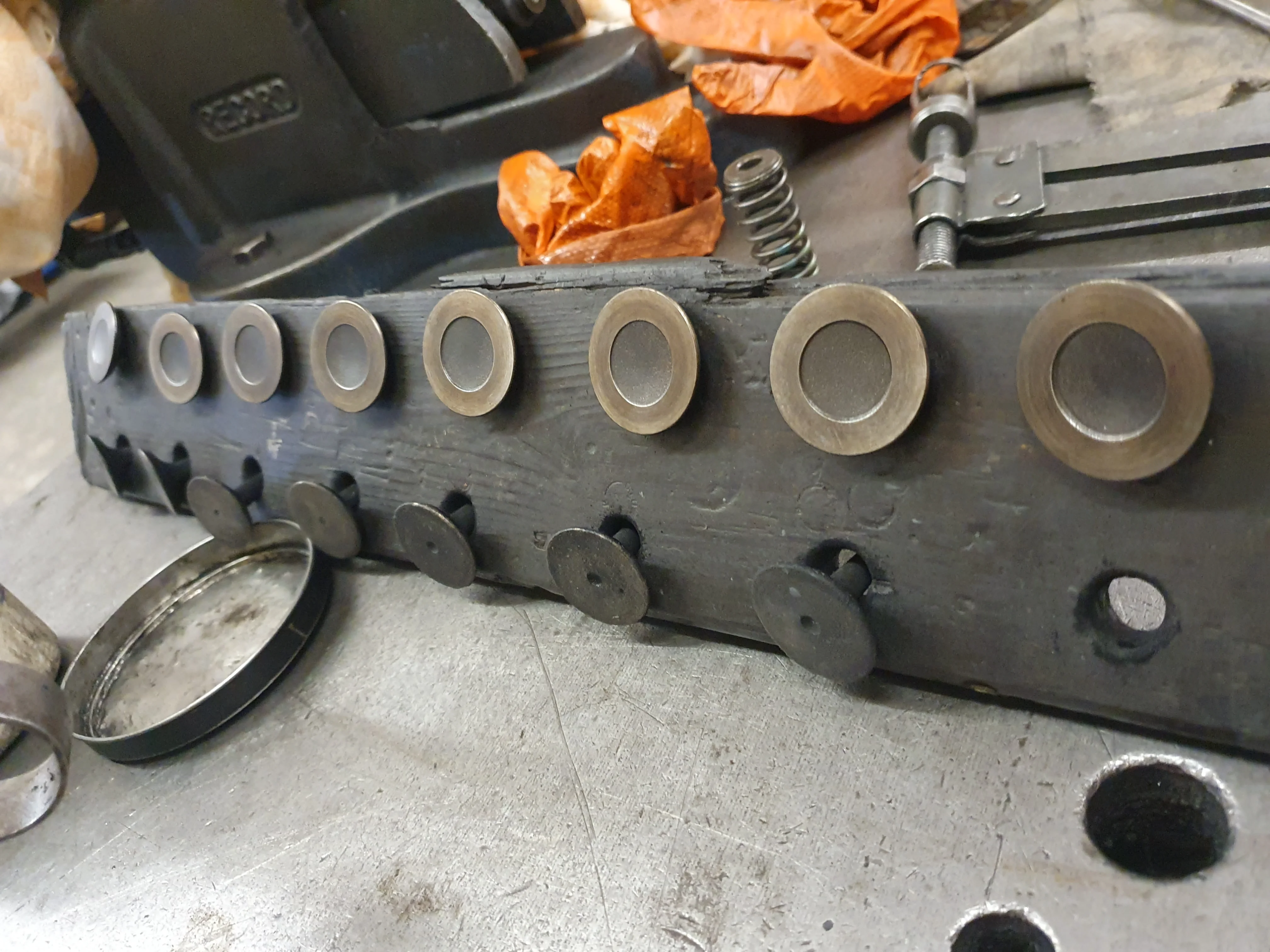

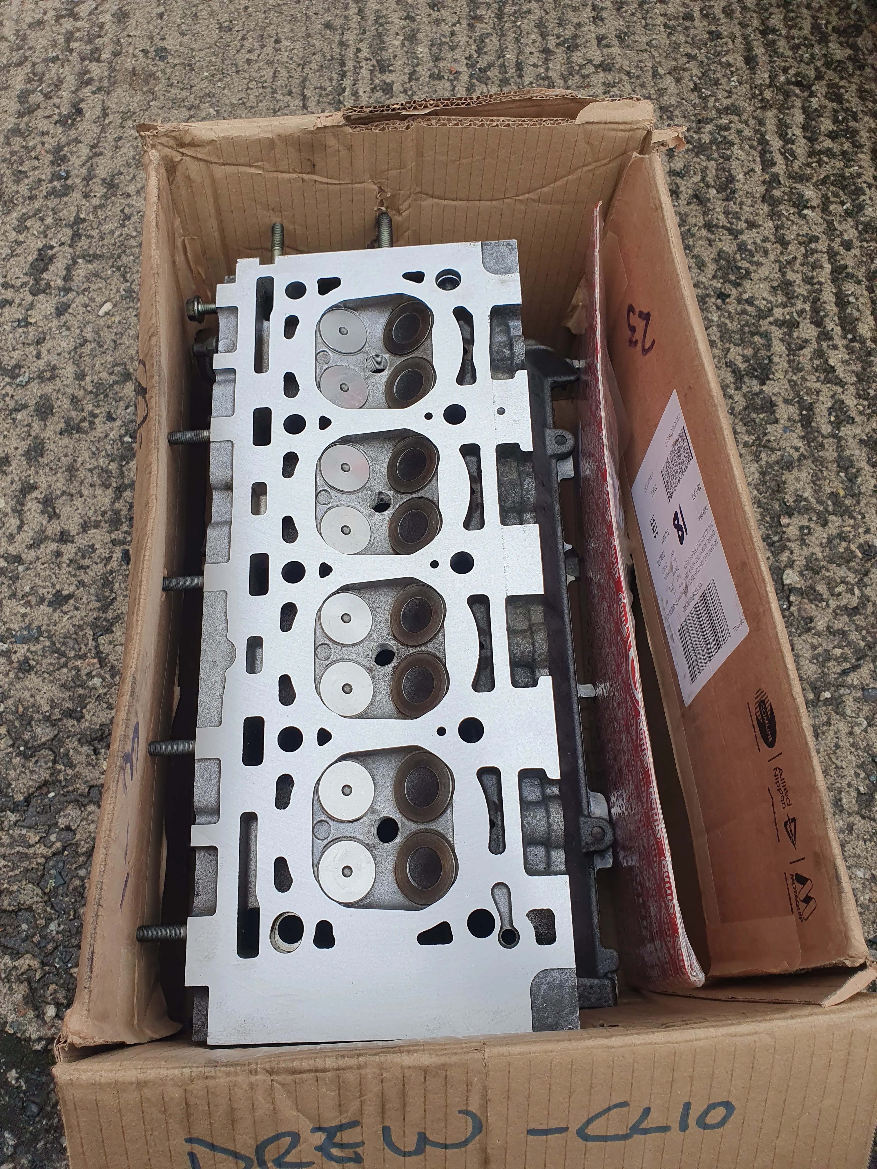

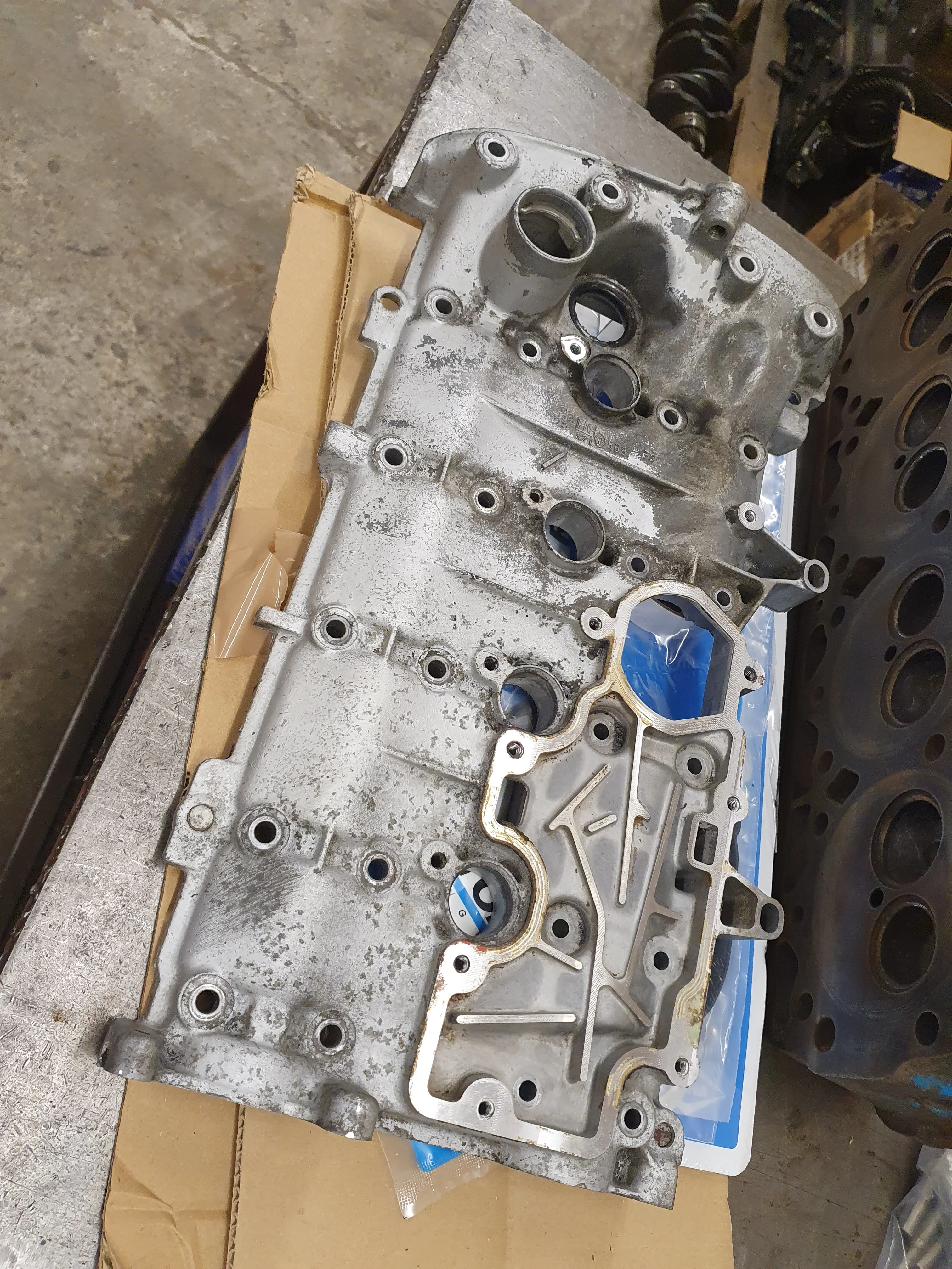

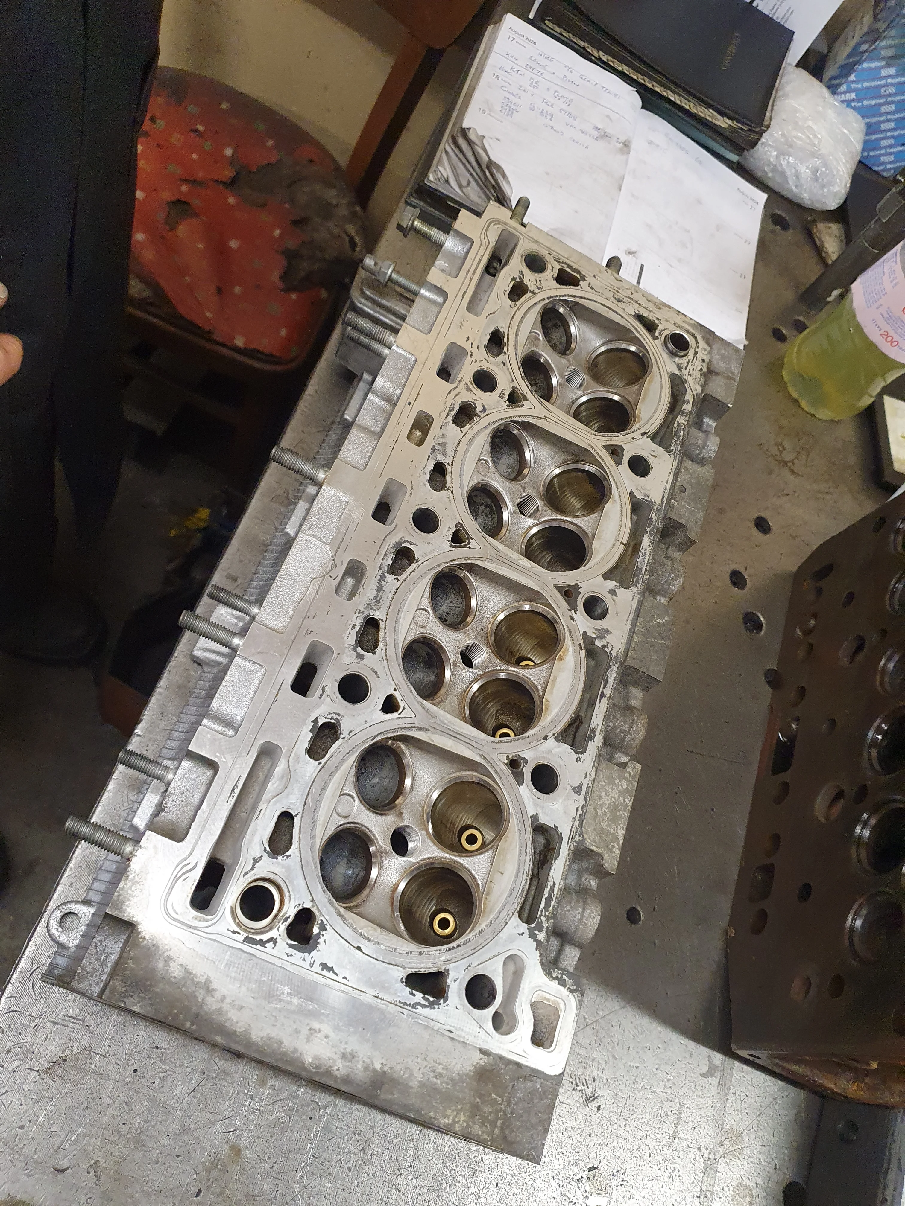

Heres some other pics. This time of my reconditioned head.
Cleaned, acid dipped and de-coked, flow-checked, new exhaust valves, 16 new valve guides and seals, all vakves rehoned then skimmed.
DId want to port-match it but with rushing to get it ready for the garage to instal i skipped this stage.

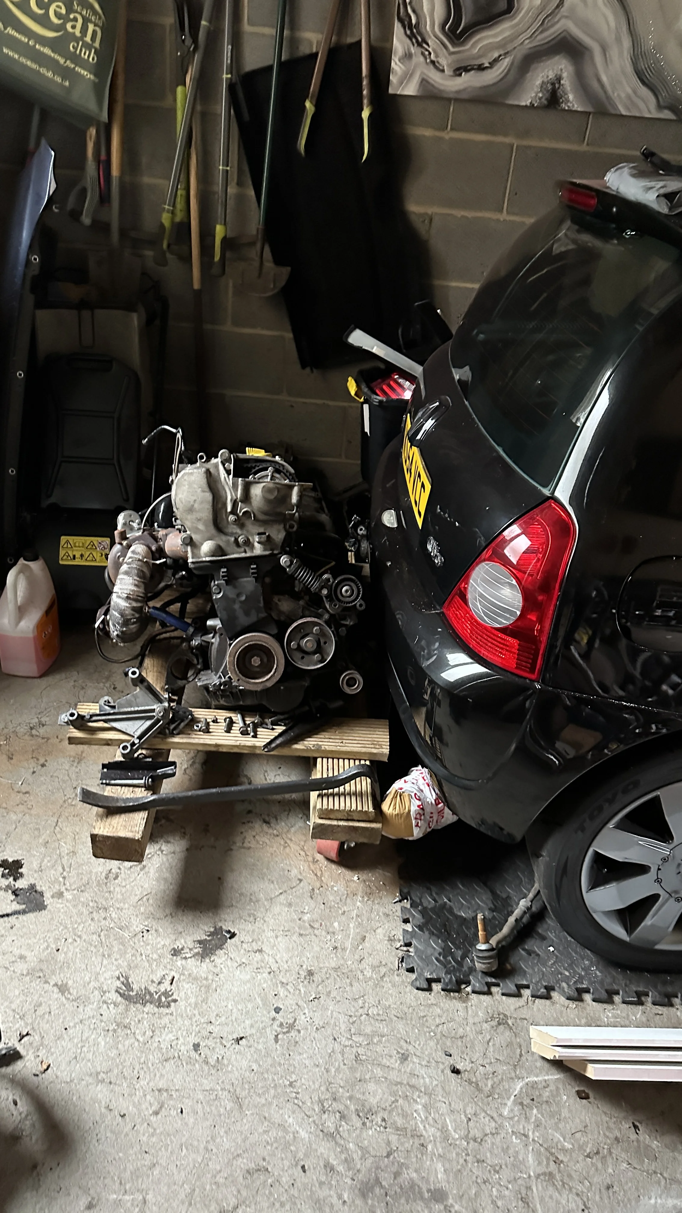

Not even needing a crane?
Nah, just dropped it straight out. Not sketchy at all 😂.
Actually being serious, the engine removal is pretty straight forward. A lot of people seem to opt to go out the top with a hoist but out the bottom is a doddle. If you drop the subframe you can carefully lower the engine with a jack onto something once the mounts are undone and then wheel it out. The only downside is the subframe will either take 20 minutes or 9 hours to remove. No middle ground and entirely depends on how nicely the bolts want to play.
These heads are CNC ported from the factory, there is some power to be found with more aggressive port work, but you'd need a specialist who really knows these engines and obviously more aggressive cams and such to compliment the porting.
Having the lower inlet ported can bring some power, most noticeably with the early Ph1 inlets. The later ones revised the design and were better flowing from stock.
