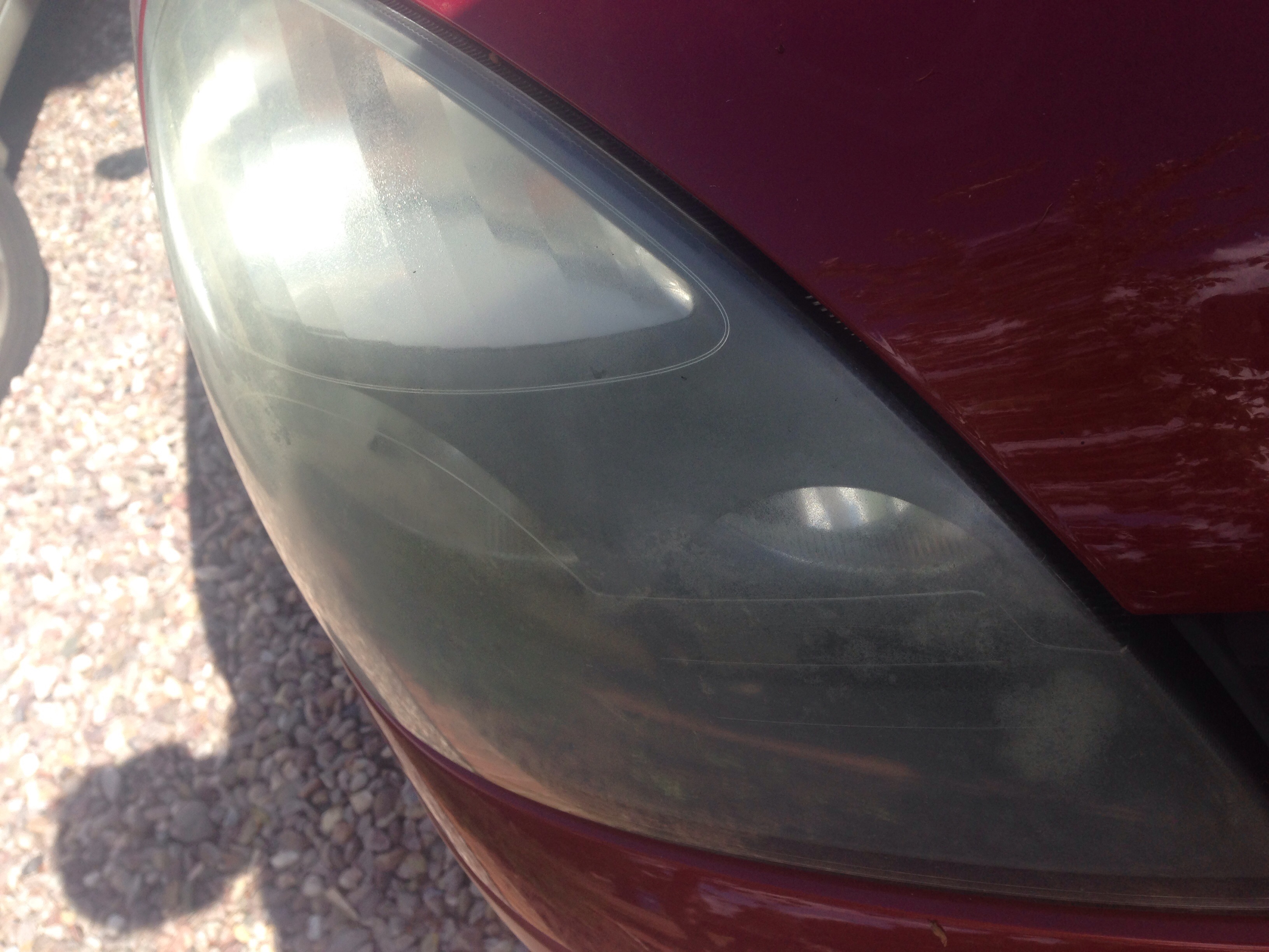

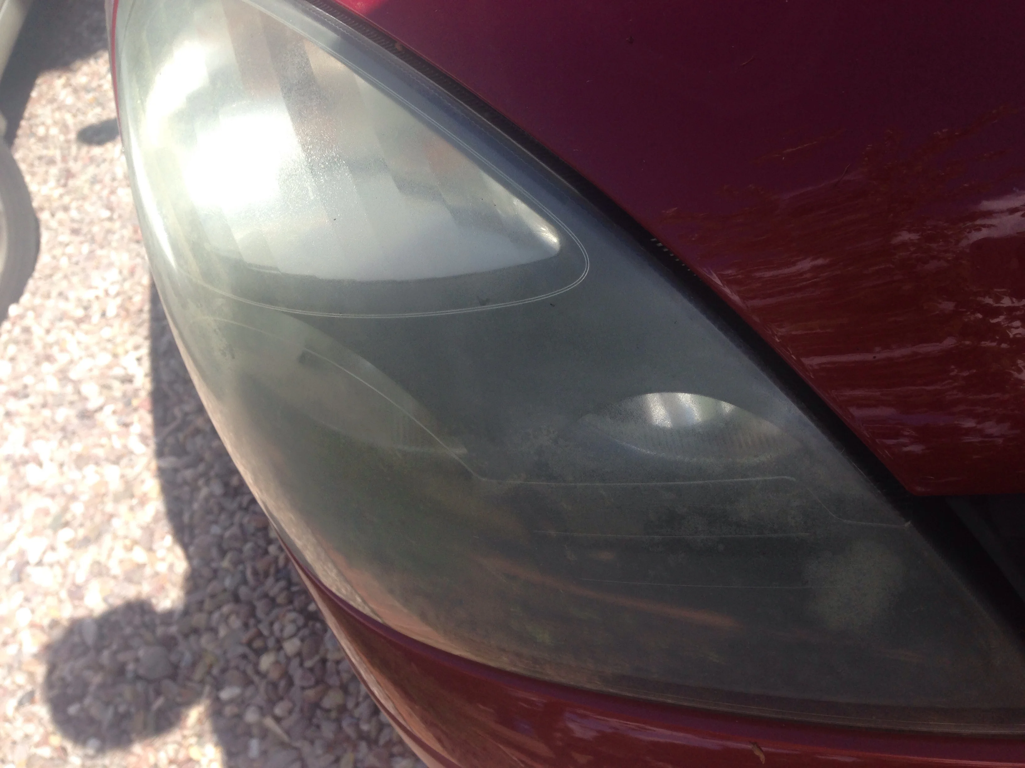

sorry if this is posted in the wrong place, just wondering what's everyone's opinions on cleaning these up? Will I be able to get them back to new looking, or am I better off buying some new ones to replace them? Many thanks

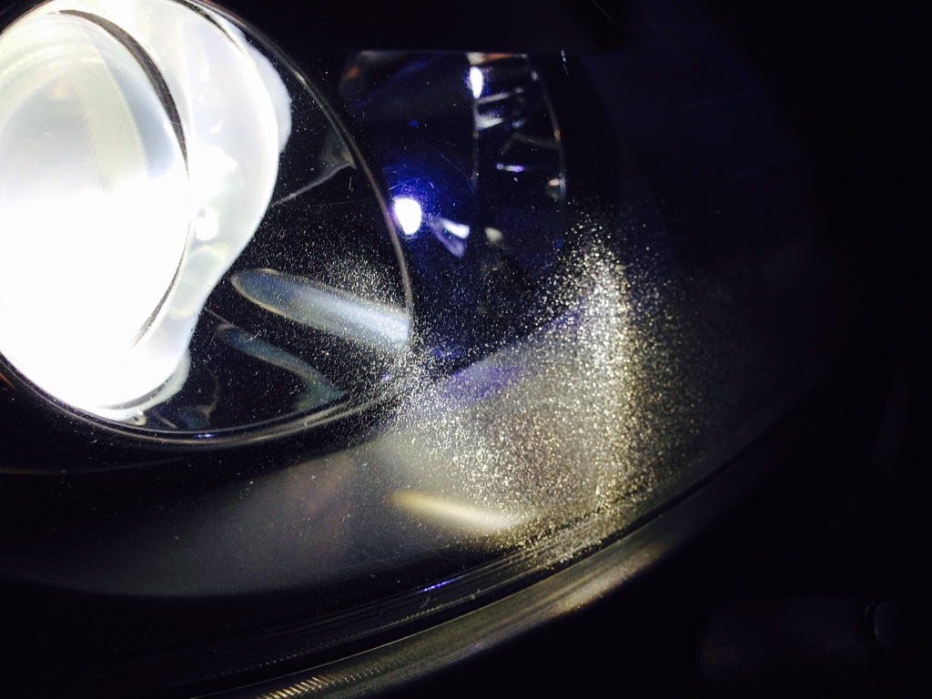

I used the 3m kit on my Volvo and to be honest wasn't impressed. I got better results with wet and dry with elbow grease (lots of it many times :() on my Clio
However I only really got good satisfying results using a Makita rotary polisher for the final stage. I would not really bother unless I had a polisher next time.
Not perfect though up close
You could buy one on eBay and sell again afterwards :)

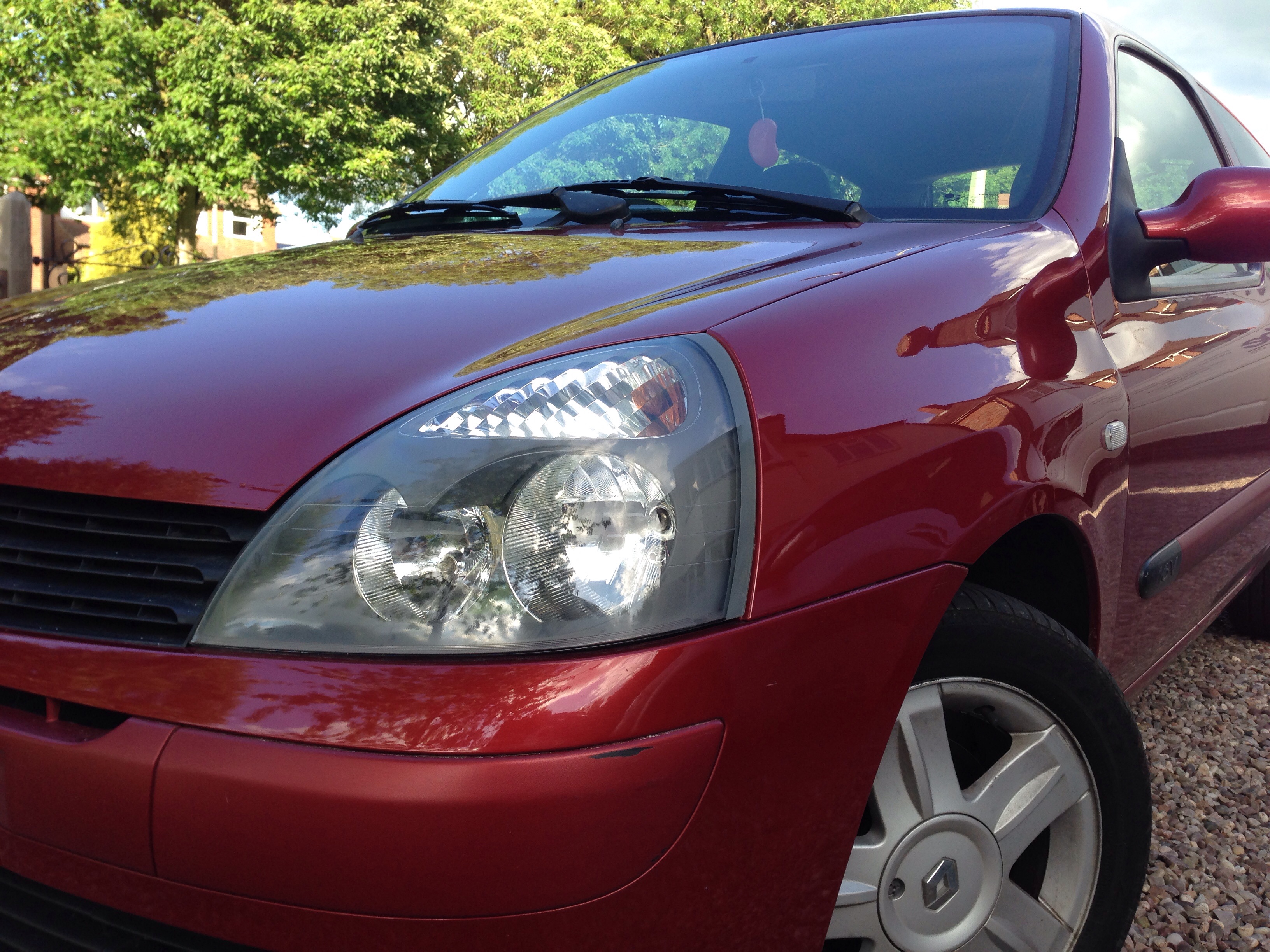

  Renault Clio Mk2
I used the 3m kit on my Volvo and to be honest wasn't impressed. I got better results with wet and dry with elbow grease (lots of it many times 😧) on my Clio
You could buy one on eBay and sell again afterwards :smile:

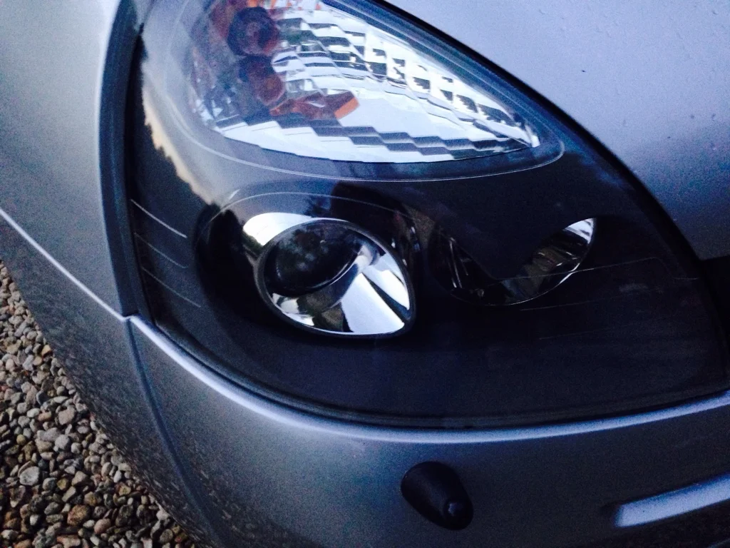

Thanks for the reply, I did buy the 3m kit in the end, and I've got a before and after thread on here, here's the finished product though!

That looks great!
