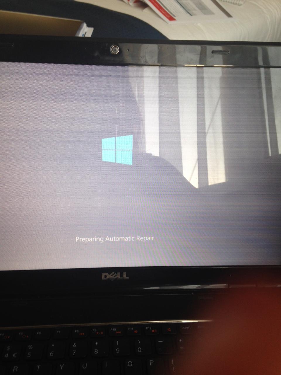

Currently having an issue with our laptop... It is running windows 10 and is about 3 years old. It's a Dell, if that makes any difference.
The screen has gone really funny, and it is stuck in what can only be described as an 'automatic repair' loop :S
See picture here:
Can anyone suggest a way to fix it. I can't find anything online.
Thanks very much!

Tap F8 when starting it up and it will give you a list of options. Choose Safe Mode and see if you have any luck that way?
OK cool will do! Any ideas why the screen has gone strange? There are small faint lines all the way across it.

If they are there on boot up then I would say it is a hardware problem. Have you got a VGA port and can you connect the laptop to an external monitor. If it works OK on an external monitor then the GPU is ok and most likely a loose connection. When did the issue start.

1. Try monitor
2. If monitor also bad look up graphics driver for your laptop and windows 10
3. If monitor fine, screen probably fucked
Can you not get into Windows then? If not you're best off downloading the Windows 10 ISO on another computer firing it on to USB and re-installing from that.
Sorry guys haven't been able to get near a computer. Screen now fixed... However still stuck in the automatic repair loop. Have tried troubleshooting options and pressing F2 / f12 on log in but don't really know where to go from here with it.
