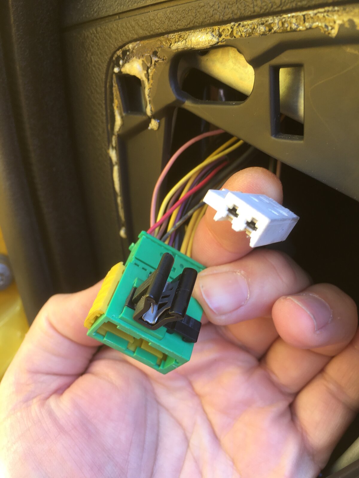

I found these loose connectors behind the left side of the dash. Could they be related to the CC wiring?

Thats the plug that connects the loom, the white plug is the tweeter.

Thanks. I really am a dummy when it comes to electrics. To connect the CC sensor do I need to replace the entire loom, or just a bit of it? Do I simply plug the required section into the green plug pictured, or do I take the dash apart?
I think that its just the wiring that goes to the where the interior lights are which plugs into that green plug in your pic. So only a small part of the loom.

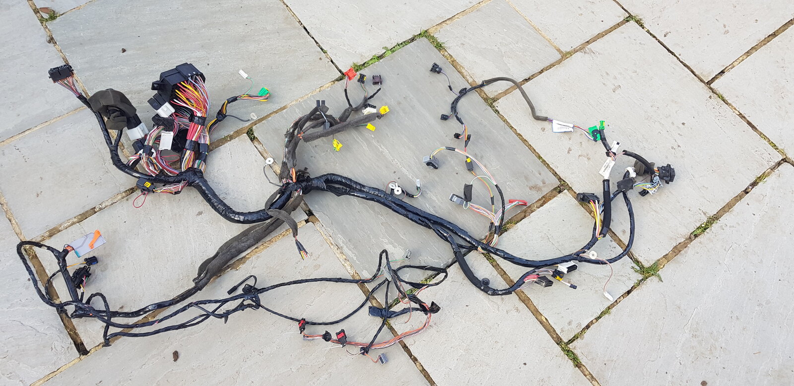

I have the complete interior loom from the 182FF I broke recently. I will dig it out tomorrow, it should have all the bits you need on it. Will get some pics for you @plenty

Hi mate. Had a look this evening. The plug for the sensor does not appear to be part of that front loom. All I remember running down the A-pillars is the alarm sensor wiring.

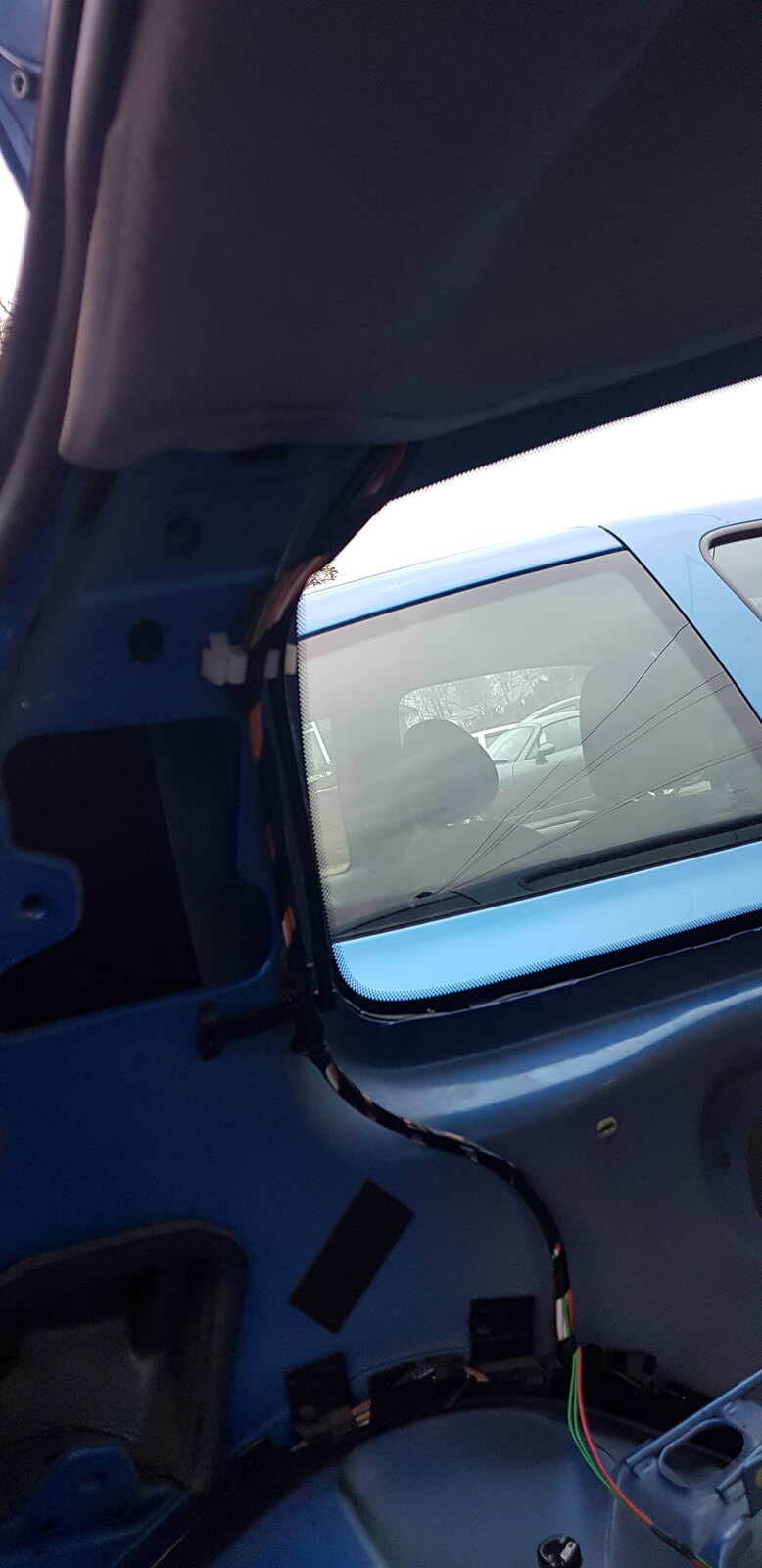

Had a look in the track car. Not sure if the wiring for the climate sensor runs up the rear pillar and across the roof? In which case it would be part of the wiring that plugs into the big white plug near the bonnet pull.
