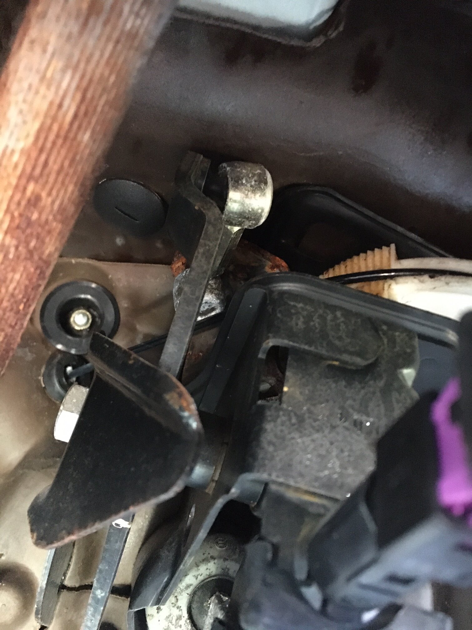

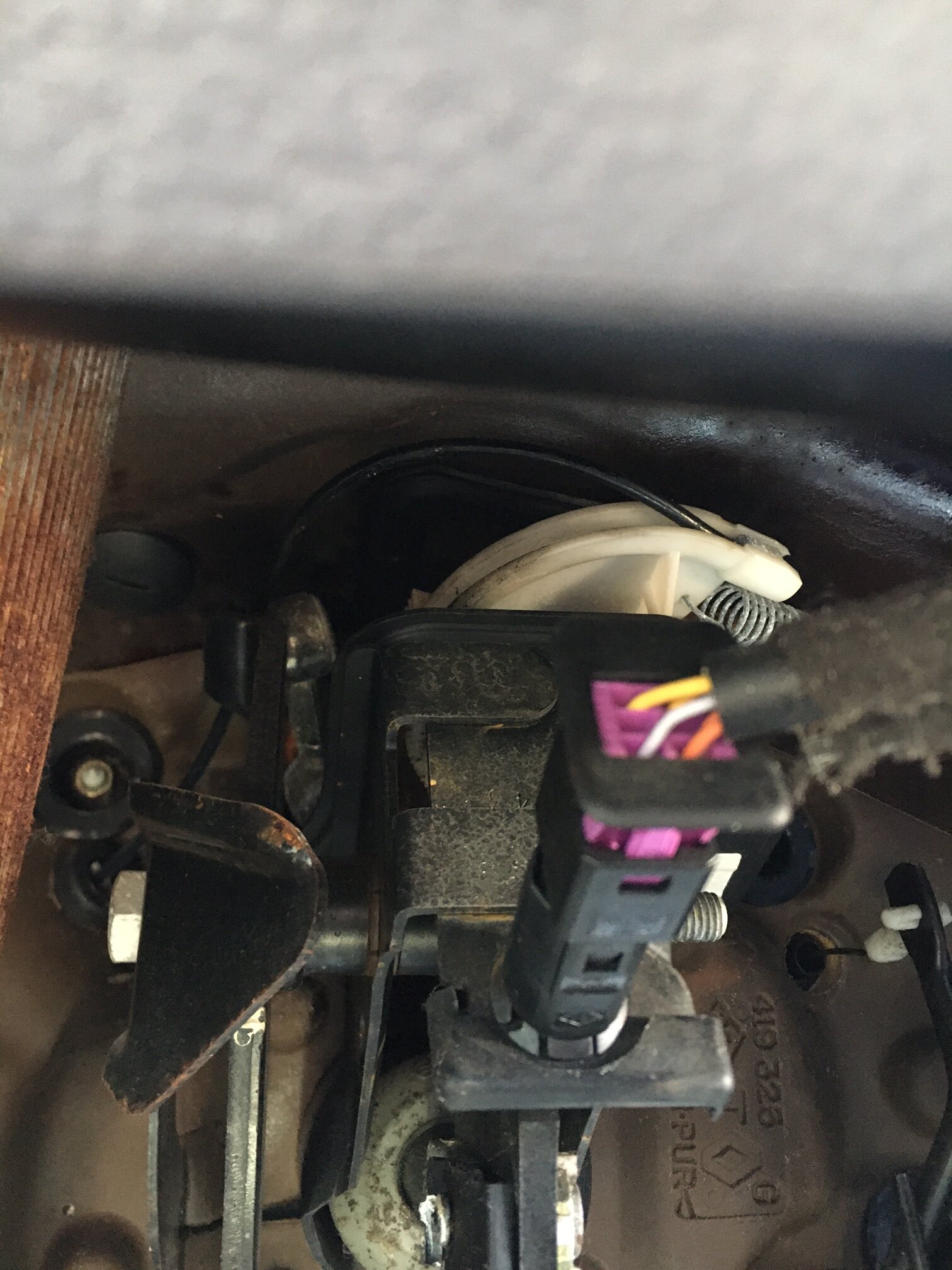

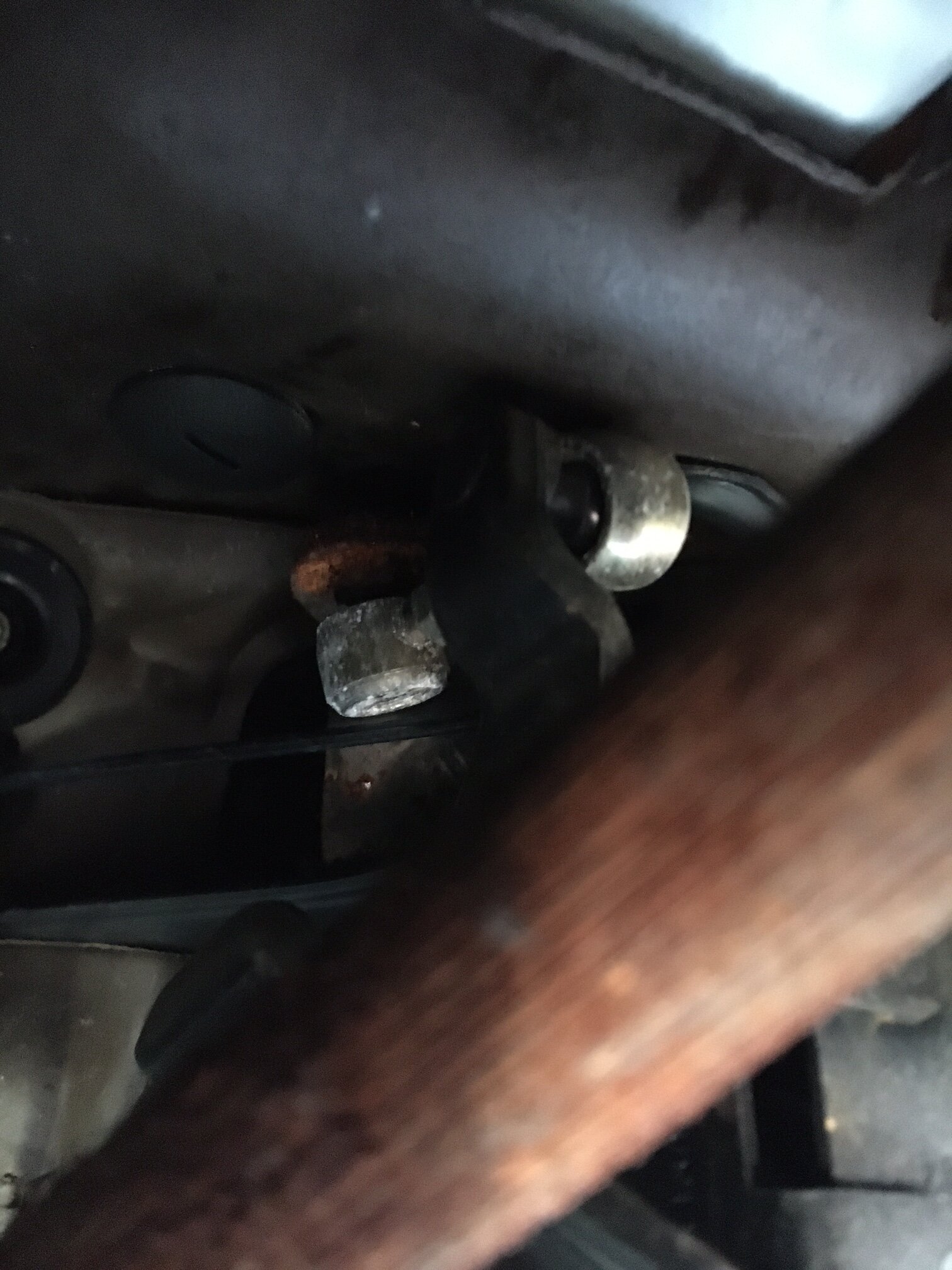

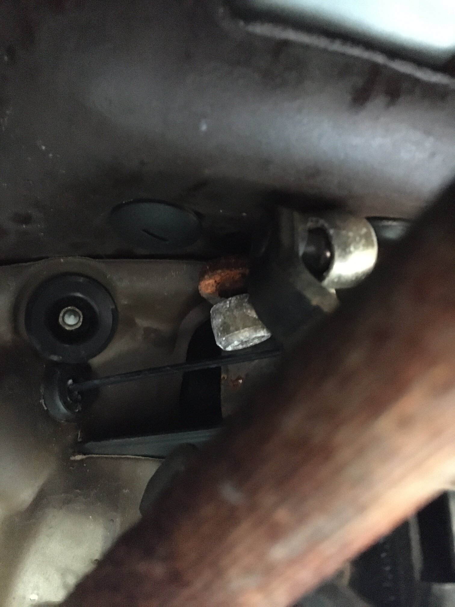

the cable is off the fork, when i try and "pump" the pedal, it just stays down, it doesn't return up
  (W) Clio RSI 1.6 16v
see pics below of pedal adjuster and ball

From those pics it looks like it should be working
With the cable attached at both ends what happens when you pull the ratchet adjuster out?

ok ive fixed it.
after looking at this thread elsewhere:
seems where i had water in the cabin from a leak, the moisture has corroded some of the bits around the adjusted and made them stick.
liberally applied WD40 and severe amount of "wiggling" has made it ok. i will need to strip it out and clean or replace though in the near future.
