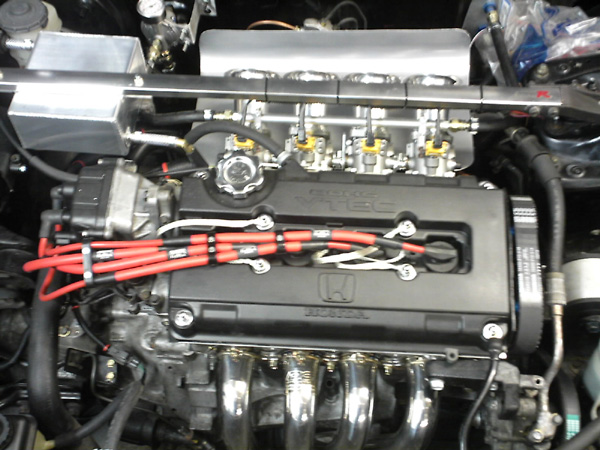

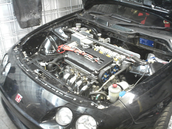

I recently built this for porkie off here for example:

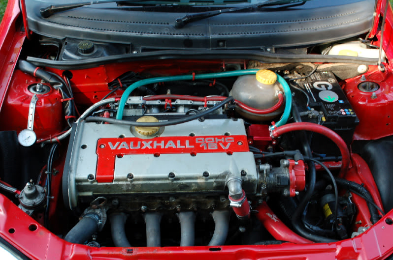

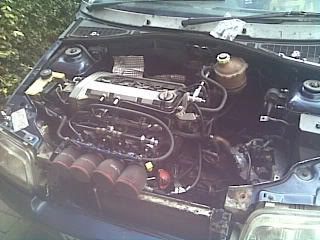

This is one of my own previous personal cars:
As is this:
As is this:
Ive had loads to do with mapping or building all sorts of other ITB cars as well, and even to this day I still love ITBs for certain applications, I just dont think on a lightly modified road going F4R car they are the ideal choice in most situations so I dont join in with a lot of people on CS who think they are the b-all and end-all.
