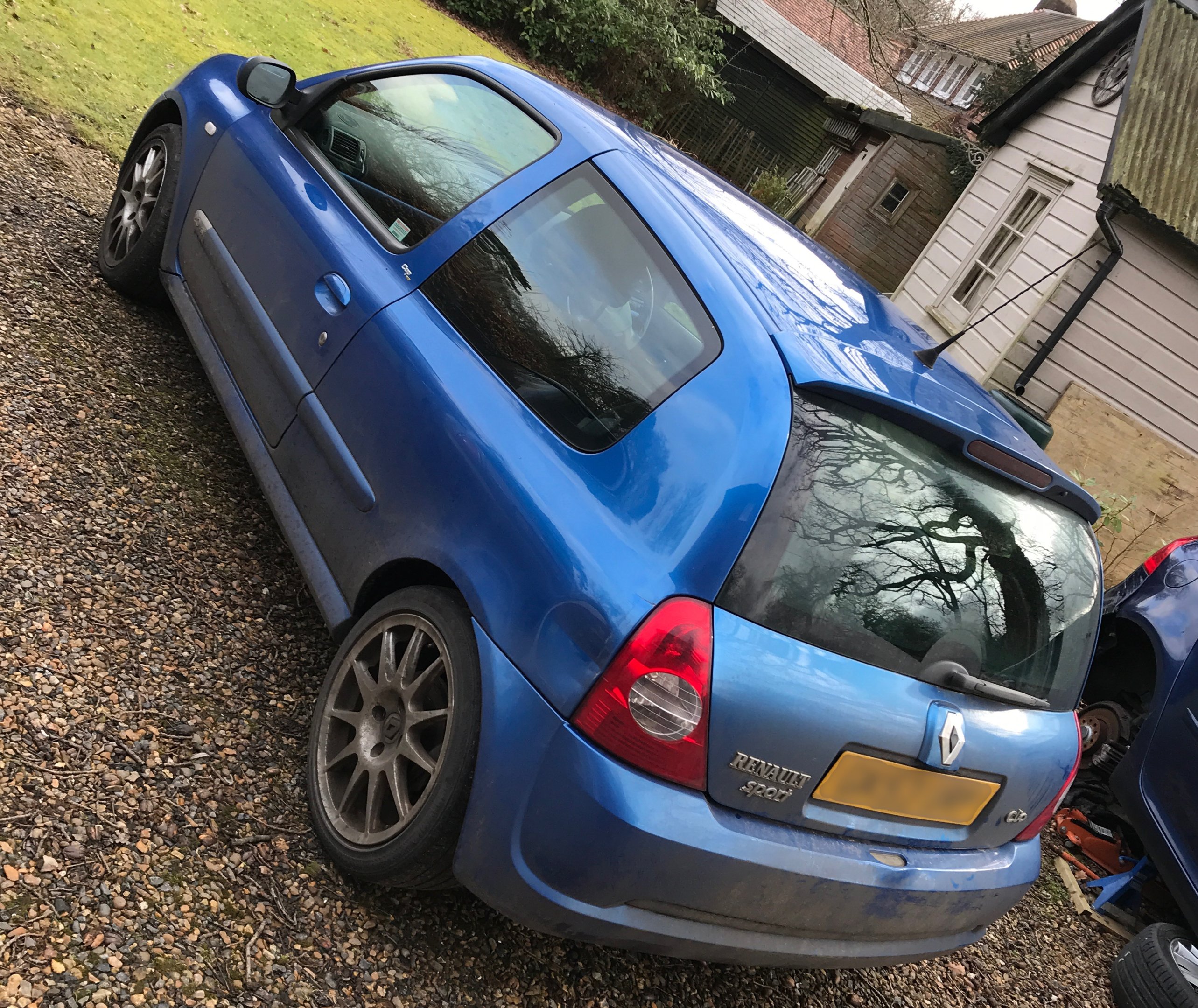

I had myself a Clio 1.2 16v for my first car at 17 and always wished it was a Clio 172 Cup.. 13 years later I am now an owner! I got offered this from a family friend at a price I couldn't refuse.
Planning to fix it up to make it look factory fresh again and have some fun with it. Car is a 1 owner from new and has climate control... which I wonder if that was rare as all the ones I've seen don't have it!? I've had it about 6 months but its been in storage so decided to make a start on it this week.
Here's the day I bought it, looking a bit sorry for itself! The wheels are off for a refurb as we speak, new tyres and brakes ready to be fitted also!
Anything I should look out for, known issues, or good things to replace!?

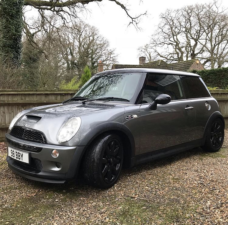

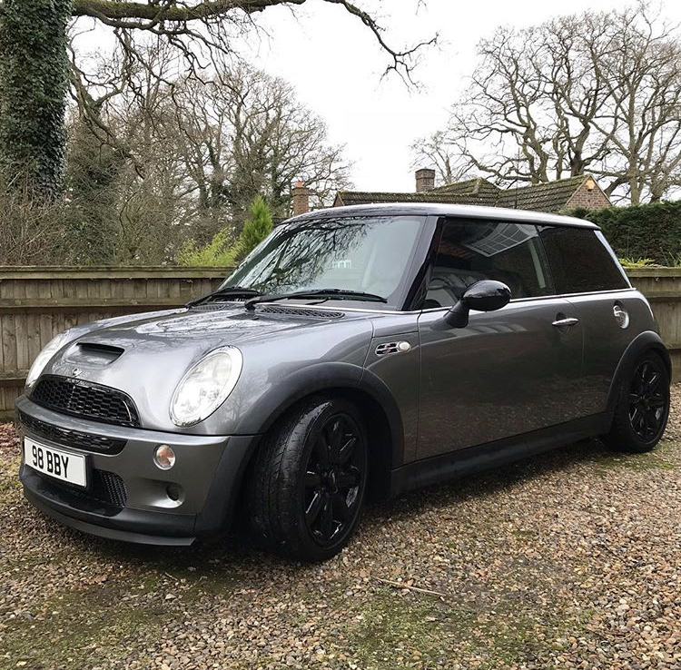

Ahh nice I absolutely love my mini its like a go kart. Sure looks like your cars got all the right mods.. looks awesome! Ill have to have a good read through the thread going to give me some points I'm sure.. like the look of that coil pack!
Thats good to know Mini and Clio chat all in one place.. perfect!! I did have a look at the Mini2 forum but just too much going on to keep up with so gave up! Started myself an instagram as a kinda build thread but at the moment I have a lot of stuff in boxes and not on the car yet. (@98bby_r53)
So far I have ready to fit:
  • 550cc injectors
  • NGK spark plugs
  • Newman cam
  • JCW R56 4-pot Brembo calipers
  • 316mm Brembo discs
  • Pro-line braided brake lines
  • Wiper delete
  • Airtec intercooler
  • Kavs 17% pulley
  • JCW diff (but worried its not going to be good enough and ill need a quaife, what do you reckon?)
Currently fitted
  • Scorpion cat back
  • Kavs 15% pulley
  • Some lowering springs (Cant remember what they are lol)
  • RAM air intake
  • Teflon coated supercharger
  • Polybushed front/rear
Still lots more bits to buy and lots more planned for it.. But here it is:

The best colour i see![emoji1303]
nice list of mods you got there, will make a cracking car, mines currently on springs, eibach proline, tbf there not bad. much better than everyone makes out on minitorque!
my car came with the quaife so couldn't tell how much better it is, but im sure i @Sir_Dave commented in his thread about how much better it was over stock lsd.

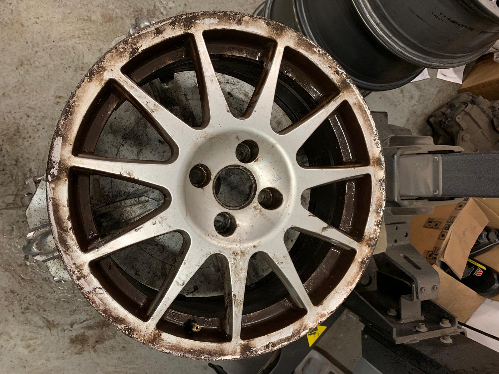

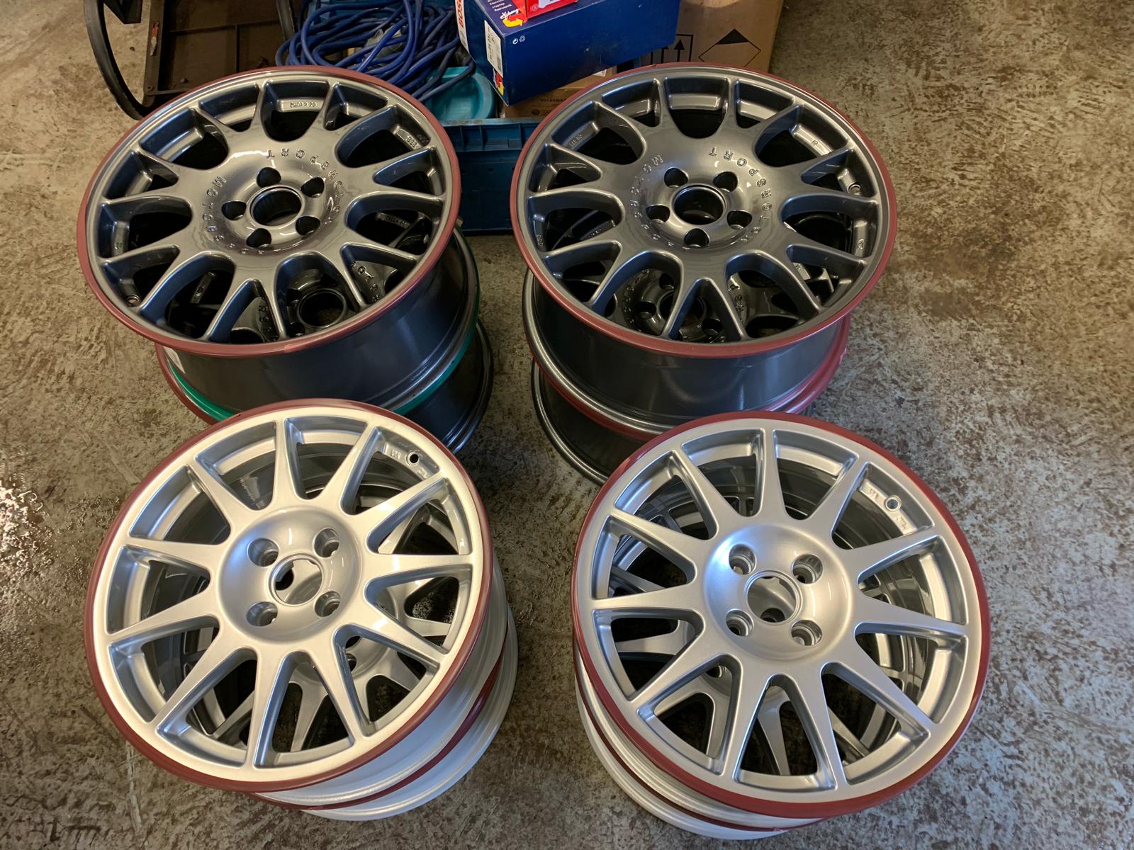

Well here's a little bit of progress so far ?..
From this...
To this!
Will have the tyres on them this week and I'll hopefully get a change to fit the new discs and pads next weekend.. then it'll be ready for the MOT ?

I'd agree grey is the best colour! Thanks it all seems to be coming together nicely, getting it ready for the track punishment its going to get next year! haha. I'd like to get some coilovers at some point but can't really fault the springs to be fair. Cool ill have a good read through those threads cheers ?

Looks a nice example.
These cars generally don’t rust, not where you can see anyway!
So they always look really nice. It’s only when you get under the skin that the amount of work needed becomes apparent.
This was the case with all the one l looked at.

Thanks ?. Where did you find rust hiding on the ones you looked at? Had been told about taking the rear door cards out, any where else?
This car was kept on a very sloped drive way for its life before I bought it, so I'm hoping that might have helped it over the years but who knows.. going to be taking trim/bumpers off to check all is looking as it should.
  Land Rover
The Clio resists rust well. You can take off the rear trim panels to look inside the rear panels. You’ll need a mirror, or take a picture with your phone, to see down to the bottom.
Spray the area with a rustproofing agent, l would recommend spray grease.
Also take out the rear lights and you can then spray inside the rear wheel arches all the way round.
On the 172 it may also be worth removing the side sill skirts to check the sills, you’ll need to drill out the rivets and then put new ones in when you refit them.
On my 182 this was all fine, but they can rust, after all any 172 is over 15 years old.
