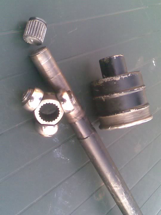

The boot that's leaking on yours is by far the easiest one to change, just remove the shaft, cut off the old boot, slide the cup off then as long as you've bought a stretchy rubber boot instead of a plastic one, you can stretch the boot over the tripod bearings, pop some fresh cv grease into the cup then slide it all back together & fit the new clips
Ignore the snapped bit, but that end of the shaft comes apart like this and worst case scenario if you can't stretch the new boot over the tripod bearing is that you'll have to remove it by taking off the circlip and use a puller or tap it off with a punch & hammer.
If you do end up taking the tripod bearing off, just wrap it up in sticky tape to stop the needle rollers inside from falling out
