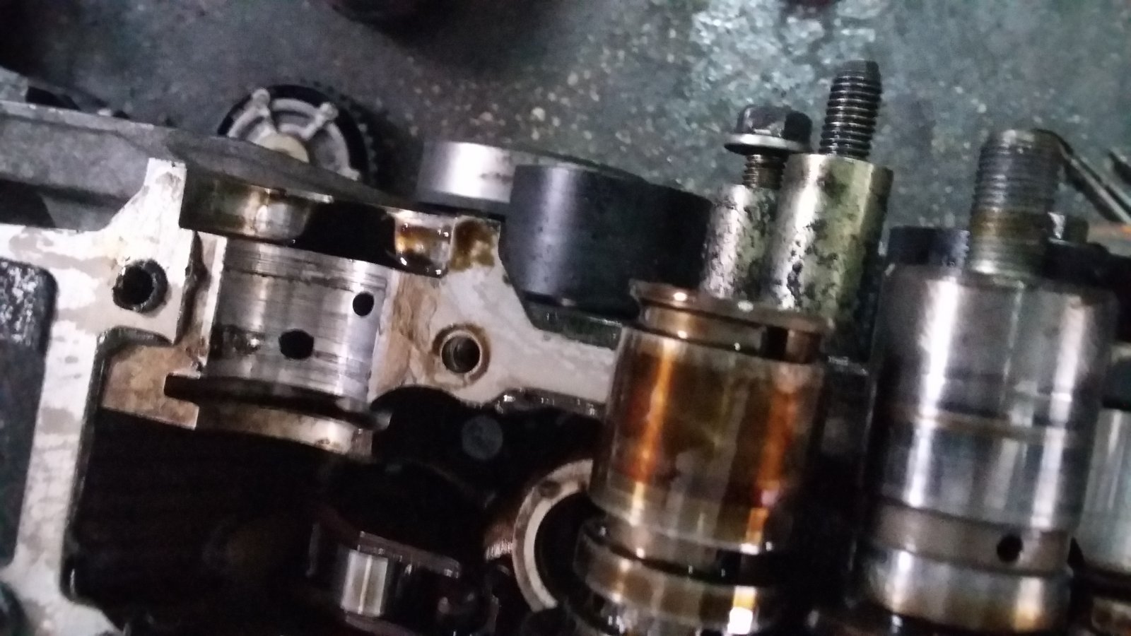

and engine start began making noise

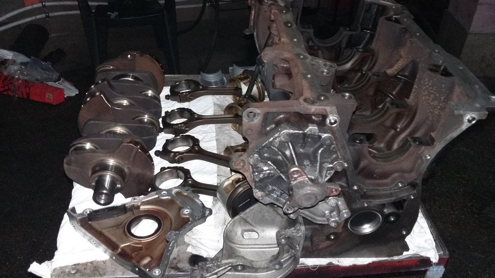

i took off the oil pan and connection rod bearing on piston 3 gone.crankshaft gone.connection road gone

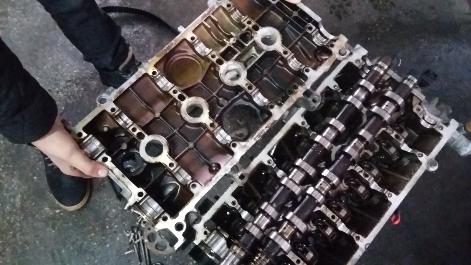

i took off the cylinder head and ......gone too
when i change the timing i change the dephaser seal,because was leaking oil.after 100 miles it start leaking again.beacause the cylinder head was damage the seal cood not stop the oil in excess.
bad luck.i got a clio with a bad engine.

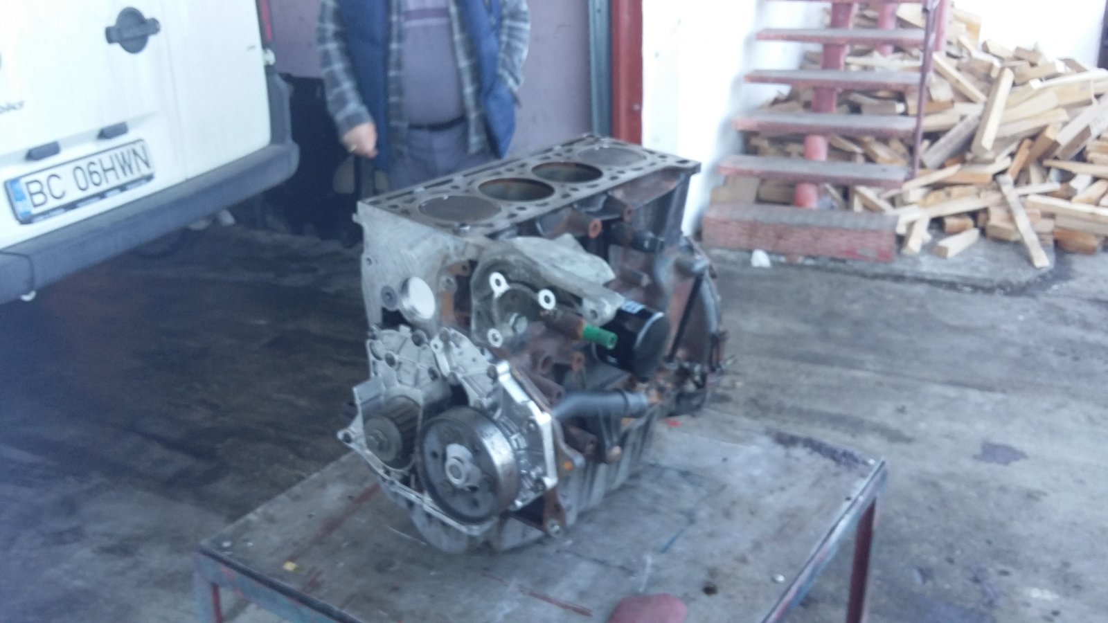

start looking after another engine ...found one in essex,300
arrange transport to roumania another 100

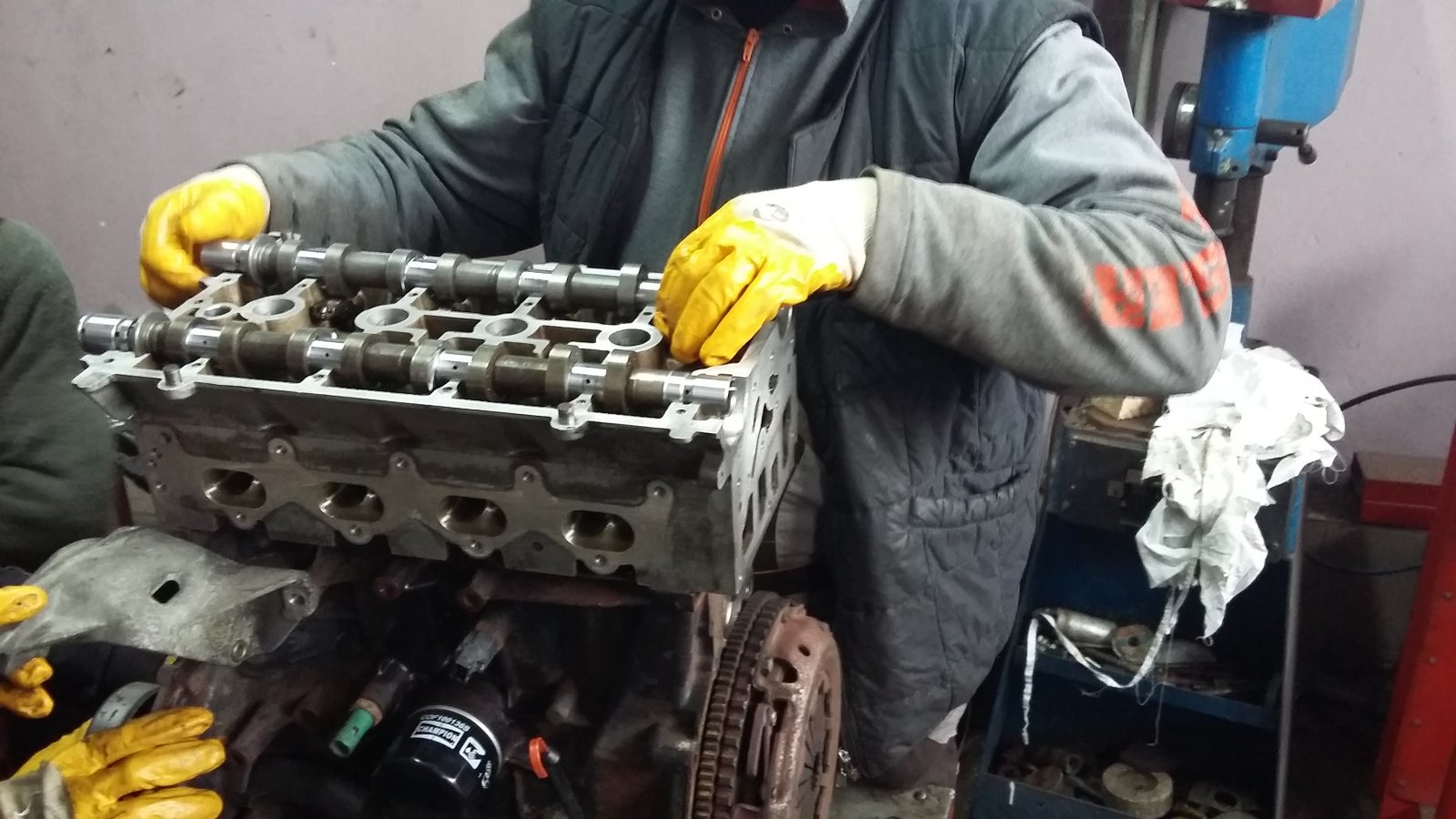

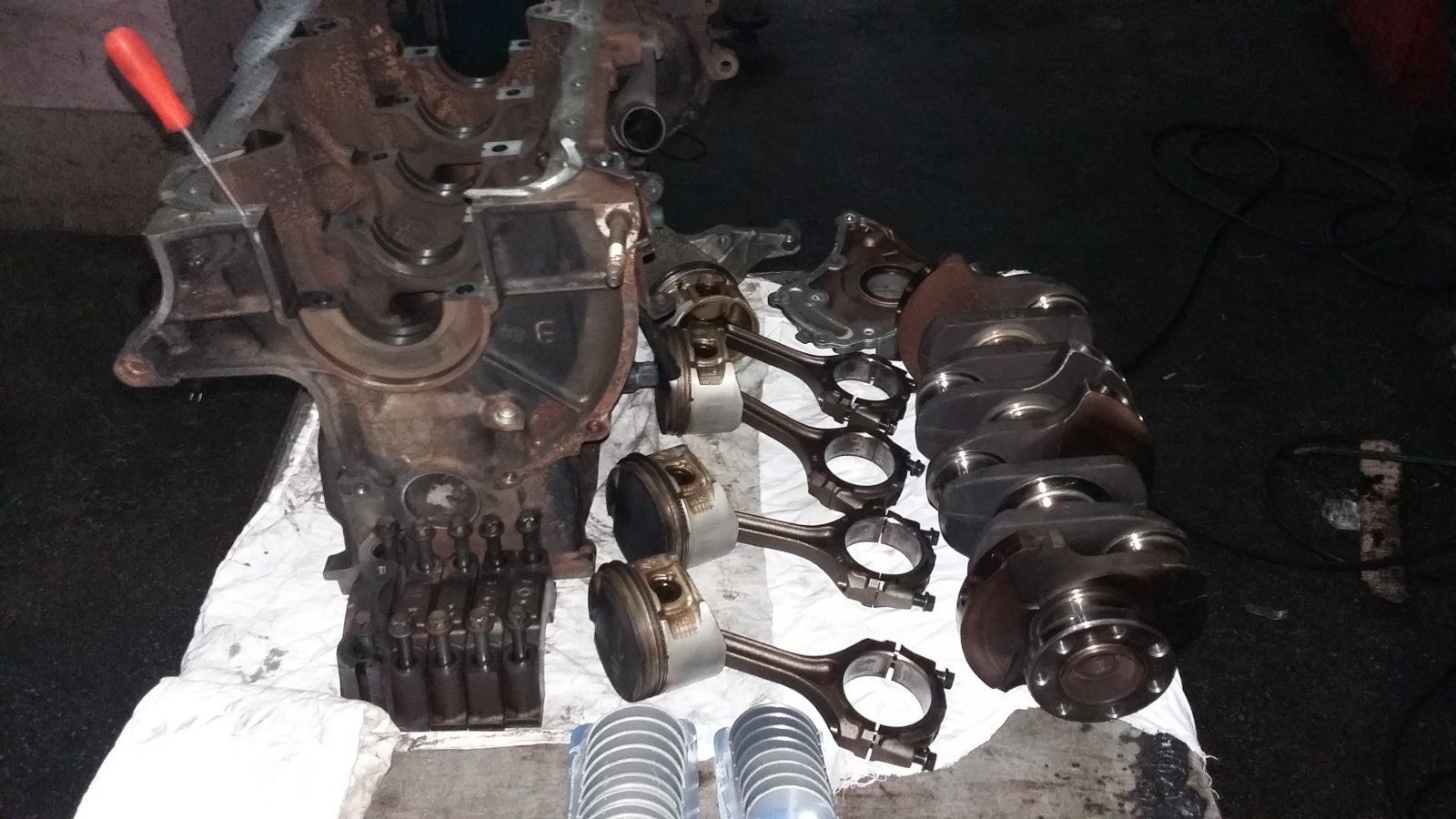

engine arrived and i took off the oil filter and put it on a piece of paper and check the oil ......i found metal filings:rage:
i open no 2 engine cylinder head was in the same condition like no 1 but crankshaft connection rod piston was ok.
i will replace crankshaft bearing and shoud be ok.i send the cylinder head to a specialist who
thinks can repair

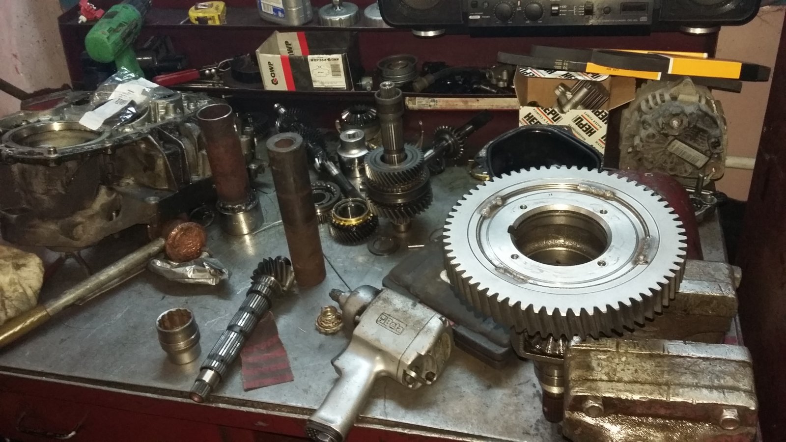

is possibil to rebuild it
meanwhile my car is so

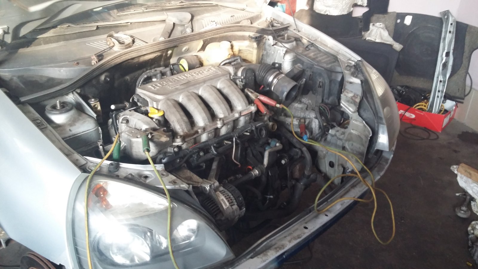

after 5-600 miles engine look fine.but i want to prepare another one.
