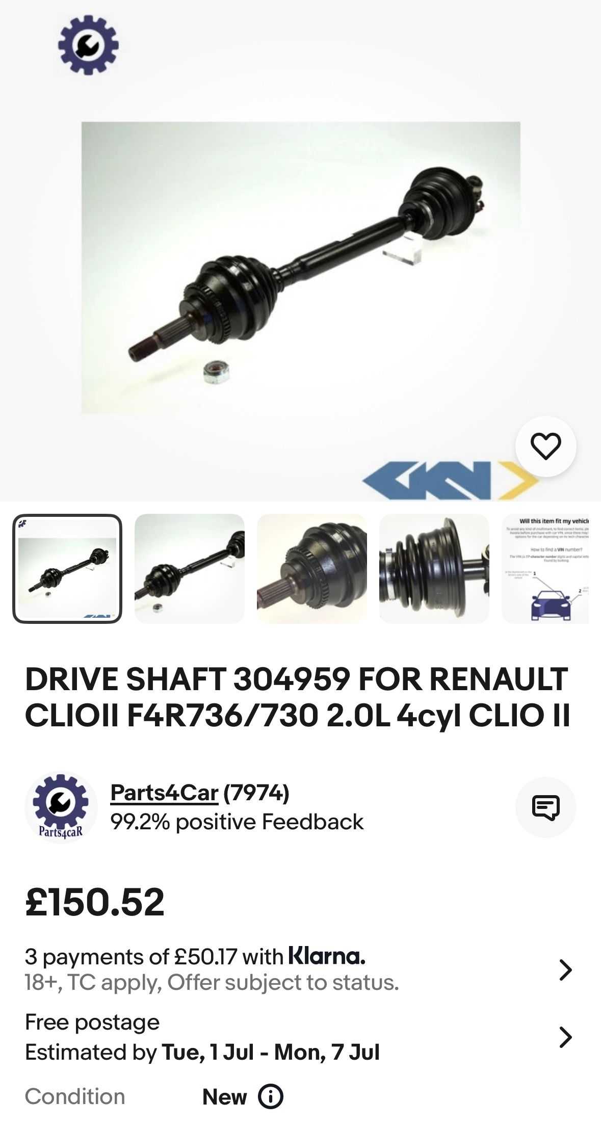

My garage thought possible driveshaft issues as the wheel bearing seemed ok - new driveshafts and it’s still doing it.
