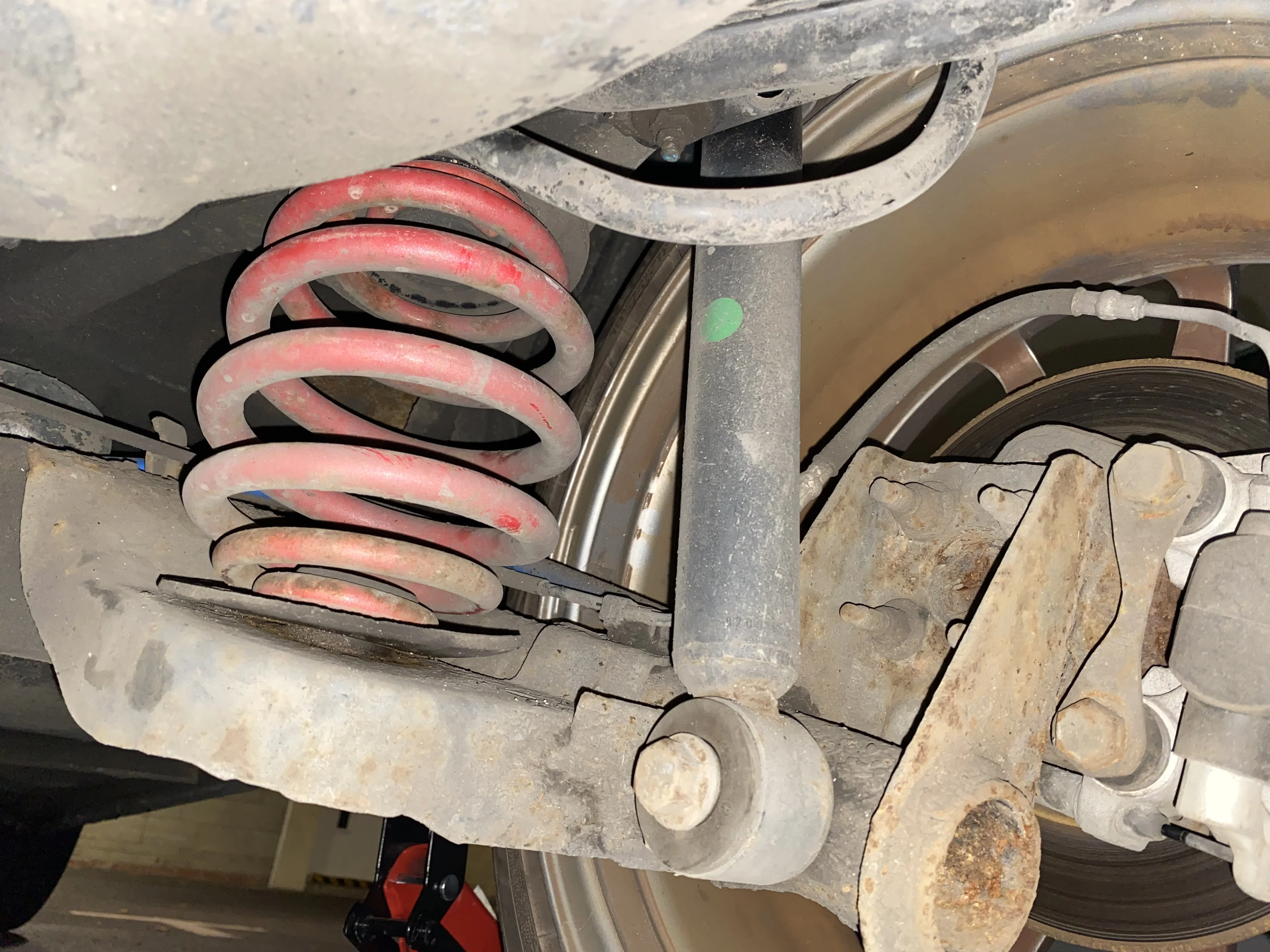

I think what we’re looking at here is pretty damning. I’m suspecting that both rear shockers need replacing.

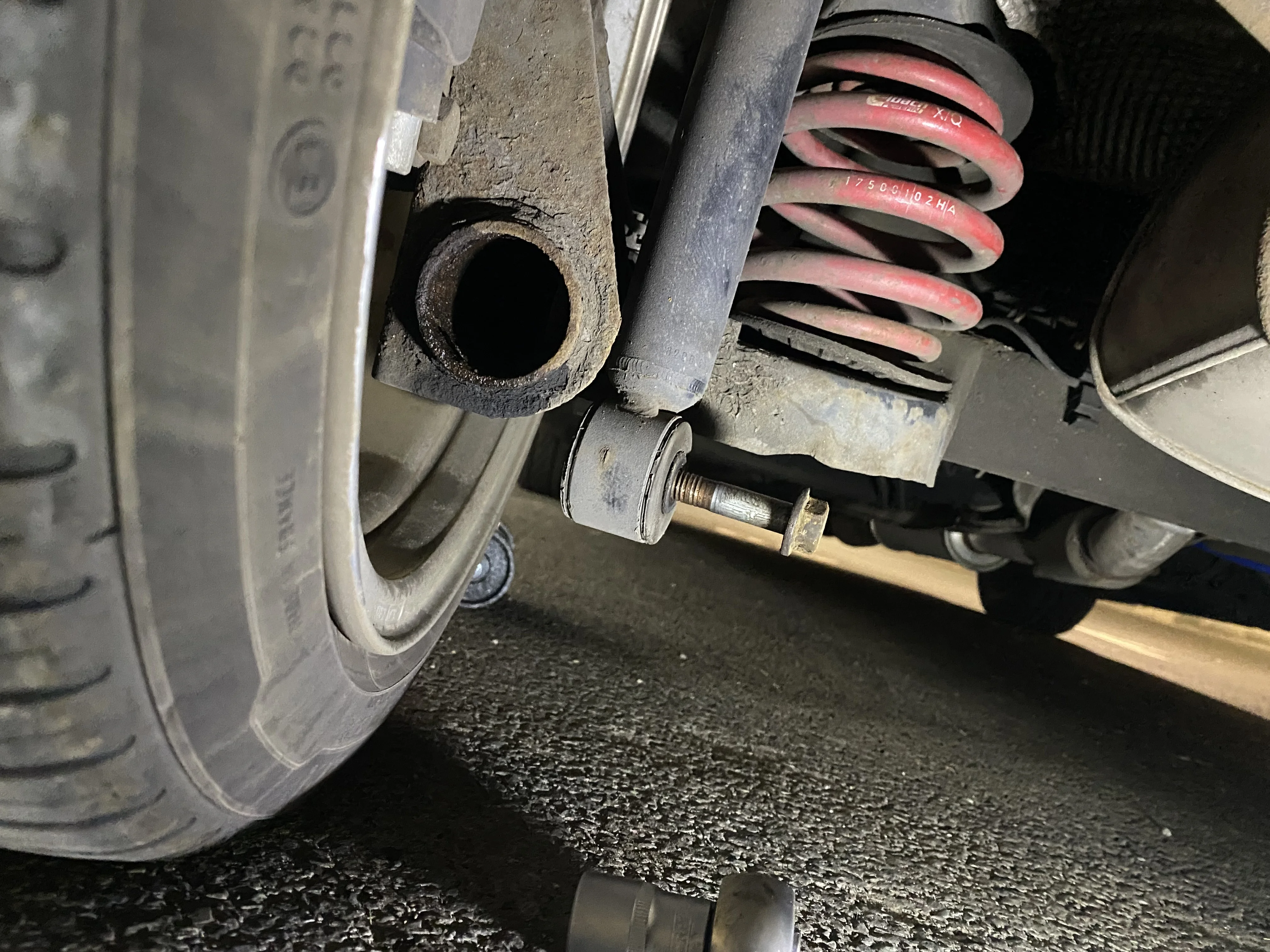

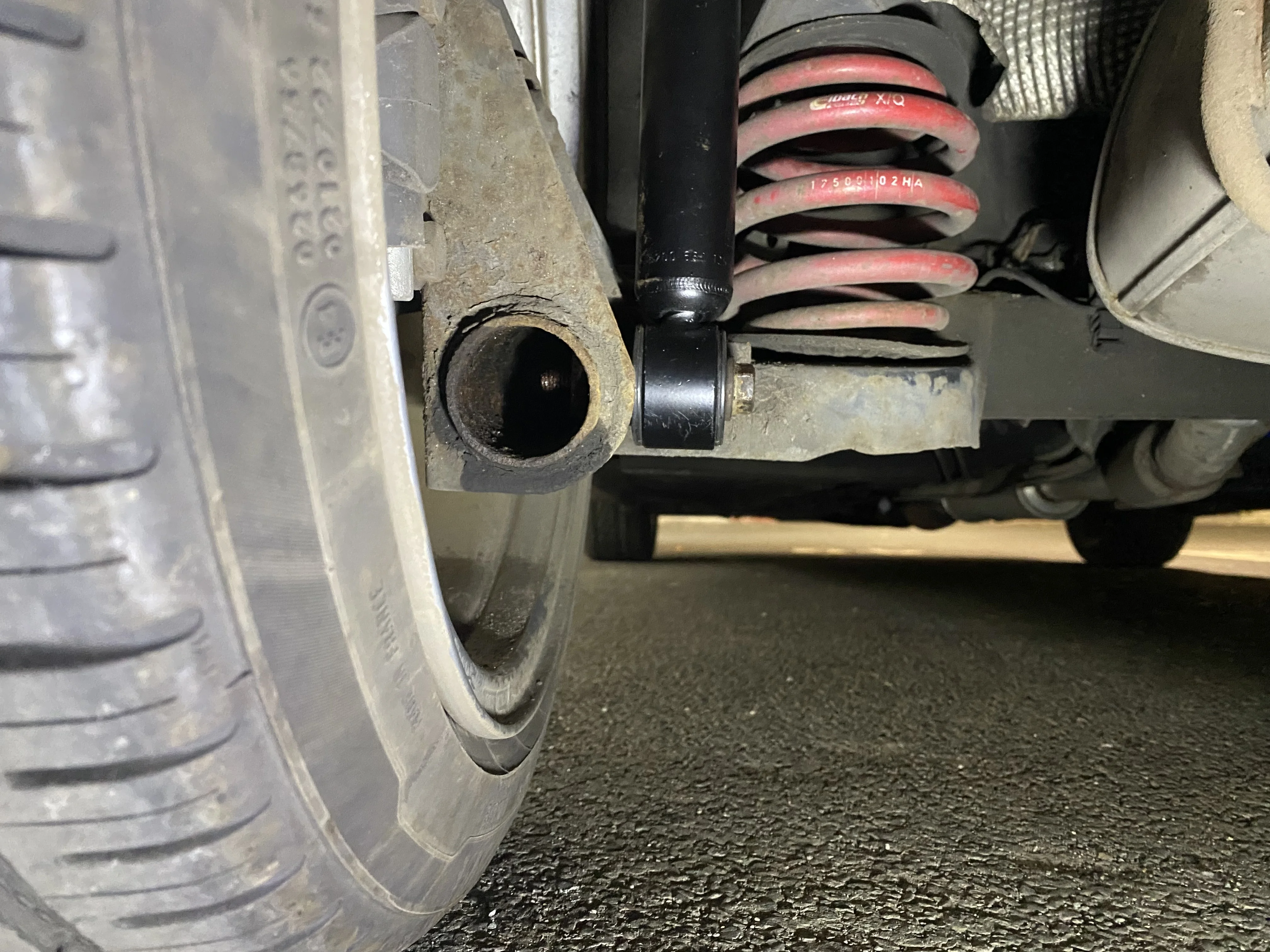

So, off with the old one and on with the new. The old one came off very easy because it was only fitted just over two years ago. No issues there whatsoever. I read that the new shock should be pumped a few times to prime it and once I had done this the overall length had obviously increased. I compared the resistance to the shock that I took off and to be honest, there was very little difference. The old shock did have oil around the top and some of that was like a missing of oil.
I put the new shock through the top mount area and loosely tightened the top nut. When I looked under the car the hole for where the bolt goes through was obviously not in line with the hole on the car. I used my trolley jack to gently pump up the shock so that I could put the bolt in and tighten it with my fingers. I then tightened the top using a spanner and a pair of mole grips to hold the top of the strut. There was no issues with this whatsoever and it matches the other side exactly. I then tightened up the lower 18 mm bolt and used some copper grease on the thread. I couldn’t really get into a good position to tighten it, but eventually I got it so I was putting a lot of force on my ratchet and there was absolutely no more movement to be had. When I was removing this bolt, I had to put my foot on the ratchet to loosen it a little but then it came undone easily. I’m going to check the tightness of this bolt over the next few hundred miles and when it goes in for service, I’ll ask the lads to Birchdown to torque it up correctly.

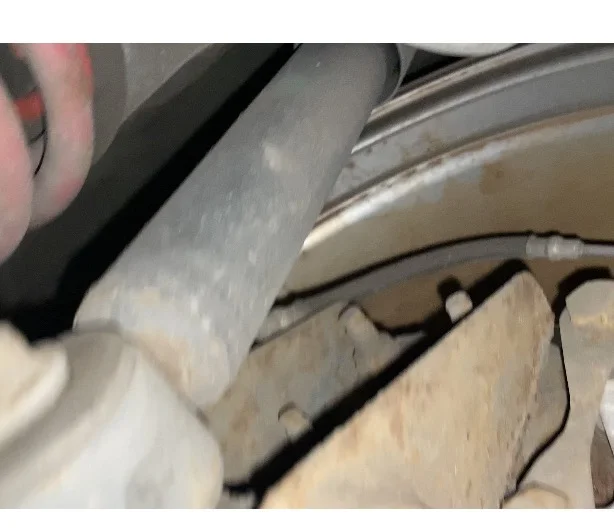

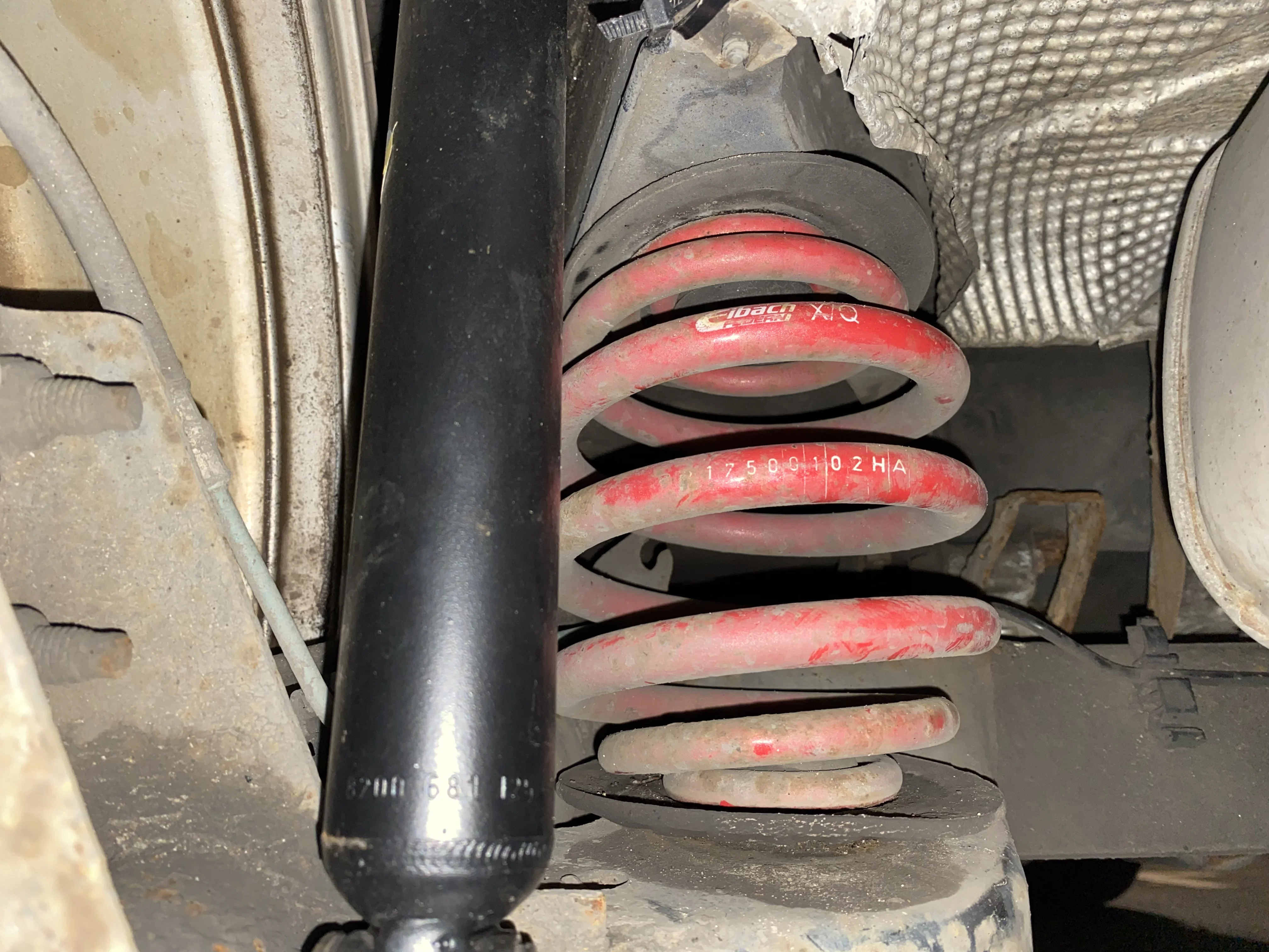

So I’ve just taken the car for a spin and I can’t say that I can hear the crashing noise anymore. I also had a look at the offside damper and oddly I can’t seem to see any of the oil marks that were present the other day. You can see on the video that the rest of the car was dry underneath so I’m sure it wasn’t any water that had run down. I’m tempted now to not replace the offside dumper and see how things go, but I’m still curious about why the nearside damper seem to have the same resistance as the new one. I’ve included a photo of the offside damper and you can compare it to the video that I took the other day.
I’ve had a good look at the springs as well and I can’t see any damage or cracking on any of those. I double checked that the tailgate is secure and tight when it’s closed and I’ve also made sure that there is nothing else in the boot of the car. However, I did notice that when I thumped down on the inside of the boot with my fist above the exhaust, there was a slight sound. I know that the heat shield above the exhaust back box needs replacing so what I’ve done is resecured that with some cable ties for the moment, obviously an MOT failure when it’s up for it. So effectively I eliminated anything that can rattle around or knock at the back of the car. I’ve pushed and pulled on the exhaust and there’s no noise at all and all the hangers are in perfect condition. I’m just going to let this one play now and see how it goes, but I would like opinions on whether I should just change that offside damper because I’ve done the nearside one.

Well, this thumping noise has not gone. I fitted the brand-new damper to the nearside a few days ago and everything is correct and secure. I’ve ordered a new damper for the offside and that should be with me by the end of the week. There is absolutely nothing loose at the back of the car that I can see. I’ve even used some bubble wrap around the Jack that sits in the plastic tray in the wheel well and all of that is secure. It’s really odd so I’m just hoping that it’s actually the offside damper that has failed in someway, but if it’s not that then I am baffled. I’ve checked the springs to make sure they are okay and I cannot see any damage to those at all. It’s just another day owning a 23 year old Cup!

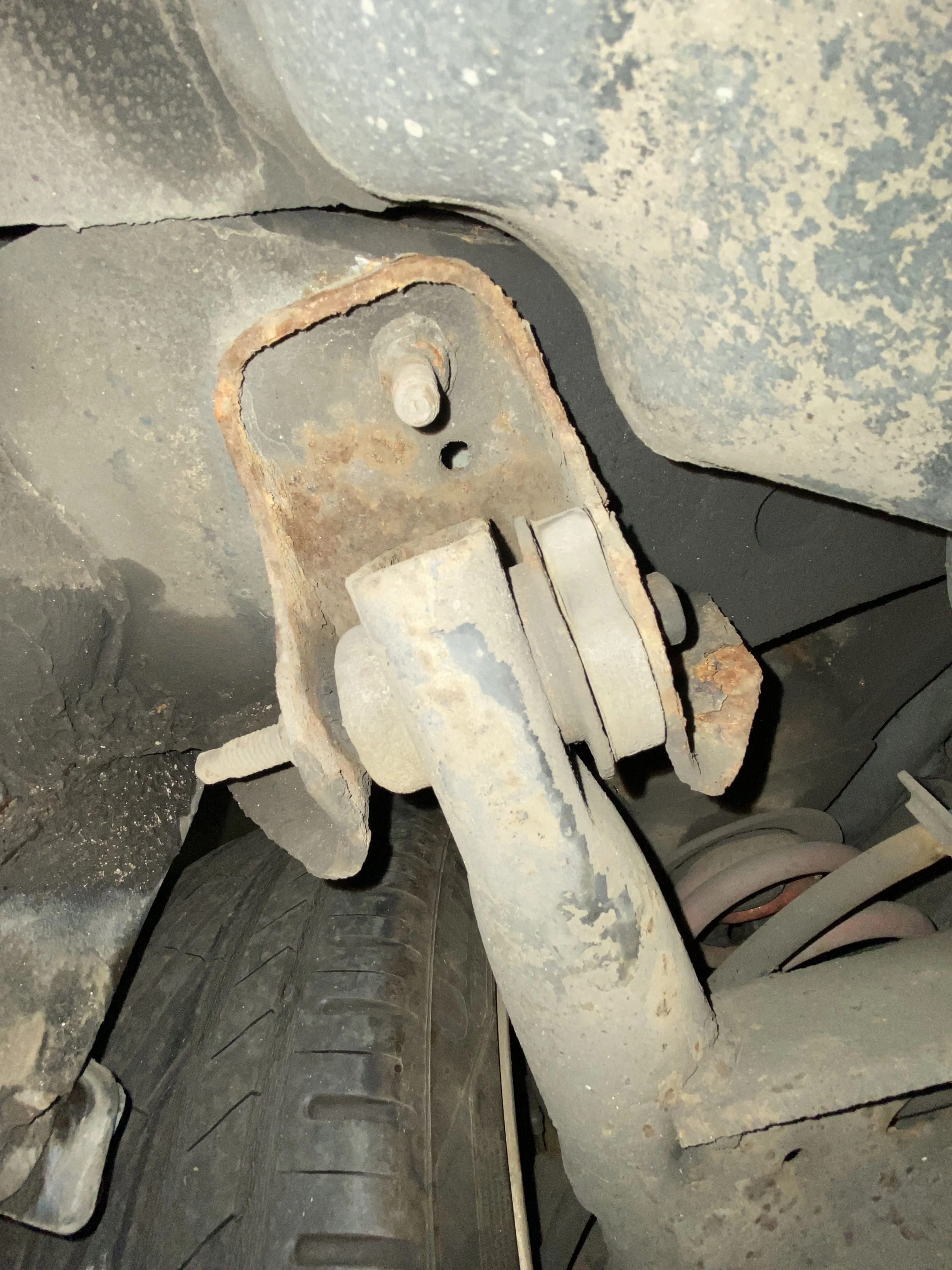

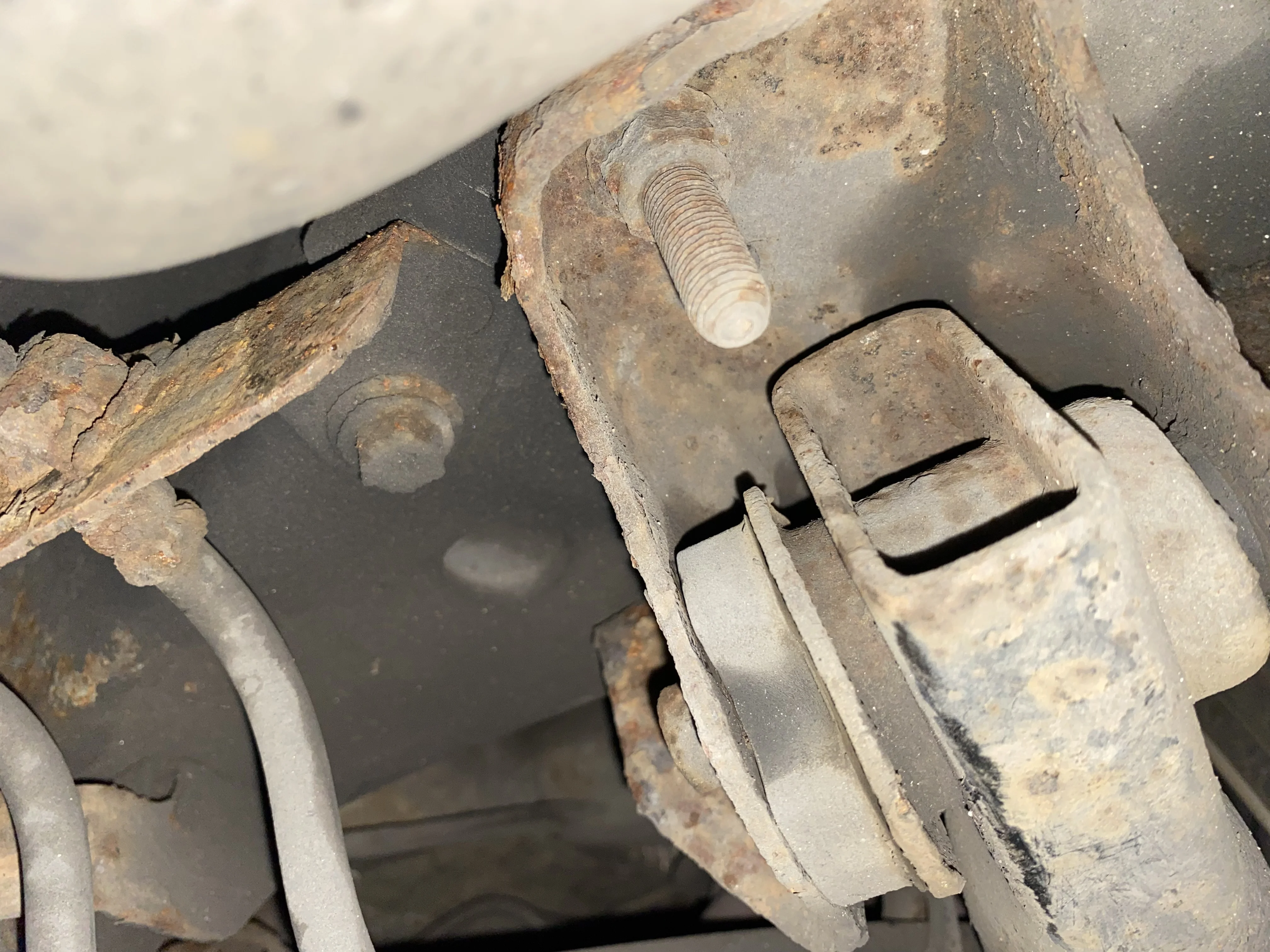

I've took a couple of photos of the underside but everything looks as it should. I'll post them below. I've just climbed in the back of the car and pushed and pulled everything I can get my hands on. The only movement is the back seat where it meets the two striker loops. I marked off the contact points and then wrapped some insulation tape around them. It only takes about two rotations of tape to make it tight. And that's it. There is nothing else to check unless a spring has cracked and it's not visible (i'm thinking of changing the springs anyway but that's another thread).

Regarding the bushes…It all looks okay short of getting a bar in there and rising everything. They’re obviously not brand-new, but they also don’t look as old as a mileage on the car. I don’t know if these go from the inside out so I’ll get a bar on them weekend and just see if I can prise any kind of loose movement.
Just to finish this off, it looks like the noise is from the n/s caliper of which the slider has some excessive play (see my other thread). It seems that it needs to be packed with grease to solve the problem to reduce it's movement, although it should have a little. The other new damper has arrived so i'll fit it later today. No doubt the one that comes off is also ok so I have two spares or two that I can sell.
