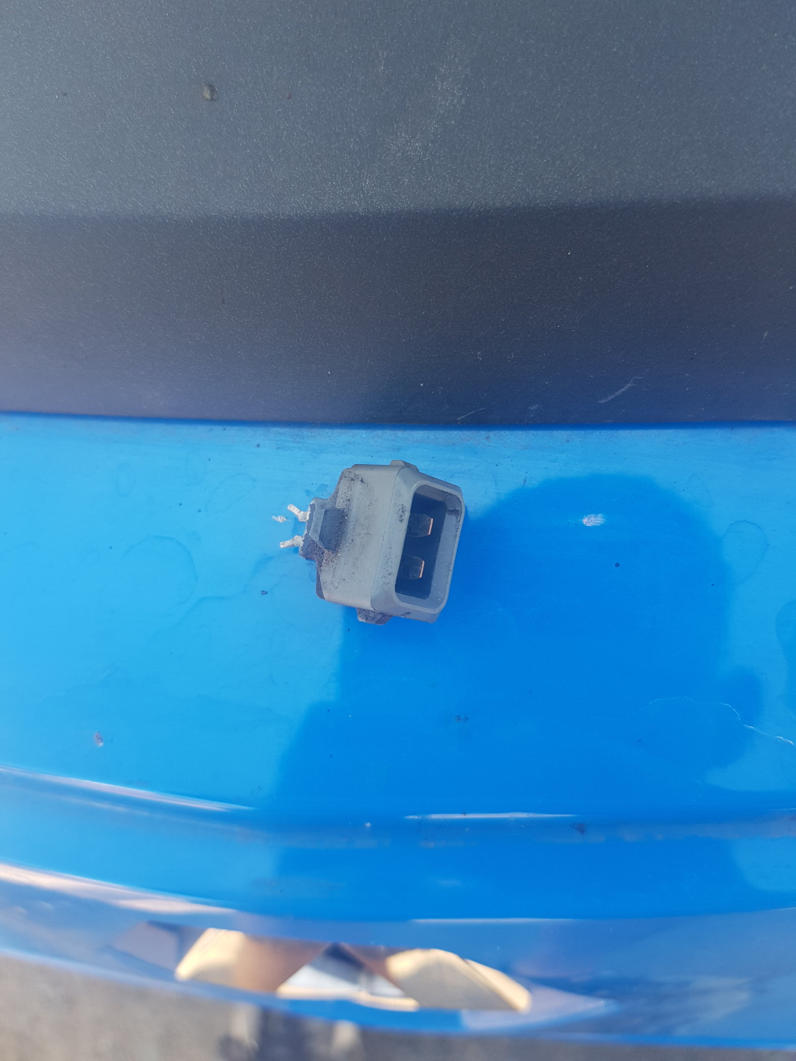

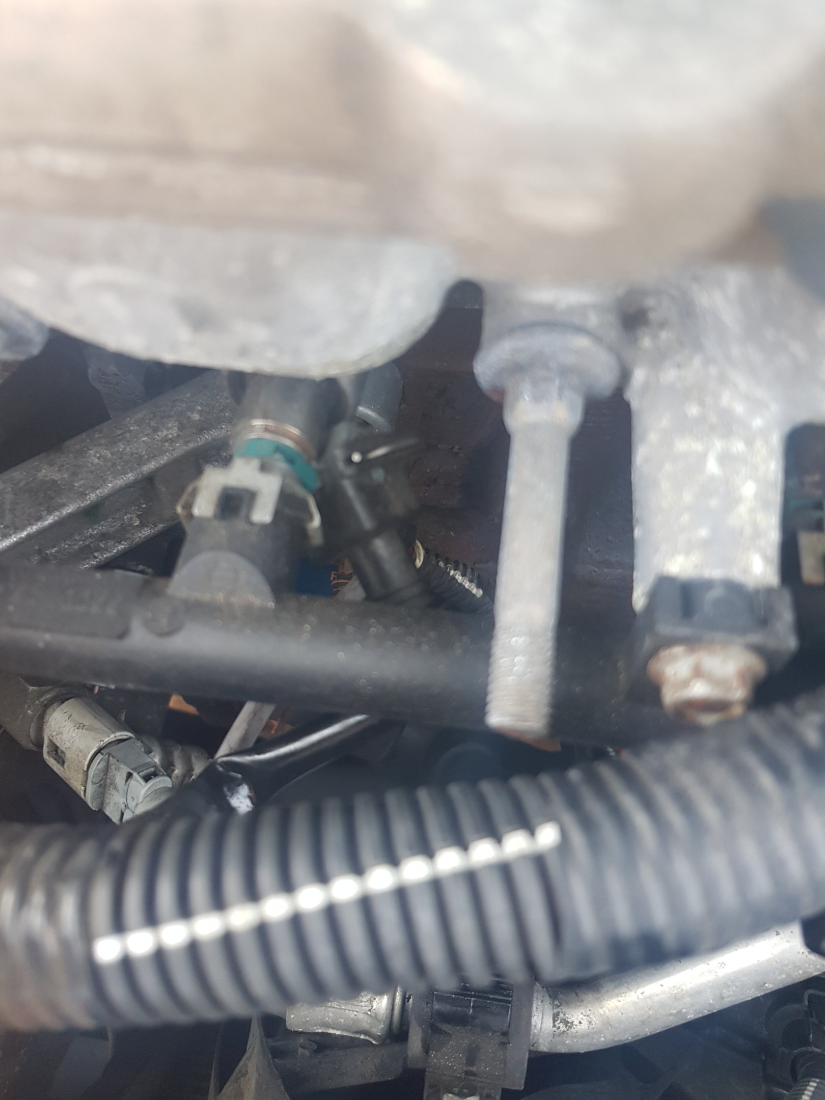

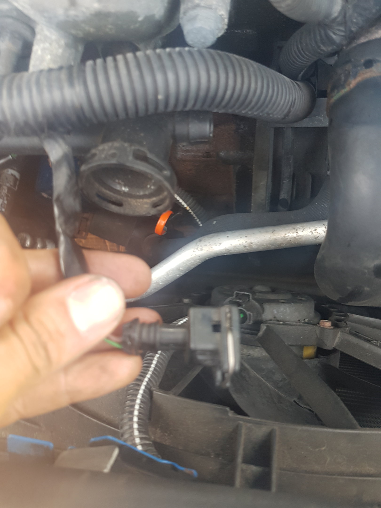

Hi, hope someone can help. I was just doing oil change and the bloke who's had the car before had done the filter super tight.
I used my filter tool to take it off and it was that tight when it loosed off I hit a plug off my inlet. can any one tell me what the part in the photo is that the plug goes into and if I should or shouldn't drive car?

Looks like you’ve broken the plug off the injector itself, new injector required I would say.
Wouldn’t drive the car as it is, as it will only be running on 3 cylinders with that injector not being operable.
I feel you’re pain with respect to troublesome filter removal, they can be a right pain. I ended up having to go pikey on mines and put a screwdriver thro the filter housing to get it off.
Yeah I thought it was injector. Thing is I only noticed after going down the road. Weekend fun!
Do either of you know the correect part number by any chance?
Literally done the exact same thing as me. Have a look for my thread, pretty much turned into a guide on how to change the injector. £60 I think for euros.
