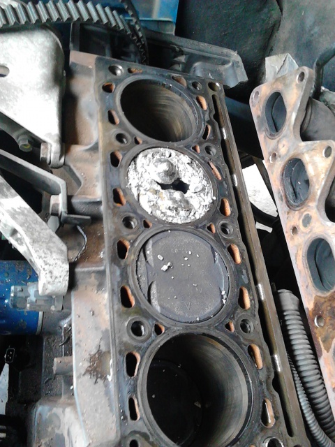

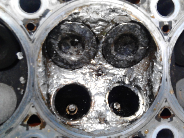

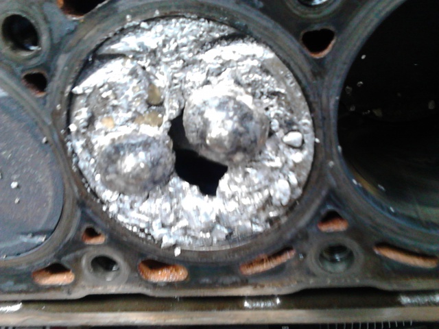

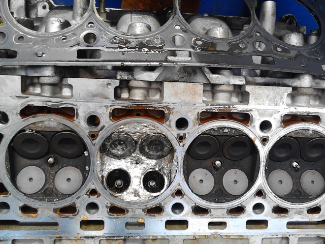

So As the tittle said My engine died last week. It seems that my exhaust valves drops in cylinder #3. That happened at 7000 rpm so that's pretty nasty.

Where I live there is no 182 engine to sell so I have to find a cylinder head ( If someone have a good one to sell please PM me!!) and rebuild the engine.
