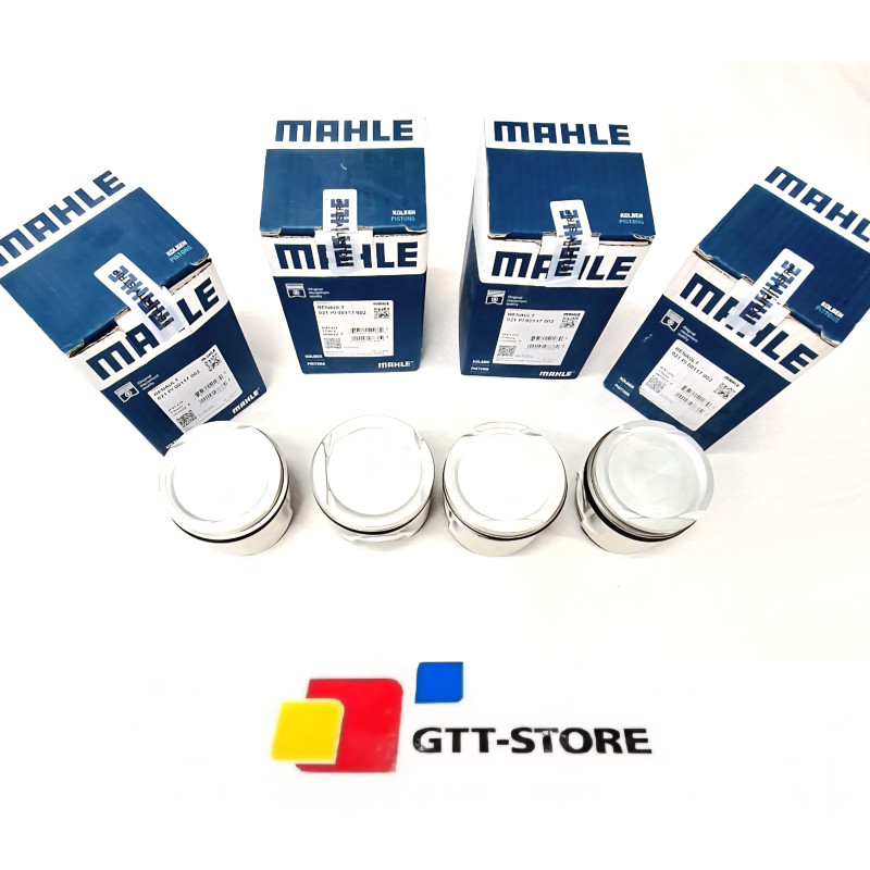

You can get those Mahle O/S pistons on autodoc for £100 each delivered, they're also advertised on eBay for £79 each
The part number is 021 PI 00117 002 for the +0.5mm set.
So you're going to be into it for circa £400 for a set of OEM spec pistons, and depending on where you go, around £250+vat to get four cylinders bored, honed and the deck refaced.
That's a lot of money when you can get a good 172/182 bottom end that just needs a deglaze and set of rings for a couple of hundred quid.
