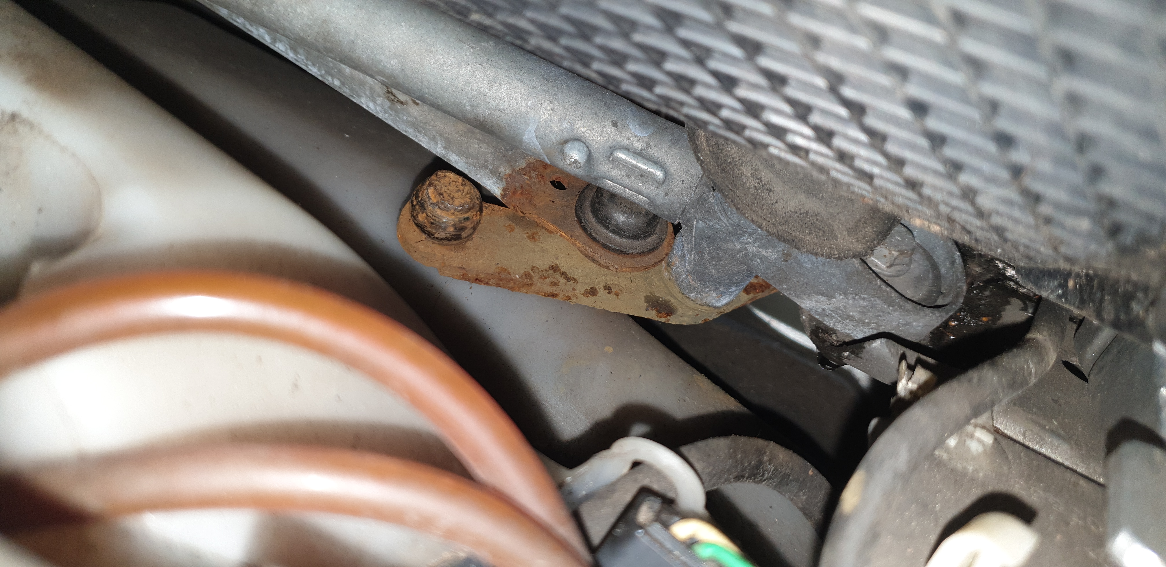

Is there a fix for the front wiper ball joint? Rather than buying a new linkage?
Has that not simply popped off?
Mine did it once when we had a day of extreme cold. Went to de-ice my windscreen the following morning - heard a small clunk and the passenger side wiper blade simply didn't move.
Pretty sure it was that section that you show that had detached itself. Get a bit of grease on there, and press it back on - that should work fine.
