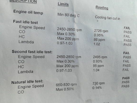

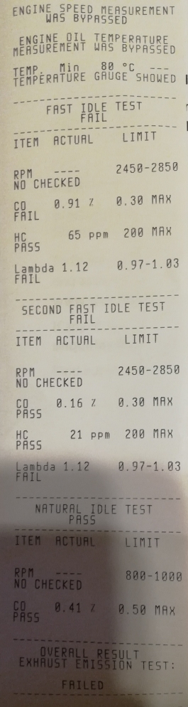

Sorry to dig this up I have only just got the readings to my mot! Everything passed except CO which was high then
Taking the car to another garage to should just be O2 sensors then? Or will the dephaser noise play a part in it?
Also just noticed the lambda failed as well!
Thanks
