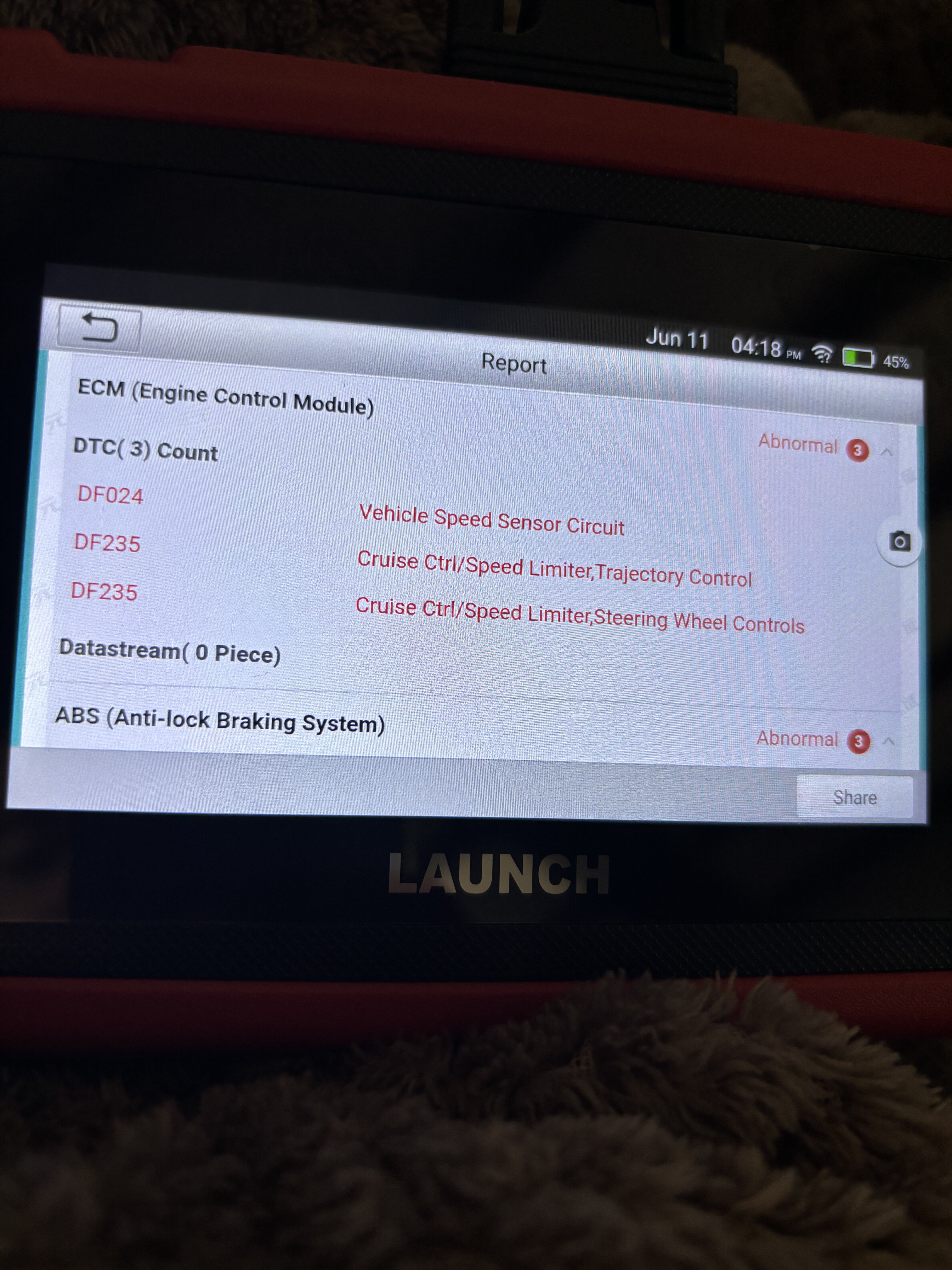

I’ve read that the ‘white plug’ needs attention on these, can cause lots of error codes which my OBD2 has picked up on.
It did have a small leak pre cat so maybe that was a reason it failed.. let’s see I’ll bang on a new fixing kit at the same time .
