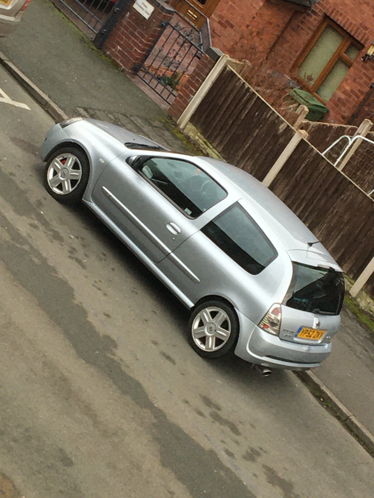

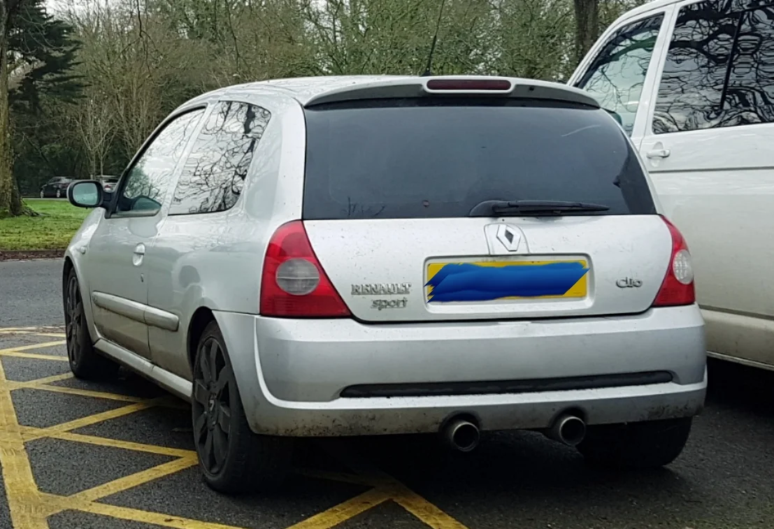

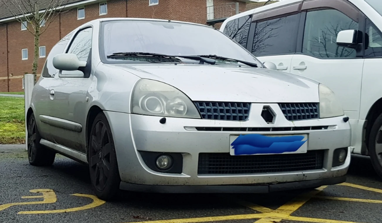

Also whilst I am here.. could somebody help in identifying the model (FF, cup etc) from the pictures? This is my first Clio & I cant find definite answers online. The cars also got cruise control if that helps..

Cruise control and aircon were not fitted to CUP models
Trophys had trophy on the side and only came in limited colours.
Looks like you have a standard 182.
Bonnet seals i know are not specific to the RS models as i ordered a new front bonnet seal for my 172 and it was just a clio bonnet seal
The windscreen seals however usually are model specific however though the model for you would just be renault sport as its 172 and 182 windscreen seals afaik,
door seals shouldnt be model specific other than being CLIO door seals.
If you need part codes etc then browse on here for them or pop on to RENAULT PARTS DIRECT website for the correct part codes and if not purchasing an OEM product it should tell you what part code it replaces.
So to recap
Your clio is a 182 not a cup or a trophy which basically is an FF clio 182 (full fat which means it has electric windows, AC, Cruise Control etc)
Looks like a 182 with at least one of the cup packs, as it has the cup spoiler.
Measuring the front shock bolt spacing (60mm) would confirm if its FF or not.

I would say in my opinion that yours has a cup spoiler pack but not suspension pack so isn’t a full fat. The wheels look to into the arches for the suspension pack to be fitted.
There were 2 cup packs :
1 being the front splitter and cup spoiler.
2 being anthracite wheels and slightly lower ( 3mm ) ,stiffer suspension.
Yours looks to have both going by your pics. Of course the wheels could have been changed so measuring the bolt spacing as said above will tell you for definite.
